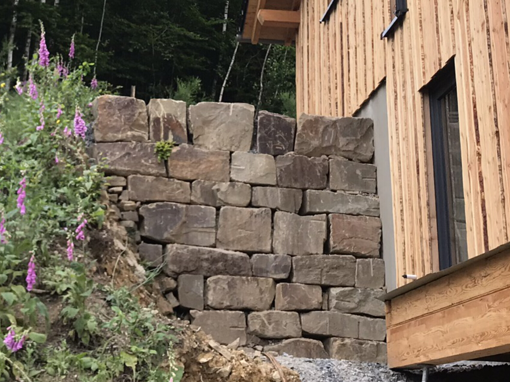

hampshire25 Jun 2019 20:56When building a house, people naturally consider many decisions based on cost—after all, very few have an unlimited budget. The additional cost for a natural stone wall compared to a concrete block wall was about 15% in our case. In our opinion, the natural stone wall is so much more attractive that we preferred to save money elsewhere. However, it involved a different height and a different base. This is one of the two walls. A concrete block wall wouldn’t be half as nice.
hampshire schrieb:
Of course, many decisions in home construction are weighed against costs – not many have an unlimited budget. The extra cost for the L-block wall compared to the natural stone was about 15%. From our point of view, the natural stone wall is so much more attractive that we preferred to save money elsewhere. However, it involved a different height and a different base. This is one of the two. L-blocks wouldn’t have looked half as good.
[ATTACH alt="640FFEB7-6B4F-4FA6-83BF-11E9874EC36D.png"]35710[/ATTACH]L-blocks wouldn’t have suited your project either! 15% is nothing for a piece like that.Similar topics
