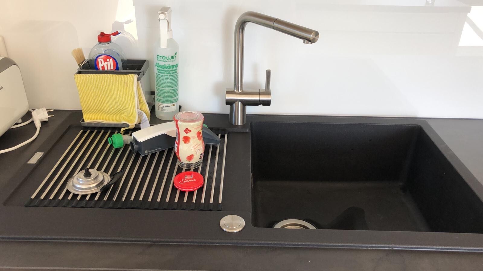

Unfortunately, the water splashes over the edge when I wash my hands in the basin...
The water stream is not strong.
Photo?
Sounds strange. I only know this from, for example, shallow (above-counter) hand basins in bathrooms (I’m done with those things).

Modern kitchen sink with black countertop, stainless steel faucet, and dishwashing accessories.

Looks like the same situation we have. I haven’t noticed the problem in two years. I’ll have to check it out tonight.
hausnrplus256 Apr 2020 11:45
We also have the faucet installed (at least judging by its appearance). I understand what you mean; sometimes it happens to us too, but I feel it’s more likely due to the installation being slightly “angled” relative to the basin, which means you’re always washing closer to the wall.
I miss the feature that allows you to pull it out! Do you have that? Do you use it? That would probably make it easier to control?!
halmi
6 Apr 2020 12:24
Maybe try slightly turning down the cold and hot water, then the pressure should not be as high. Alternatively, check the water pressure for the entire house; ours was also too high when the house was handed over.

hausnrplus25 schrieb:
We have the same faucet as well (at least visually). I understand what you mean; sometimes it happens to us too, but I feel it’s more due to the faucet being installed “at an angle” to the basin, which means you end up rinsing much closer to the wall.
I miss the feature that lets you pull the faucet out! Do you have that? Do you use it? That would probably make it easier to control?!
That could definitely be the case. Yes, we also have the pull-out function. But of course, we don’t use it when we just want to quickly wash our hands. The water pressure is fine. My friend has the same fixture but with a basin that’s 10cm (4 inches) deeper. He doesn’t have these issues...
