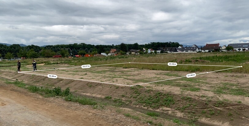

3000€/sqm (approximately $278/sqft) is quite a figure. Good if it includes additional costs, but the question is what exactly should be included.
Your plot looks like it has been filled. And what is that trench/channel?I can’t really say what the trench is for. Apparently, trees are to be planted along the field path.

I can’t say exactly what the ditch is for. Apparently, trees are supposed to be planted along the field path. If I were you, I would find that out as soon as possible. Is it meant to be a watercourse, or just emergency drainage? Could there be standing water with almost no movement (mosquito breeding grounds)? Drainage from the neighboring fields? Is there any risk of manure or slurry contamination?
You might end up with a pond full of stagnant slurry water.
It doesn’t have to be any of that, but if I were building a house there, I would definitely want to know.
