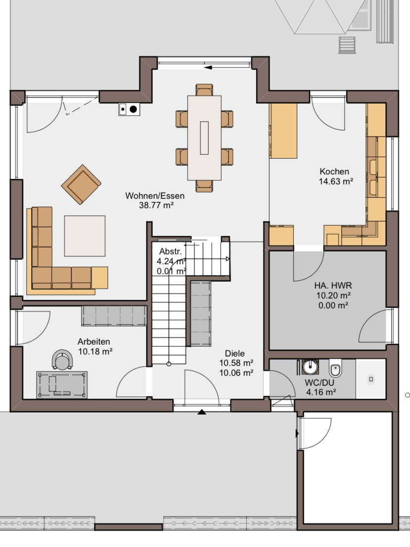

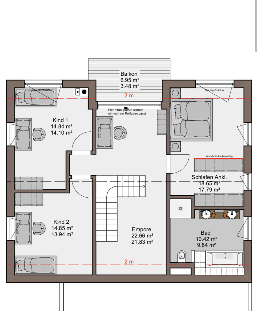

We are now at the stage where we basically have the rough layout of our floor plan and only need to make minor adjustments. (Yes, the door to the bathroom is still missing). In the attic, built-in wardrobes will be installed in the lower part of the hallway. That’s why there is so much space there.
We will now use this floor plan to request quotes from different suppliers.
We have a similar staircase, just without a landing. It works really well and looks nice. If you skip the landing, you would have a reasonably wide passage to the open-plan area and could probably create an additional small room upstairs. For example, a utility/storage room instead of built-in wardrobes.
Alternatively, you could place the entrance to Child 2's room at the bottom of the stairs (the stairs could also be built over by 1-2 steps). This way, the small corridor between the children's rooms would be eliminated.
But for obtaining quotes, the floor plan is, of course, sufficient.
Strahleman16 Sep 2020 13:03Mlt1402 schrieb:
We are now having various suppliers prepare quotes based on this floor plan.I hope you never need to get a sofa or similarly bulky furniture into the children's rooms. With the current layout, that could be quite complicated.
