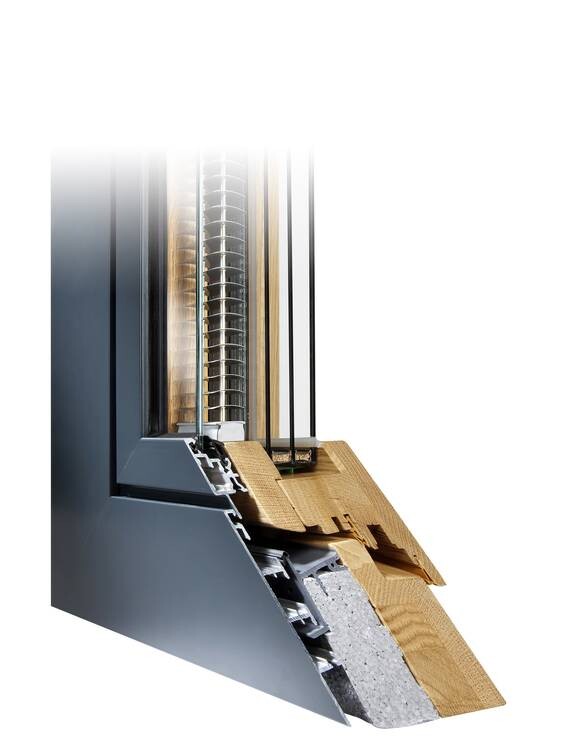

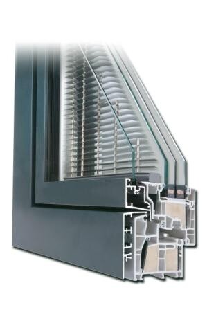

angoletti1
27 May 2013 16:10
I looked into this before. They probably won’t be completely airtight, but there’s no roller shutter box, and apart from the glass pane, there’s very little to clean.
However, they’re not exactly cheap, but plastic window versions are also available.
Cross-section of window frame with double glazing and multi-chamber profile
Cross-section of a window frame with insulation and profiles
chrizzt
27 May 2013 17:57
Let me tell you: this is not blackout shading, it only reduces the light. The room is still usable during the day without additional lighting.
