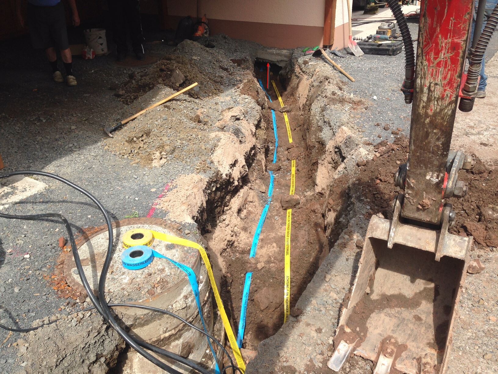

The outlet from the house and the entrance into the garage are quite close to the exterior wall. In the photo, you can see the entrance to the garage. The wall at the back is the garage wall. The outlet from the house is similar.
