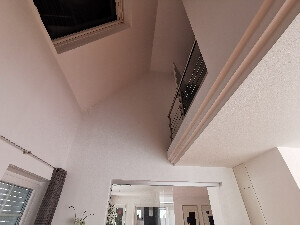

we are planning to retrofit a see-through fireplace in our house. Currently, there is no fireplace or stove in the house. The see-through fireplace is intended to be installed between the living room and the current office. The office will later be converted into a kitchen. There is a load-bearing wall between these two rooms. Ten years ago, an opening was already made in this load-bearing wall, with a steel beam as a lintel and a glass sliding door installed. This opening is now to be replaced with a see-through fireplace and a door.
Below are the current photos and concept images:
My questions are as follows:
