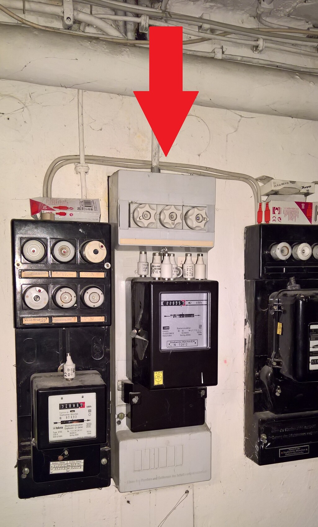

I am new to the forum and have a question about a tradesman ^^. We want to route a power line and socket from an old electricity meter (see picture) to the adjoining room (laundry room). All work is in old basement rooms, easily accessible, with no aesthetic requirements. Everything can be installed surface-mounted.
I received a quote from an electrician: €535 including VAT. That seems way too much for just a socket... He charges about €180 for materials and 3 hours of labor for a technician plus apprentice.
We live in Munich. What do you think, what should something like this roughly cost? Thank you very much for your help

What exactly is the listed material? Perhaps a new sub-distribution board is needed?

What kind of material is listed? Maybe a new sub-distribution board is needed? It’s hard to see and say for sure now. But what willo suggests could be correct.
If I look at the circuit breakers on the meter, there are several 25 A units. So I assume that 25 A breakers are installed there and the cable coming out at the top then goes into your apartment, where a sub-distribution board is located. And you can’t connect a standard socket (washing machine?) to a 25 A breaker. So that means extra work and therefore higher costs.

Bau-Schmidt28 Nov 2017 18:11Material is okay. Socket + wiring + fuse + RCD
