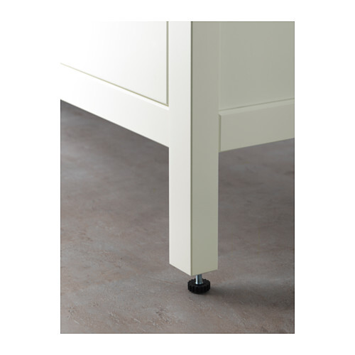

What bothers me more about the Hemnes washbasin cabinet, however, are the two front legs. I would prefer a completely floating cabinet. According to the assembly instructions (available for download directly on IKEA’s product page), the cabinet is still fixed to the wall at four points using anchors.
I’m wondering from a structural perspective what would happen if the four legs on the Hemnes cabinet were simply cut off. Would the cabinet eventually fall away from the wall after a few years, or would it hold just as securely as any other washstand costing €4000?
If it might fall, does anyone have suggestions on how to reinforce the Hemnes washbasin cabinet so it can securely hold as a floating unit?

I don’t think cutting off the legs and hanging the sink cabinet is a good idea – the included “hanger” on the back panel is only meant to prevent tipping, not to support the entire weight of the cabinet when hanging.
How about building a support frame? Some kind of shelf, painted or lacquered white, about 20cm (8 inches) above the floor, secured to the wall with sufficiently long screws (is the wall strong enough??), and then placing the legless Hemnes cabinet on top of that?

Knallkörper18 May 2017 15:01The IKEA base cabinet is not stable on its own, which is why the front legs are necessary. Furniture with legs in the bathroom is generally a no-go. Take a look at online retailers. For under 500 euros, you can get a Keramag Icon 60cm (24 inches) washbasin with a matching base cabinet. Just as an example.
