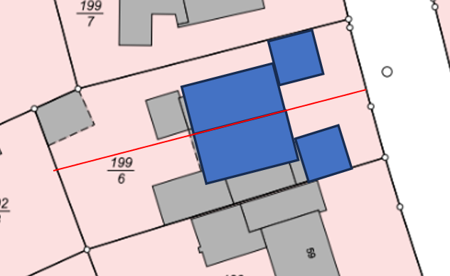

hanghaus2023 schrieb:
Which GS is it? Aren’t they all already built on?
The one outlined in red, number 57, is still built on and will be demolished.

Without knowing the exact dimensions of the GS, it might be possible to divide it like this. Then the house will be approximately 6.5*12m (21*39 feet). That should be enough for about 160m² (1,722 sq ft) of living space.
Is the demolition included in the budget?

Without knowing the exact dimensions of the plot, it might be possible to divide it like that. Then the house would be approximately 6.5 by 12 meters (21 by 39 feet). That should be enough for 160 square meters (1,722 square feet) of living space.
Without knowing the measurements, everything is pure theory with a high risk of becoming worthless. The “bowling alley” subdivision would be my least favorite option.

Detached single-family homes fit perfectly on a 400 m2 (4,300 sq ft) plot. For example, this one is located on a rear plot measuring 17 m x 23.5 m (56 ft x 77 ft)
It’s not about the size itself. In the case of the original poster, the lot is approximately 18 m x 28 m (59 ft x 92 ft).
At best, this could be considered a rear plot, but not side-by-side building is possible. Judging by the aerial photo, I wouldn’t bet on obtaining a building permit/planning permission for it. Besides the annoying issues like access roads and utilities, which are very costly (especially the land costs for sealed surfaces). Given the land value, this would be wasteful.
