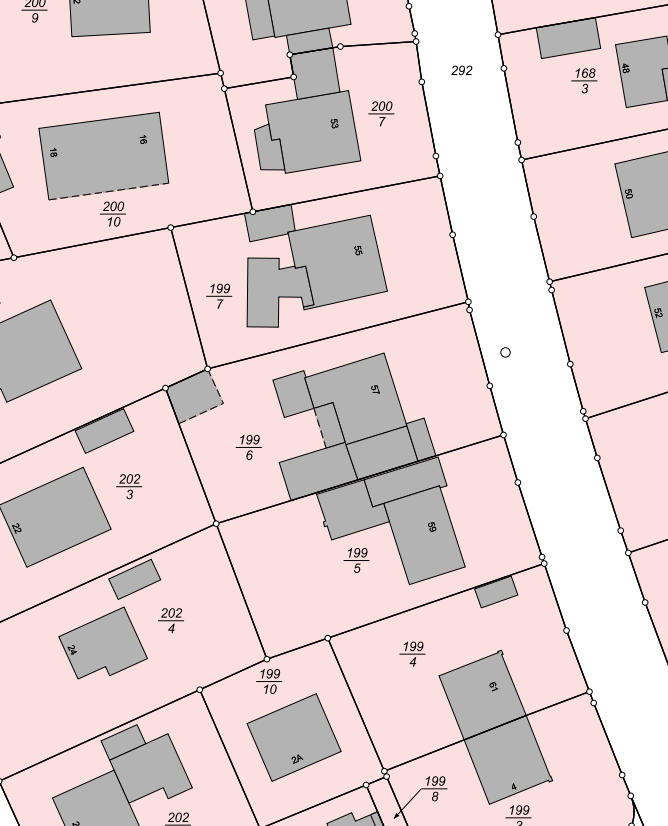

Jack1983 schrieb:
The existing building is going to be demolished, the plot legally subdivided, and two semi-detached houses constructed. [...] Whether we are even allowed to build the area and height planned on the plot still needs to be clarified. [...] There is another interested party for the second half of the plot. Legal subdivision means a front half plot burdened with a right of access (GFL right). Before purchase, reach an agreement with the buyer of the second half to jointly plan the entire semi-detached house. I recommend my external post "A Semi-Detached House Has TWO Halves" as well as reading the Goalkeeper thread here and my posts on the keywords: partial basement / no basement, underpinning, and building profile.
The discussion will gain much momentum if you provide a cadastral extract showing the plot dimensions. Essentials such as the number of floors, building height, actual floor area ratio, and similar details will be clarified by the architect during design phase 1.
