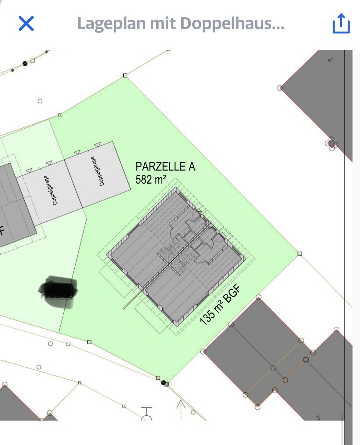

I am interested in a plot of land where a duplex is planned. The plot would then be shared with the other buyer. Unfortunately, the plot is not perfectly square. Now I am wondering whether, for this particular plot, a conceptual subdivision or a real subdivision would be better?

If I understand correctly, you could purchase the entire dark light green "Parcel A" and would be free to develop it differently than the semi-detached house example shown. The building footprint could be larger than in this example and positioned somewhat differently; a single-family house would also be possible there. However, you can only afford the land purchase if you could resell the “surplus portion of the land” to someone whom you would then accept as the neighbor owning the other half.
My question regarding the site access remains unanswered so far. Therefore, I assume the more complex scenario that a second access via the lower street shown on the plan is not an option, and the owner of the other half would either need their own connection to the upper street on the plan or you would have to grant them a right of way (easement). A real subdivision of the land would be possible but would likely have to be undertaken by you after the purchase. In this regard, you should explore whether you would only need to provide a guarantee to ensure the second buyer does not withdraw, or whether you would have to buy the entire parcel initially and then resell one half if you keep the other half. If the seller agrees to sell each half to two buyers, you would have to present a subdivision proposal and bear the subdivision costs (surveying, boundary marking, cadastre and land registry matters, notary fees). Should you have to buy the entire parcel, you would need to have the creditworthiness for the purchase and consider the time risk until resale, as well as covering all incidental costs and taxes upfront, including taxes on the capital gain from sale. However, in that case, you would have control over the decision between a real subdivision and a legal (notional) division, as well as over the project development, meaning you could theoretically plan both halves, possibly have both built, and only sell the completed second half afterward—although I assume the last point may not realistically be feasible.
Since you will not be the only interested party and the seller will want to sell the property quickly, I expect they would prefer a buyer willing to purchase the entire parcel rather than waiting for you to find a co-buyer. So most likely, you will need to buy the whole parcel and then resell the surplus land. If I were your bank, I would feel most comfortable if you could already bring a committed buyer for the surplus land when seeking interim financing for the project.
I consider the parcel division shown in the site plan generally realistic—with one major exception (namely that two additional parking spaces will be required)—and would prefer a legal (notional) division. This way, you could also purchase the land as a development company (the half-neighbor would then buy their share of ownership in the company instead of you selling them half the land). You have to decide how far you want to familiarize yourself with this by consulting a tax advisor.

It seems realistic to me that the house is divided as shown—“front” northwest half and “rear” southeast half, roof ridge running northwest-southeast—assuming the sizes as indicated (I remind you of my question whether the gross floor area refers to the total building footprint or the floor areas of one half). So, it is conceivable that only about 120/125 sq m (roughly 1,300/1,350 sq ft) of living space per half might be possible. And, as mentioned, two additional parking spaces would probably still need to be provided.

Thank you for your expertise. Regarding your first paragraph: Yes, you understood it correctly. It would be possible to freely choose how and what to build.
Concerning the site development, it would probably make sense to carry this out jointly towards the upper street (ground floor level rights).
Since I have an appointment soon with a construction company and a bank regarding financing, I would immediately look for a buyer for the second part of the plot if the outcome is positive.
Afterwards, a joint purchase and a notional division are planned. As far as I understand from the seller, this would also be acceptable to him. I still need to inquire about the gross floor area.
The idea of having two parking spaces definitely makes sense.

Probably best to have both in tandem, roughly 3 x 13 m (10 x 43 feet) along the boundary.
