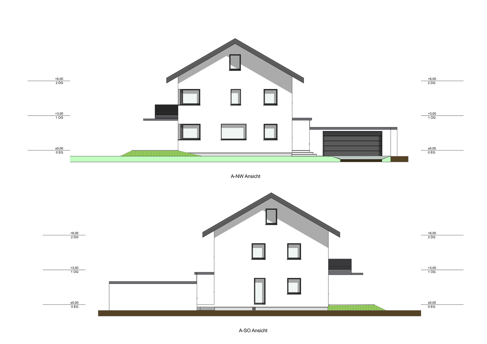

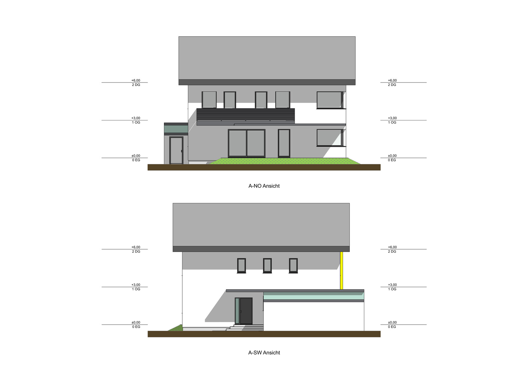

Dear community,
I would like to share our planning with you and invite discussion. We are open to criticism, as we have been working on this project for some time. A particularly important aspect for us is the potential future division into separate living units. Among our friends, we often see conversions, and we aim to achieve this without major renovations such as adding external staircases or demolishing the existing staircase. Your opinions and suggestions are very welcome.

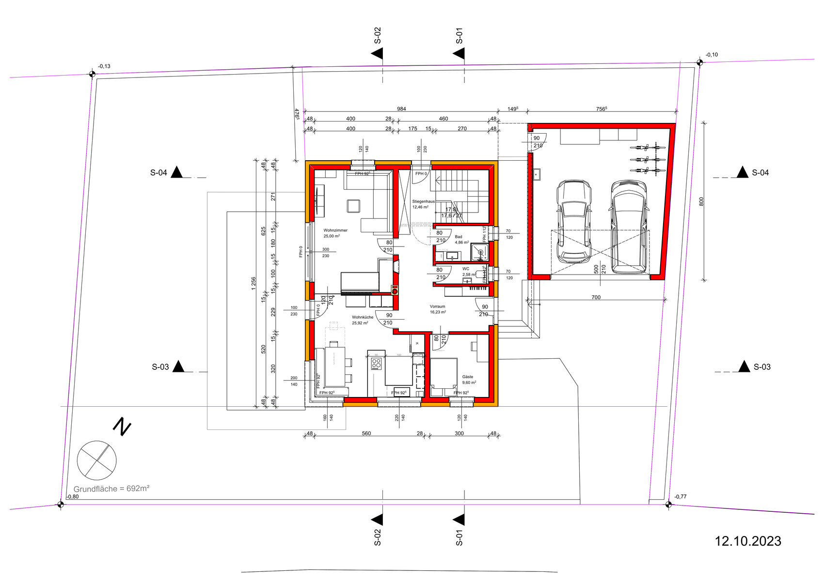

We want to keep the floor plan flexible during planning, to potentially separate it later into 2–3 apartments without major renovation work.
For this reason, the staircase (basement to attic) was positioned at the edge, so it can later be used as a separate entrance.

Ground Floor (GF):
Dining kitchen & living room, separable with sliding door.
We gave up on a pantry in this version because, based on our experience, large cabinets suffice, and there is enough storage space for drinks etc. in the basement
Tiled stove, heatable from the hallway
Guest room
Small bathroom and toilet

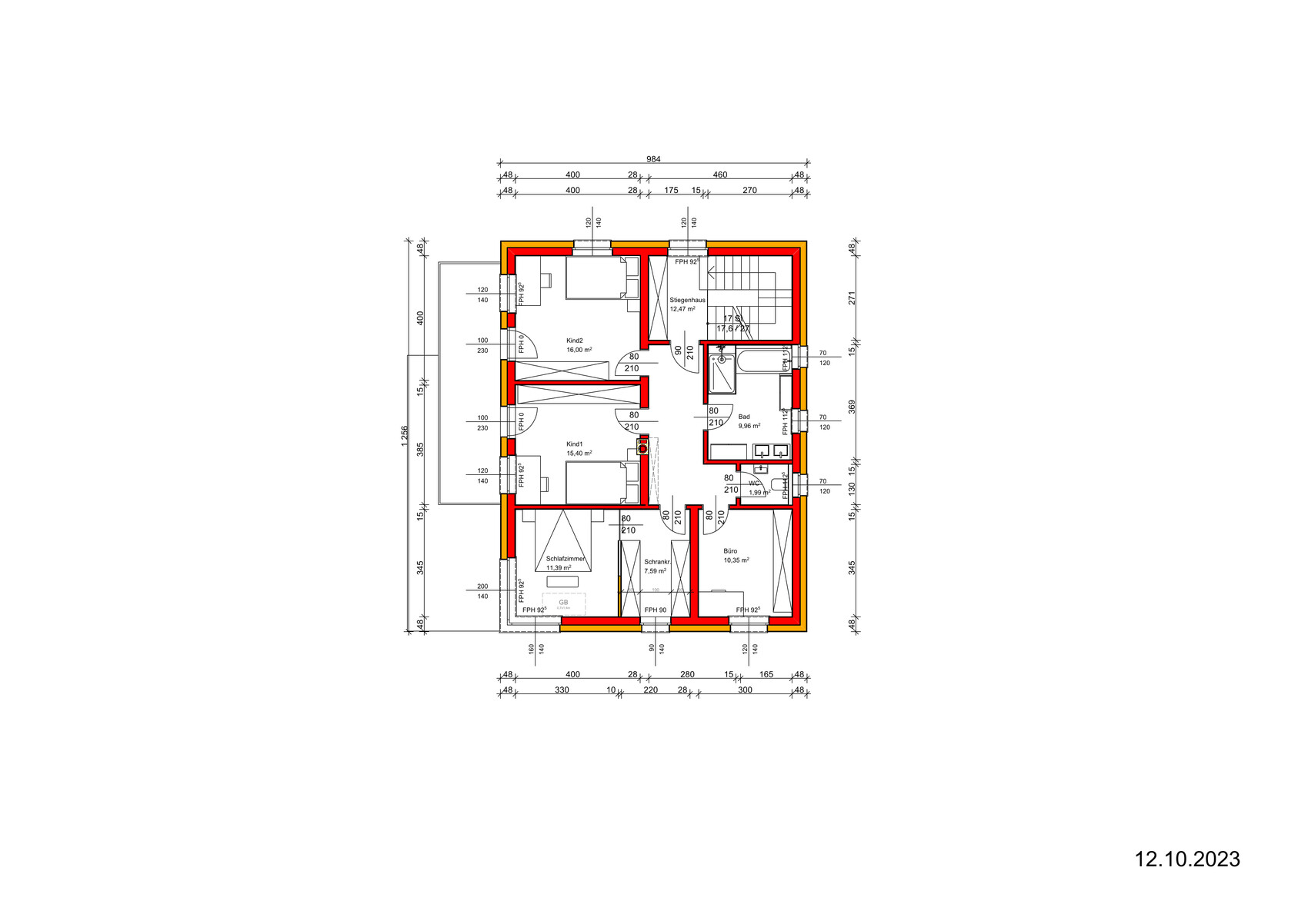

Upper Floor (UF):
2 children’s rooms
Master bedroom with dressing room
Office
Bathroom & toilet

ypg schrieb:Who would want their bathroom to smell like sh... when taking a shower if it were possible to combine the toilet and bathroom? Load-bearing walls are a matter for structural engineers, not architects, and I dare say I know about that.

The choice of having a toilet is simply a matter of personal preference. I personally like my toilet in the bathroom because I often need to use it right before showering... and at that point, I’m already naked 😉. Comments on the spatial proportions of the rooms and how usable that space is are helpful. Also, if you’re planning a two-part layout, it makes sense to consider the potential future use of certain rooms... for example, the ground floor guest room could become a couple’s bedroom in a two-part setup.

Oops, I actually wanted to ask where the north is, and now there is sulking happening here!

WilderSueden22 Nov 2023 22:02Having a separate toilet like that is possible. However, four toilets in a two-story single-family house is a bit excessive. Even just having a bathroom on the ground floor is already a luxury that is hardly used in practice (we have one too). Adding an additional separate toilet on top of that is, again, a waste of space. I understand that for you, this is a way to prepare for old age if you want to turn it into a multi-family house, but these are the extra costs involved. It’s not just a second electrical panel on the upper floor.
