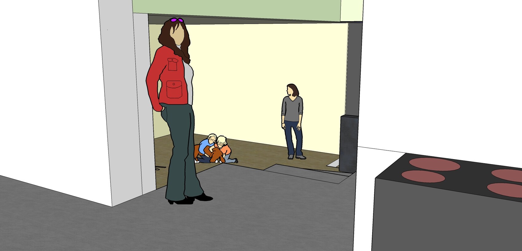

@ Katja: hm, that could be the case! It would then look like this:

kaho67416 Mar 2018 18:40
vgbau schrieb:
@ Katja: hm, that might be it! It would look like this:
Nice visualization. I also like the idea of the extension, but somehow the coziness doesn’t quite come through in the living room, does it? Maybe it’s just a matter of interior design?
vgbau16 Mar 2018 18:49
We already have concerns, especially because of the open layout of the kitchen, PC area, oversized dining room, and the height difference to the living room.
However, due to the terrain and the previously mentioned key points, this option seems suitable.
The proposals from the builders’ planners were all unappealing.
Wickie
16 Mar 2018 19:05
So, I would also open up the kitchen wall at least partially!
Cozy atmosphere has a lot to do with the interior design. That can be arranged really well and made comfortable!
I really like the extension as it is!
Climbee16 Mar 2018 20:41
I know of an attached living room, like yours, that is set lower with the dining area above it. I never found it uncomfortable. Possibly, you could also create some privacy using large plants. I wouldn’t have any concerns about that.

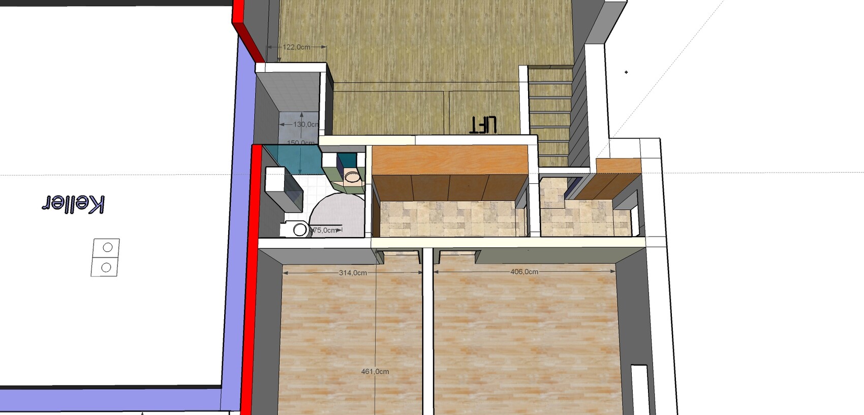

I have started to come to terms with the living room. However, I am less convinced by my basement level (garden level). It was originally intended to be an option for accessibility in the future.
In the meantime, my daughter has become interested in it and wants two separate rooms.
The wet room (bathroom) must already be designed for accessibility now. In my opinion, there is far too little space for this.
Who has experience with this?
What is realistically necessary?
