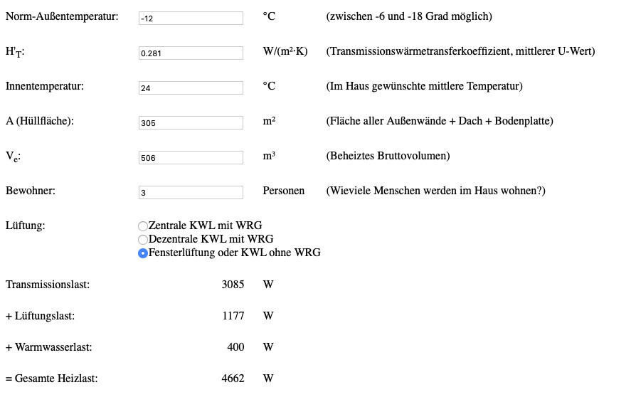

SaniererNRW123 schrieb:
You can also calculate your heating load using a different tool. Try googling "trench collector heat pump consumption database energy saving ordinance heating load." It comes very close to a detailed calculation (it’s from a group of DIY enthusiasts). I gave it a try, and here’s what I got:
I already set it to 24°C (75°F), which is quite warm. We don’t actually need it that warm, more like the 21°C (70°F) group.
Wärmepumpe.seeker
