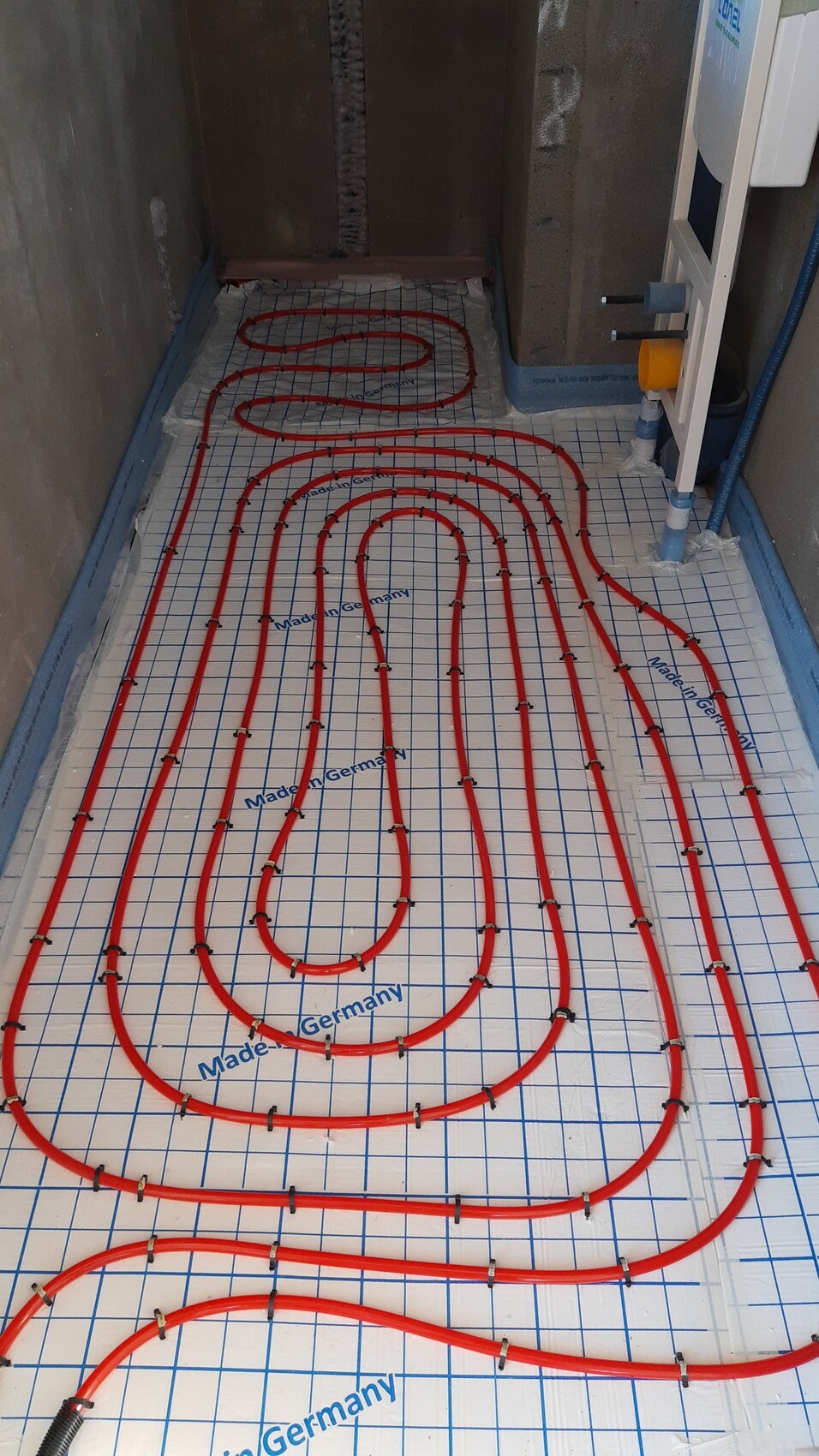

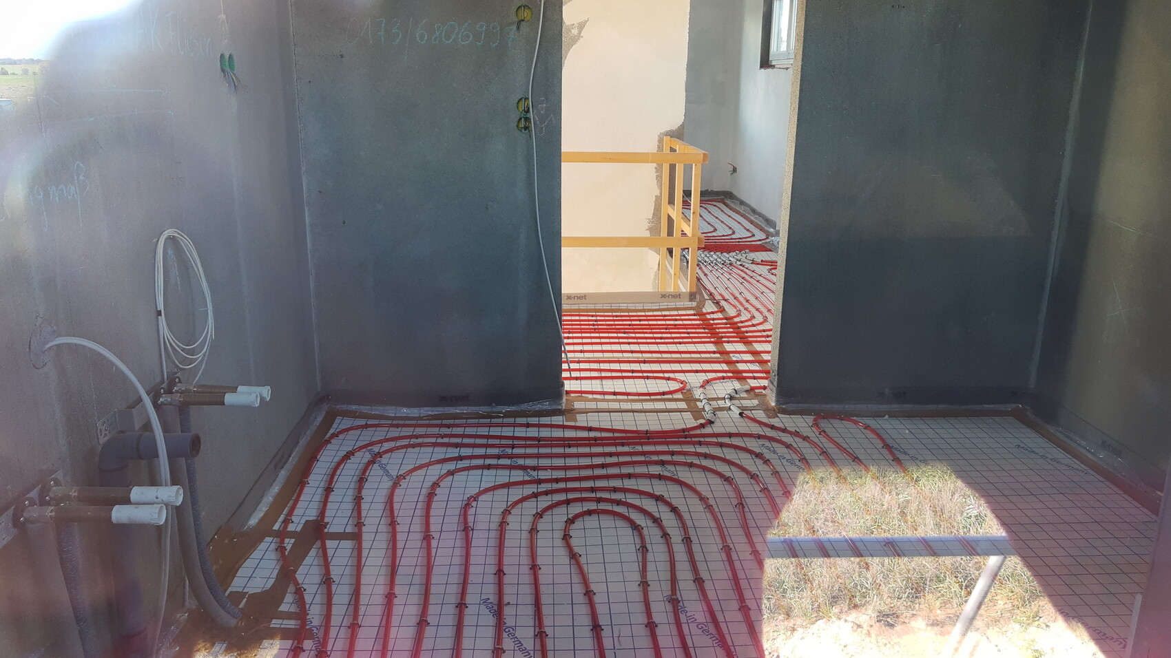

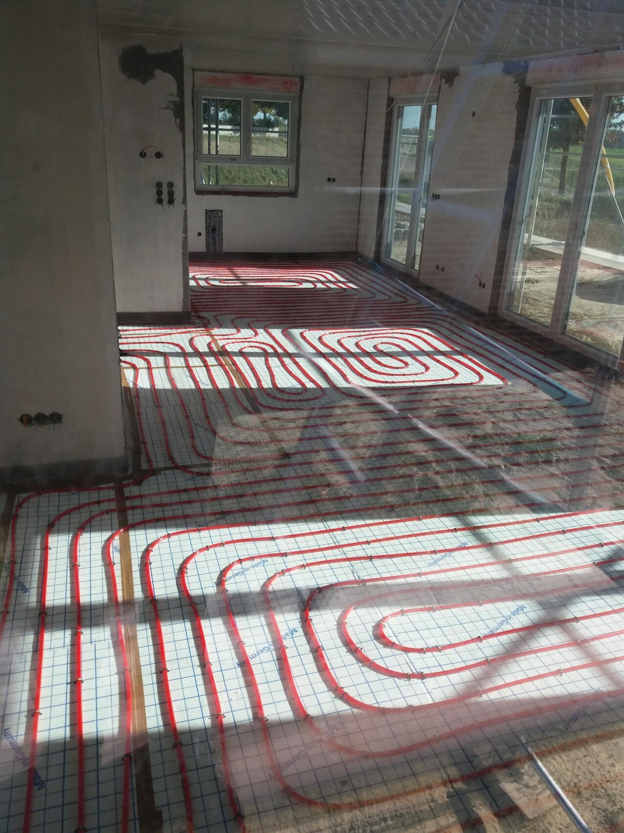

Here are a few photos. In the bathrooms, the pipe spacing is closer to 10cm (4 inches), while in the living areas it is about 15cm (6 inches).

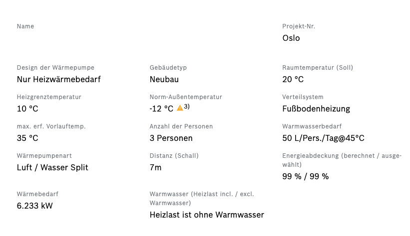

Standard heating load: 5115 W
Design heating load (with warm-up factor): 6233 W

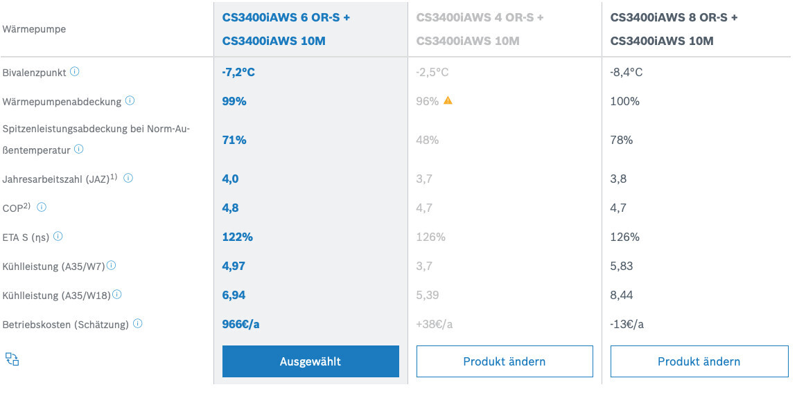

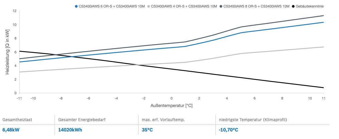

I entered the data. It looks like a 6kW system (blue line) is recommended, but the 8kW is close. Screenshots attached.

Thanks for the tip about the planning tool.
