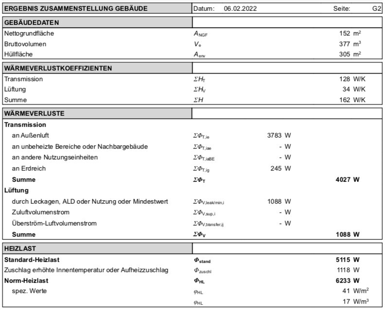

Here are excerpts from the heating load calculation.
The summary of the heating load calculation.

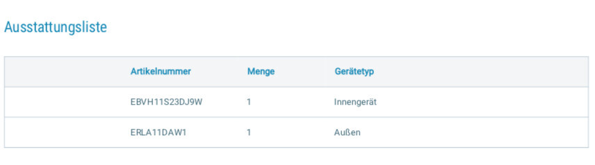

Then image 2, an excerpt from the heating navigator by Daikin.
There are completely different values again, suddenly an outdoor temperature of -8.6°C (16.5°F) is used.

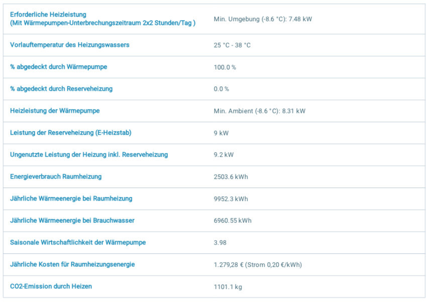

And image 3
The "solution": the 11 in the center stands for 11kW.
I don’t understand this.
And image 3
