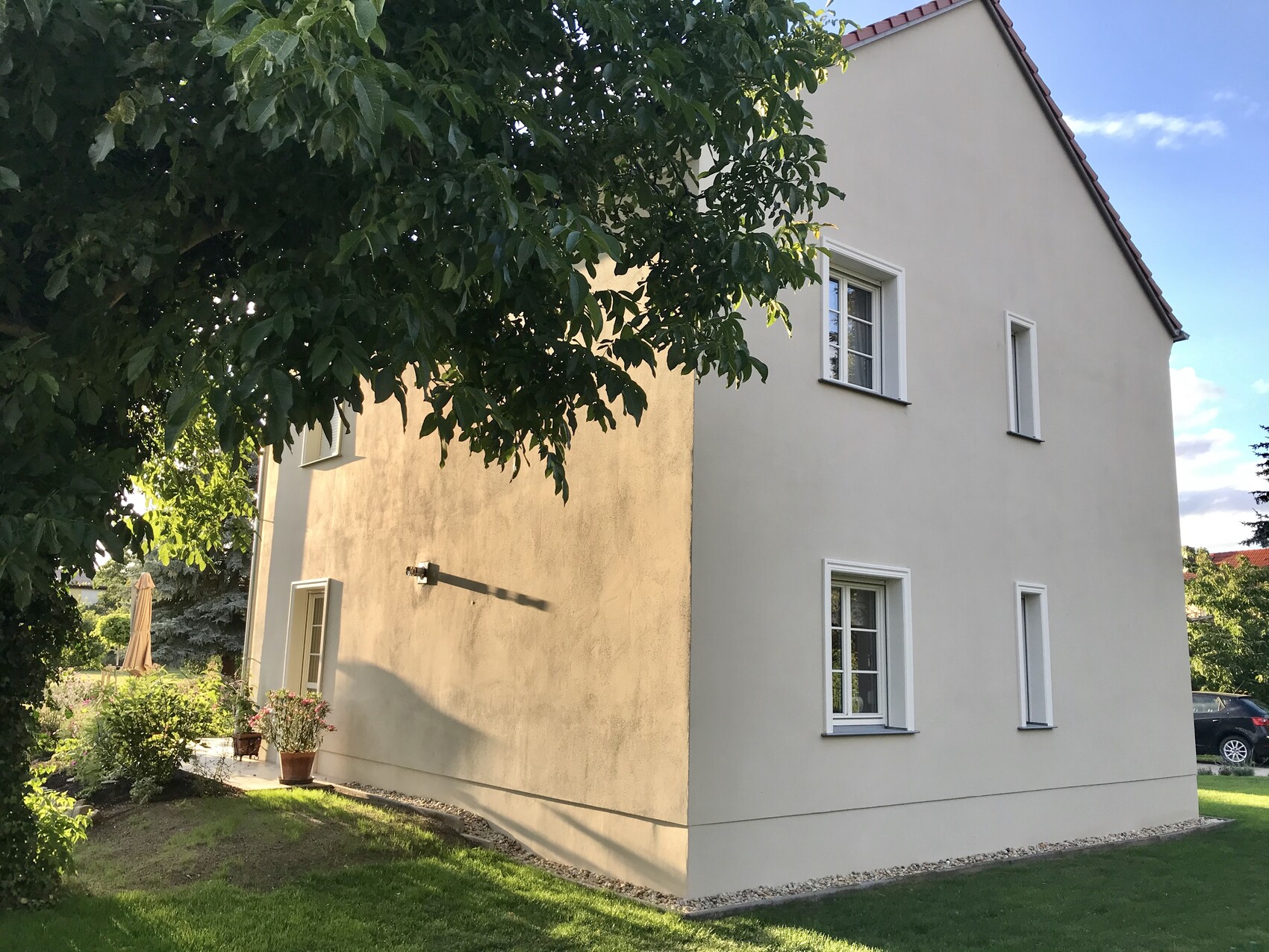

Georgian201923 Sep 2021 18:08We also have a gas fireplace with a direct vent system. The vent pipe had to be supplied by the fireplace manufacturer (Dru). We chose a simple solution and routed the vent directly through the exterior wall at about 2.5 meters (8 feet) height. It is hardly noticeable and saves the entire run through two floors. By the way, the fireplace delivers around 7 kW, so it heats very effectively, no need for preheating, no soot, and it switches off immediately if it gets too hot.

We also have a gas fireplace with a direct vent system. The vent pipe system had to come from the fireplace supplier (Dru). We kept it simple and routed the vent pipe directly through the exterior wall at about 2.5m (8 feet) height. It’s barely noticeable and saves running the vent through two floors. By the way, the fireplace has around 7 kW, so it heats very effectively—no need for gradual lighting, no soot, and it switches off immediately if it gets too hot. Great, that’s exactly the solution I was hoping for. Unfortunately, in our case, it’s not possible because we have too many windows and patio doors on the ground floor, and the vent system must maintain a certain minimum distance from them. :-(
Georgian201924 Sep 2021 09:04Pinkiponk schrieb:
