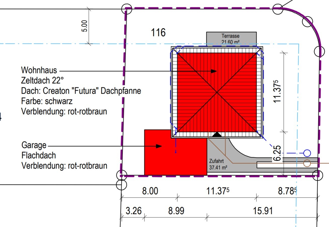

We are planning a new house with direct access to the garage. According to the current plan, the garage is located right on the property boundary. The building permit application has been submitted, but the building authority is not satisfied with the plan.
We received a message from the building authority stating that this is not allowed and that, according to Section 6 (5) of the state building code, a distance of 3 m (10 feet) from the boundary must be maintained because the planned garage is not considered a privileged garage under Section 6 (7) No. 1 of the state building code.
Due to the connection to the house, it is apparently no longer regarded as a separate building and thus belongs to the house. Reference was also made to "OVG Rhineland-Palatinate, 25.06.2009, 1 A 10050/09."
Is there any way to circumvent these regulations, or are there more recent rules than those from 2009? I am also wondering why a regulation from Rhineland-Palatinate was cited, even though the construction is supposed to take place in Schleswig-Holstein.

Attached is the site plan.
I have read through all the relevant paragraphs and the case "OVG Rheinland-Pfalz, 25.06.2009, 1 A 10050/09." Am I correct in assuming that if there is a (fire) wall between the garage and the house, this is allowed? Does a fire door also count as a fire wall? The construction company has planned a fire door in that location.

The main issue is likely the setback distance from the neighbor’s property line. However, I’m surprised by the rejection if it’s a standard garage with access to the house. That is quite common.

What is inside the garage? Technical equipment? And what are its length and height?

It is a standard brick-built garage with facing bricks.
At the boundary, it is 8.99 meters (29.5 feet) long and 2.79 meters (9.15 feet) high.
