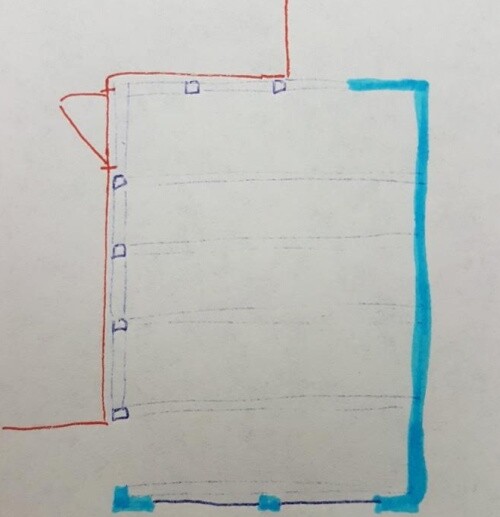

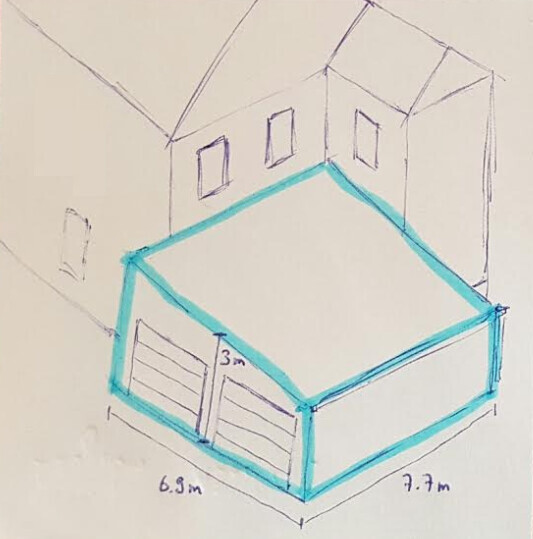

We would like to build a garage that fits the house (have it built due to the size of 50m2 (540 sq ft) and the related structural requirements). The idea is to have direct, sheltered access into the house and gain parking space. Two quiet sectional or rolling doors are planned for the front. The concealed corner on the left should remain open for easy access to the garden gate, and a door at the rear right leads to the garden.
Since we do not want to interfere with the external thermal insulation composite system (ETICS), the garage should be self-supporting.
Hand-drawn sketch of a rectangular extension with a blue frame in front of a house; two doors.
We have considered having just a carport built and then cladding it properly with wood. We even received a quote from a company for this.
After some further thought and discussions, we now prefer a more solid approach, meaning we want to build the outer wall with masonry and keep the wooden supports along the house. In the sketch, the blue part shows the wall, and the squares represent wooden posts:
Sketch: red border on the left, blue edges at the bottom and right; corner squares, red curve at the top left.

Walls: Would wood or masonry be better? We want to plaster the garage walls to match the house; the company suggested plasterable OSB boards. However, wood requires much more maintenance, offers little sound insulation, and cannot rest directly on the ground (it is very windy here).
Floor: Paving or concrete slab? We could have paving done for about 75€/m2 (7 USD/sq ft). Is a concrete slab comparable? What are the advantages of each? Elsewhere, we had paving that often became damp.

Our total budget of €18,000 (about $20,000) is unfortunately not very large but would cover the wooden structure, paving, and the mentioned polycarbonate roof. The question is – will we be satisfied with such a solution? How have you done it?

I checked again because I wasn’t quite sure about that either. They are 22mm-thick (7/8 inch), impregnated OSB boards, on which 20mm (3/4 inch) polystyrene insulation, reinforcing mesh, and plaster will be applied. This is how it’s also done on other extensions and, for example, on timber frame constructions.
