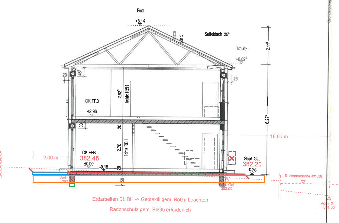

Oberhäslich22 Feb 2023 12:15Attached is the side view again. I have three questions:
1. The civil engineer is responsible for the foundation up to the underside of the slab-on-grade, correct?
1.1. Am I then responsible at the end of the construction process for creating or commissioning the blue area (13cm (5 inches) fill up to the planned site level)?
2. The green area is excavated by the frost protection footing contractor, right?
4. Is there a blinding layer beneath the slab-on-grade? We plan to use certified recycled concrete aggregate (5-45) or fine stone sand (0-32).
Feel free to help me with calculating the excavation volume and gravel quantity. The working space is 2m (6.6 feet) with a 65-degree slope. Length 11.33m (37.2 feet) x Width 9.08m (29.8 feet). According to the soil report, the humus layer needs to be excavated down to 0.5 to 0.7m (1.6 to 2.3 feet).
- Current ground elevations at house corners are: Corner 1: 382.0m (1253.3 feet), Corner 2: 382.0m (1253.3 feet), Corner 3: 382.1m (1253.6 feet), and Corner 4: 382.6m (1255.3 feet)
-> I calculate an average excavation depth of 0.675m (0.5 + 0.5 + 0.6 + 1.1 divided by 4), assuming no stepped excavation.
- 15.33m (50.3 feet) x 13.08m (42.9 feet) x 0.675m (2.2 feet) = approx. 135m³ (4766 cubic feet)
Gravel fill. I calculate an average fill height of 0.57m (1.9 feet), rounded up to 0.6m (2 feet).
- 15.33m (50.3 feet) x 13.08m (42.9 feet) x 0.6m (2 feet) = 120m³ (4238 cubic feet) plus 10% compaction = 132m³ (4662 cubic feet)
Is this roughly correct, or am I making a mistake somewhere?
