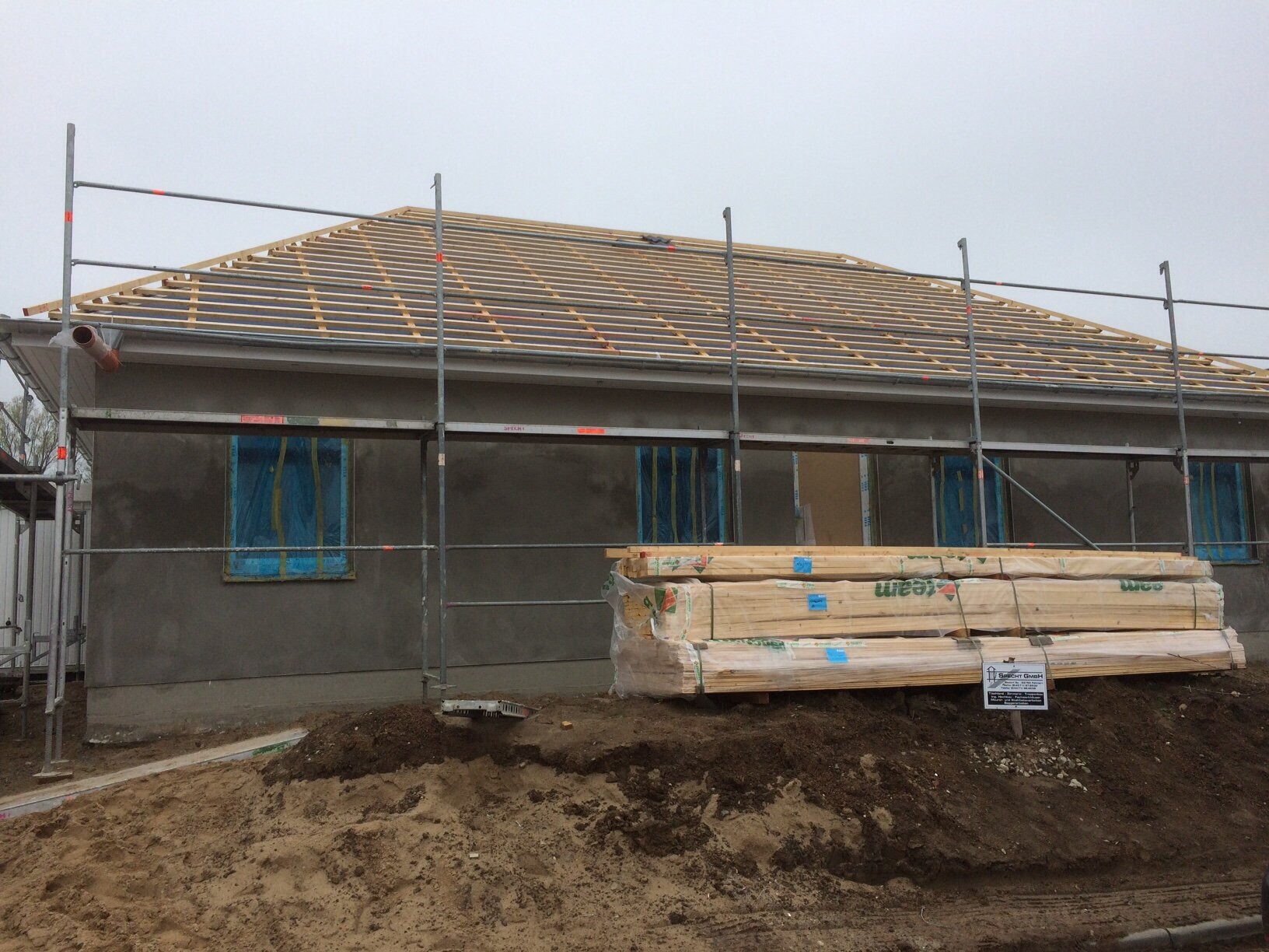

I would arrange with the door supplier to have the front door installed only as a frame without the infill, since a chipboard will be inserted, and the infill will be delivered and installed later when it can be done safely. This is how we did it. See picture. The frame and handle are well protected by film. Karsten

But this only works with front doors that have a visible panel, right?I think Nordlys actually meant the "door leaf." So you would install just the door frame (which can then be plastered around) and protect it by covering it; the door leaf itself—whether it has paneling or not—is not hung yet, nor are its hinges tightened. Instead, a chipboard is inserted, into which a temporary construction door can be mounted.
