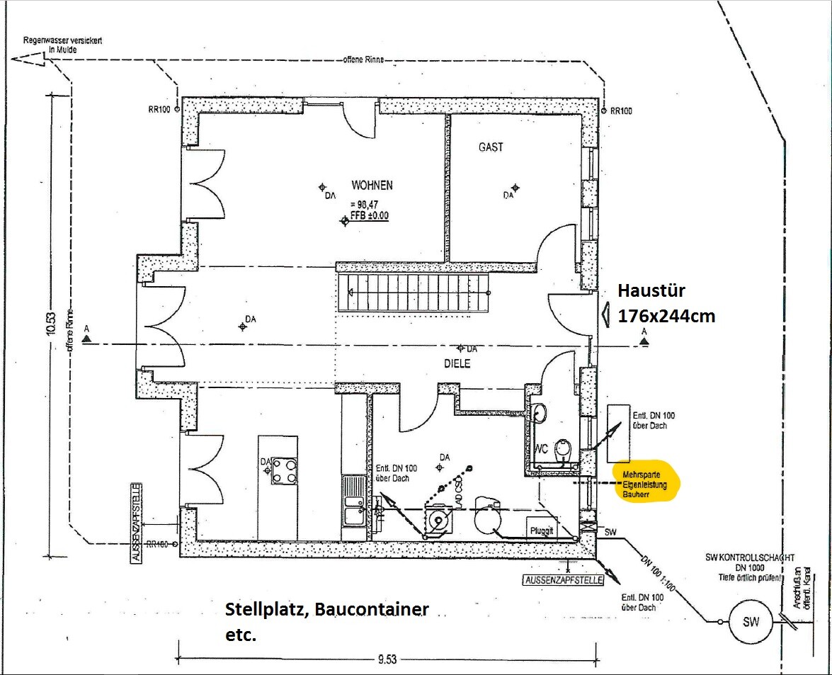

If there is no other way and to avoid costs and damage to the expensive front door, I should just install it from the start, pack it well, and lock it!
The construction workers would then simply enter the house from the back through the terrace.
Is this possible? Can I insist that they access the house from the side or back to protect the door?

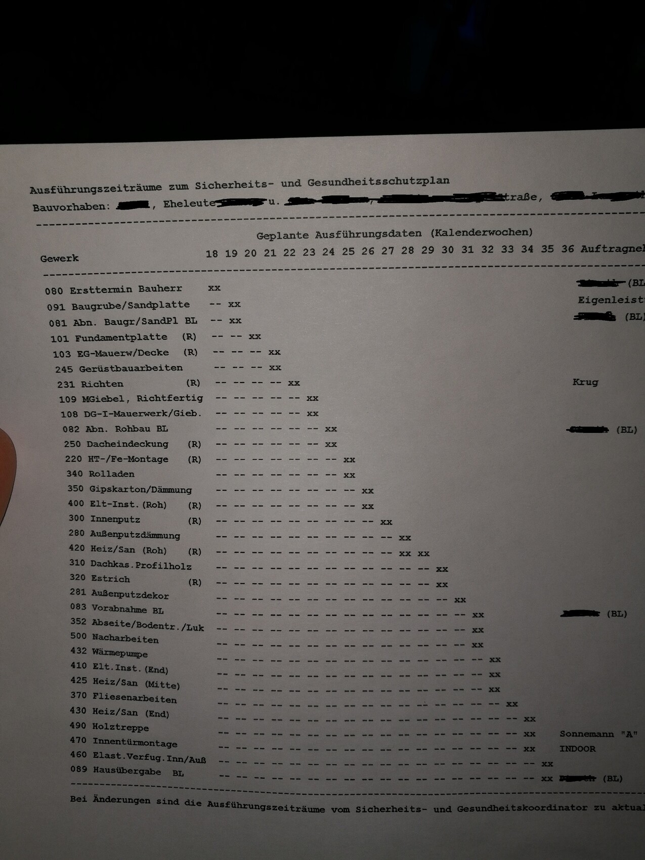

Attached is our construction schedule and the floor plan with the “entrances.”
