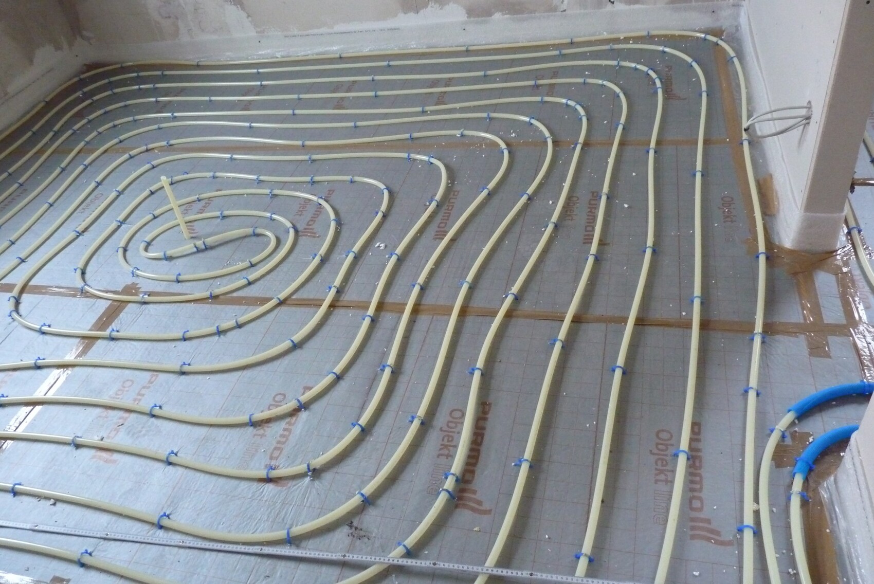

Bieber081530 Mar 2016 21:56elVincent schrieb:
a vapor barrier above the insulation is necessary to keep indoor humidity away from the surface of the floor slab. In the image you posted, it explicitly says "vapor barrier." Personally, as a layperson, I don't believe that indoor air diffuses through the prefabricated floor and the screed. That said, I find the "sheet" on top of the insulation board, where the underfloor heating pipes are laid, to be reasonable, if only to prevent the freshly poured screed from soaking the insulation underneath. Once the screed is dry, I don’t see any more issues. Experts might correct this...
There remains the scenario of a leaking heating pipe, but in that case, you would probably have to tear everything up anyway, so the insulation hardly matters.
In practice, of course, a sheet is laid and sealed, but then at each of these blue clips, there’s again a hole in the sheet. Well, practice versus theory. It’s close enough.
