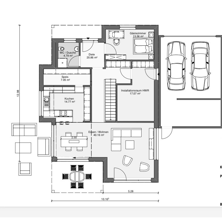

Hello everyone, we are in the initial stages of planning our house. I am not yet satisfied with the current floor plan for various reasons. I believe the living space can be used much more effectively and efficiently. I look forward to your suggestions and ideas:

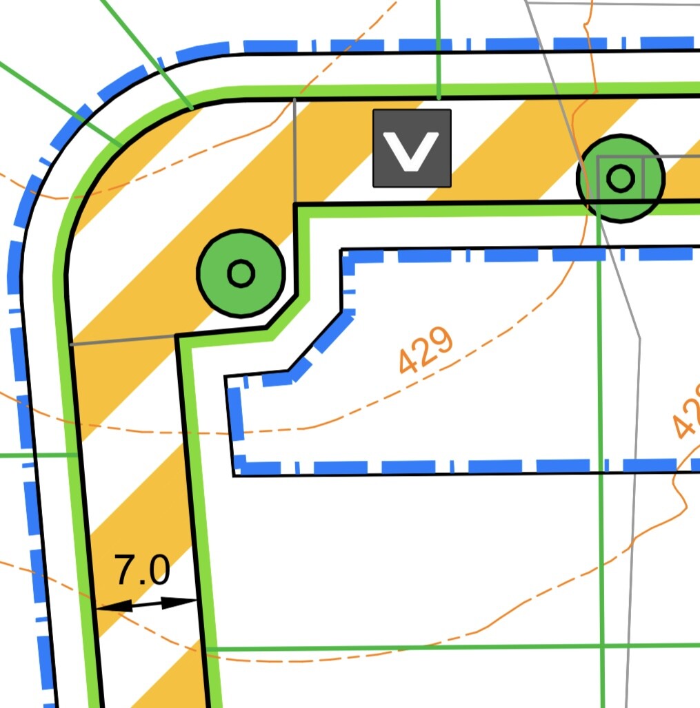

Plot size: 754 sqm (8,120 sq ft)
Slope: 1 m (3 ft) height difference
Site coverage ratio: 0.3
Floor area ratio: 0.6
Building envelope, building line and boundary: 10.5 x 15.5 m (34 x 51 ft) (pure building footprint due to planned attic)
Edge development

What do you particularly like? Why? All room wishes have been fulfilled, open space in a good position with large windows
What do you dislike? Why? Corridor too long, cloakroom too far from the entrance, terrace access only around the corner behind the dining area (but there are two large sliding doors there), utility room without a window, kitchen only accessible through the living room, planned swap of utility room with guest room, little storage space in the living room
Price estimate according to architect/designer: $630,000
Preferred heating system: air-to-water heat pump
If you had to give up, which details/extensions
- can you give up: straight staircase
- cannot give up: 2 offices
Why was the design made the way it is now?
All room requirements were fulfilled but the layout is not yet optimal. Modern look (especially the southwest house corner)
Lots of wasted space, long corridors, uneven room sizes, limited storage in the living room, blocked access to the terrace

hanghaus20232 May 2024 09:27Architect’s cost estimate and budget are not the same. Costs often increase during construction.
Schorsch_baut2 May 2024 09:33I would definitely question the builder and their quote before waking up with buyer’s remorse and having to cut costs or secure additional financing during construction.
I’m looking at 240 sqm (2,583 sq ft) of living space with open areas and plenty of window units, lots of projections and recesses, a concealed pantry, and all the high-end features. That comes to only about 2,600 euros per sqm. Then there’s the double garage. I would estimate the budget closer to 850,000 euros or even more. If you have that kind of money available, then worrying about a dark hallway becomes a minor concern.
In a mid-price region, we received an offer for a two-story extension in February, and without major upgrades to heating or similar systems, the cost was 2,900 euros per sqm. That was 100,000 euros for an extension that would have increased the planned living area by 50 sqm (538 sq ft).
derdietmar2 May 2024 17:17Hello,
I agree with the previous poster. Below 800k, there’s not much to expect: standard features (plastic windows, concrete stairs, inexpensive doors, conventional electrical installations, basic fixtures, budget flooring) without furniture.
