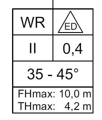

Building envelope, building line and boundary: see drawing

- The maximum eaves height is limited to 4.2 m (13.8 ft) according to the development plan, which means we cannot make the knee wall any higher.

With 1.20m (4 feet) calcium silicate blocks, you get an interior knee wall of about 130cm (51 inches). Currently, you have 100cm (39 inches) inside. So there is a capacity of 50cm (20 inches). There is also this buffer in height. I would definitely increase the block size and take full advantage of the height. The attic would also gain standing height, which is important for storage space, since some items would otherwise get moldy in the garage.

Edit: I probably confused the eaves height with the wall height. Anyway, the planner should get all the details out.
Build with the material that the builder usesHere with the search term "11ant Steinemantra" and externally including the quotation marks as "The stone mantra of 11ant".ypg schrieb:
Edit: I probably confused eaves height with wall height. Anyway: the planner should figure everything out.Since they are synonyms, they cannot be confused in their meaning. Wall height is the neutral term, because otherwise pedants might consider the parapet of a flat roof as not subject to the regulation. Beware: the "self-chosen" top edge of the finished ground floor surface is not always identical to the reference height!https://www.instagram.com/11antgmxde/

The maximum eaves height is limited to 4.2 m (13.8 ft) according to the development plan, so we cannot go any higher with the knee wall. In this case, you either box in the ceiling on the upper floor or build, for example, built-in wardrobes behind the bed. Either way, the bed has to be noticeably set back from the sloping ceiling and moved towards the center of the room. If there isn’t enough space for that, you need to build larger. And before you consider buying a different bed – no, that’s not a solution either. Otherwise, you will constantly bump your head on the slope.
