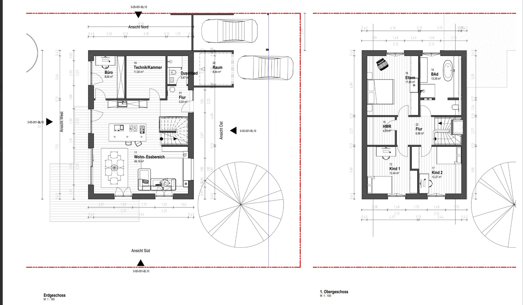

This is the second draft. The first draft (see image) had a large kitchen island, which felt space-consuming and too central. Also, the office/guest room was on the ground floor, which we have now dropped to gain more space there. The first draft also lacked a pantry.<br />
<br />
In the first draft, the house was rotated 90°. The orientation of the house on the plot remains crucial for us and may still not be final. We welcome suggestions and new ideas. Our wish is definitely that most of the terrace faces the retention area.<br />

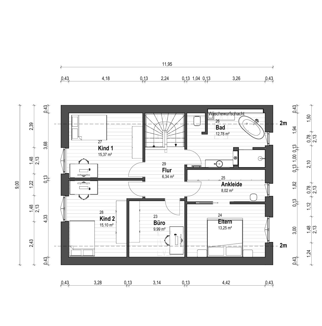

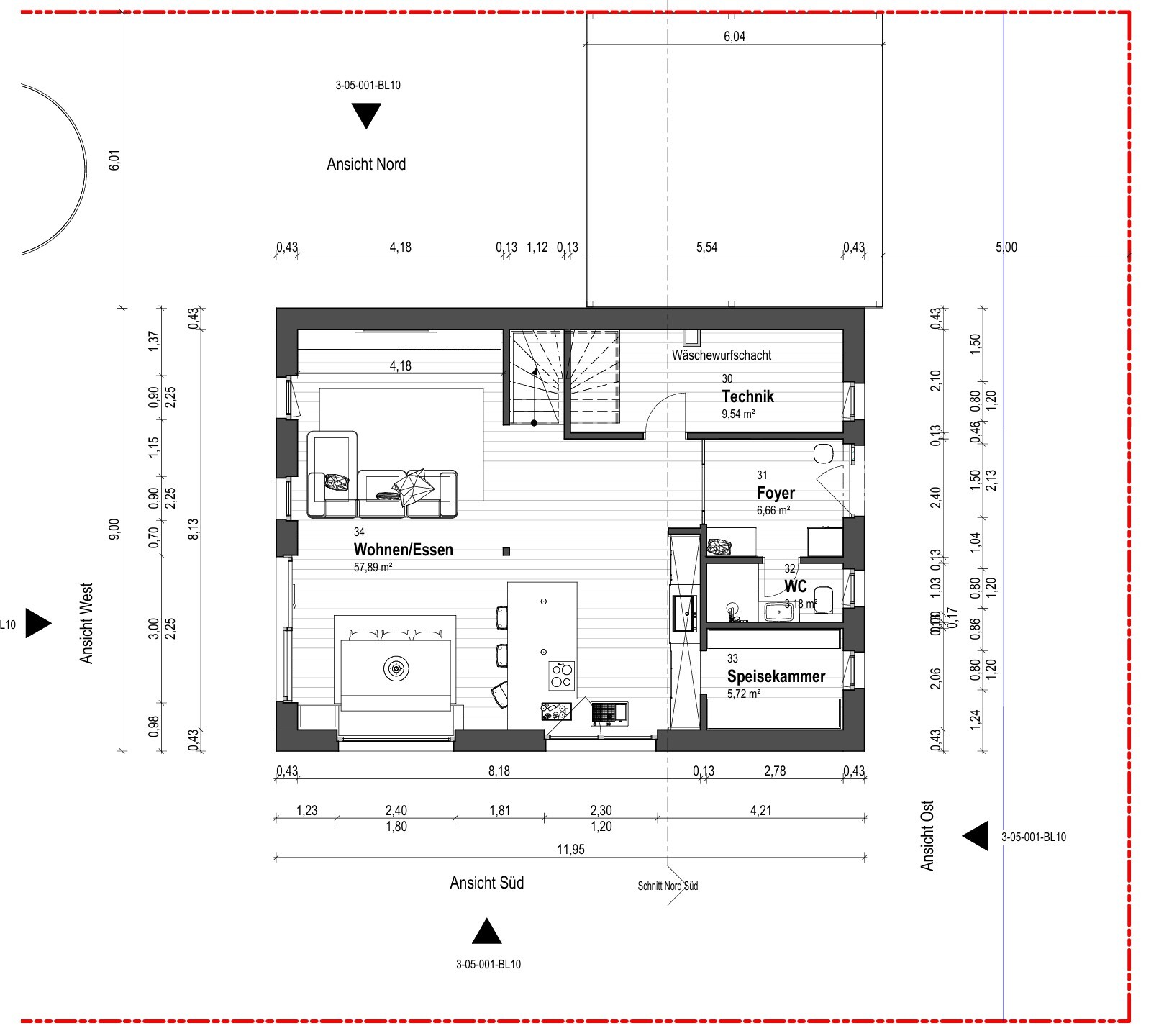

From here, images of the current second draft follow:
Ground floor
Upper floor
That’s enough from me for now. I look forward to your input and thank you in advance for reading my post.

for two adults, the floor plan is acceptable, but with two children it becomes cramped. The second child has very little space due to the inefficient layout. Additionally, there is no wardrobe area with sufficient storage.
Downstairs, the wardrobe, pantry, and guest toilet need to be rearranged. The pantry should be smaller to create more space in the wardrobe area.
Upstairs, the walk-in closet needs to be removed to provide more space for the children's room.

MachsSelbst19 Oct 2025 11:44Where do the 12 people who often come to eat sit? Do they eat in two shifts? The dining nook is tiny, but next to the kitchen there is a huge, useless dance floor.
I prefer design 1... reasons can be found in design 2.
Design 2 –
Sofa placed prominently in the center
Utility room is inconveniently located
Why is the pantry so huge?
Why a shower bathroom on the ground floor?
Kitchen and space toward the top of the plan don’t feel right, column blocks the way to the terrace, which only has west access, always passing by the sofa.
The so-called walk-in closet and passage to the sleeping area – you could skip the wall here and make the overall room a bit smaller instead.
