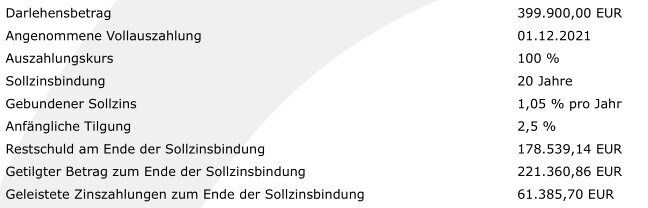

Right now, I’m focusing on the financing question: We are aiming for an installment of roughly 1200€ and have always planned for the option of extra repayments….
a) …should we choose a better interest rate for 15 years or
b) lock in the current low interest rate for 20 years (or even longer)?
a) – the question here is what interest rate you can get for the remaining 226,000€ as follow-up loan
b) – here, I would pay almost 12,000€ more interest over the comparable period, which is roughly equivalent to one average year of repayments
For 25 years, the interest rate increases somewhat more to about 1.25%. There are also no benefits for a full repayment loan (around 32 years).
