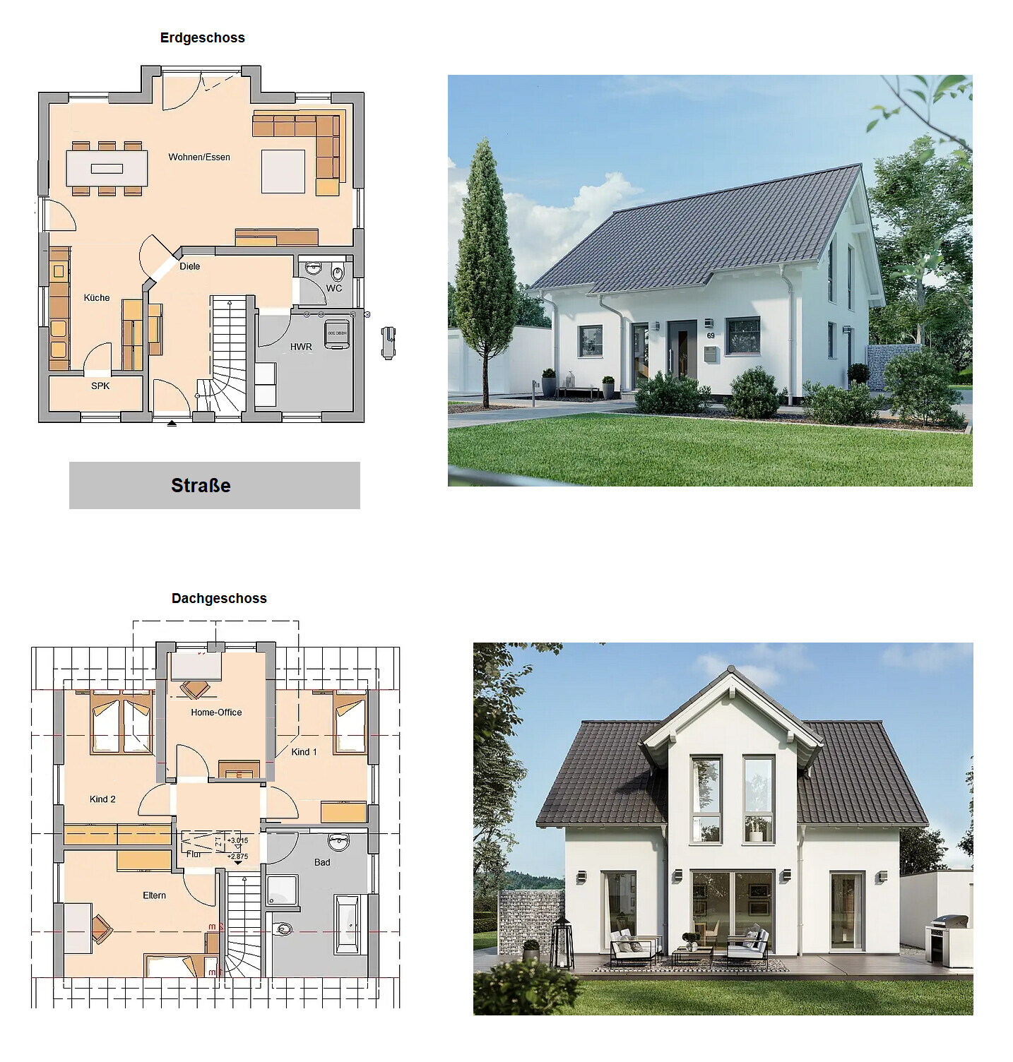

This floor plan is based on the standard model Esprit. I mirrored the plan so that the kitchen is on the west side with access to the terrace. We were missing an office, which I added on the upper floor by reducing the size of the children’s rooms and creating new walls. On the ground floor, I also modified the wall between the hallway and the living area, adding a slanted wall with just one door.
What do we particularly like? Why? – bay window extends the living space on the ground floor, dormer adds another room (office)
What do we not like? Why? – since this design was created only last night, nothing so far that causes dissatisfaction

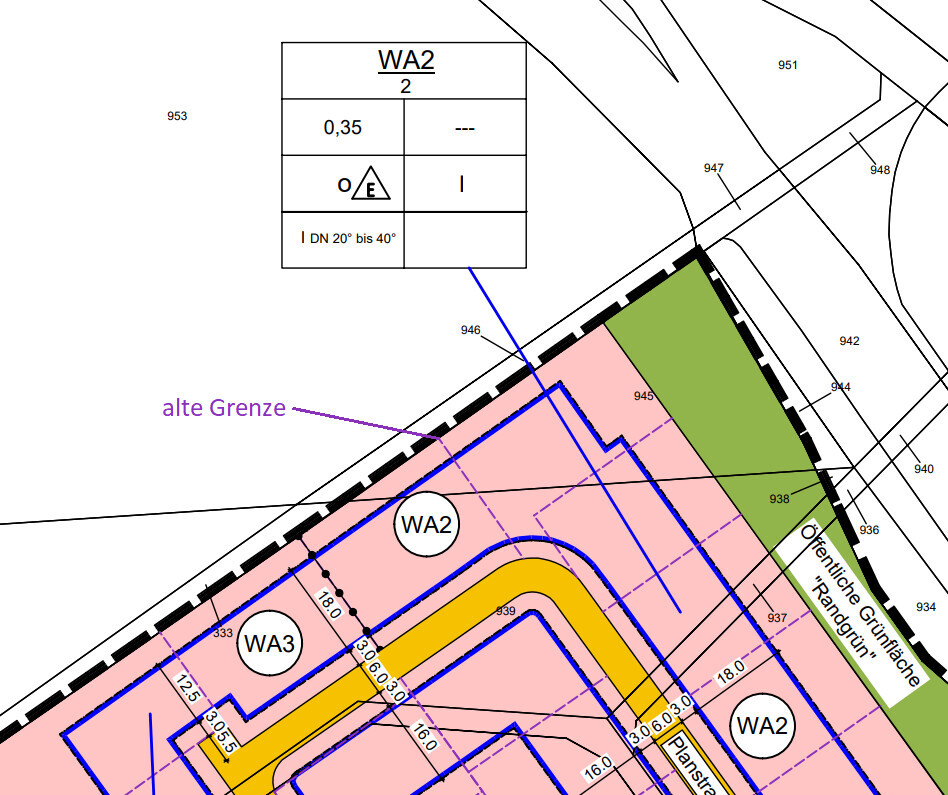

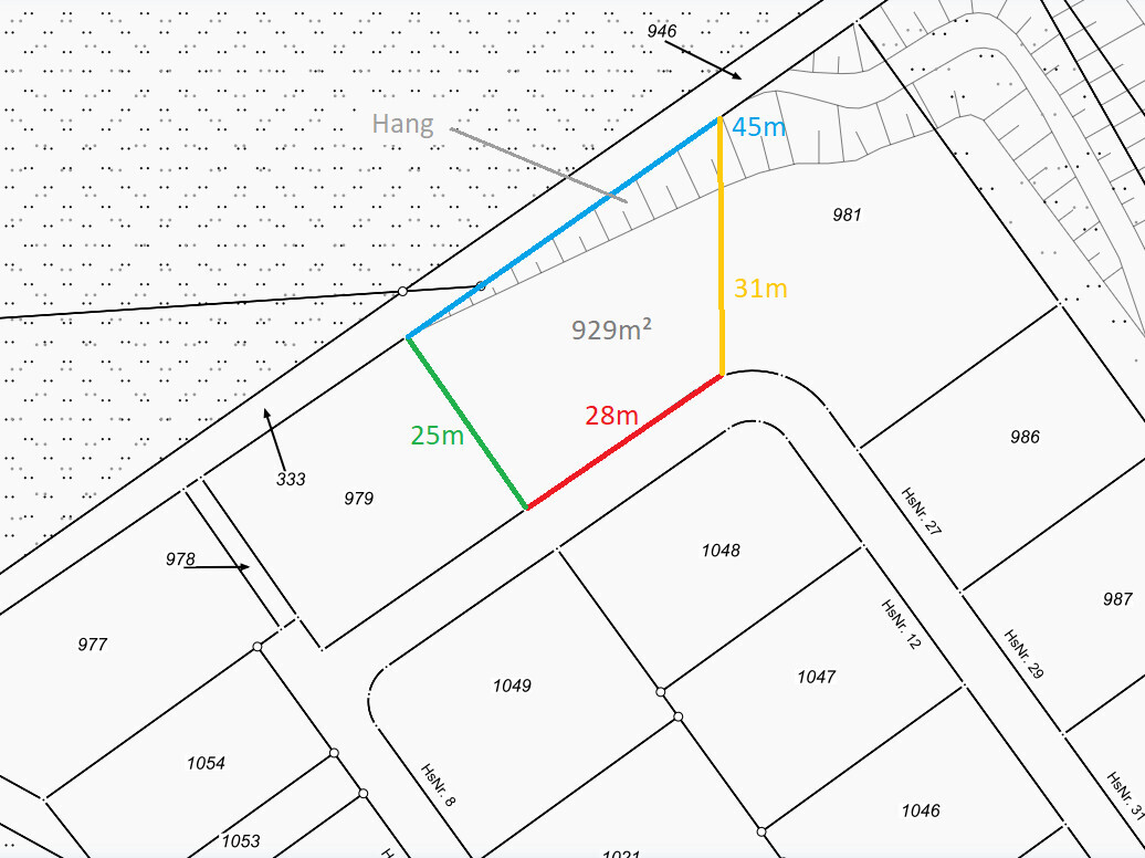

Unfortunately, only the original development plan from November 2019, available online, is currently available. The boundaries shown there do not match reality. Also, the document provided only limited information.

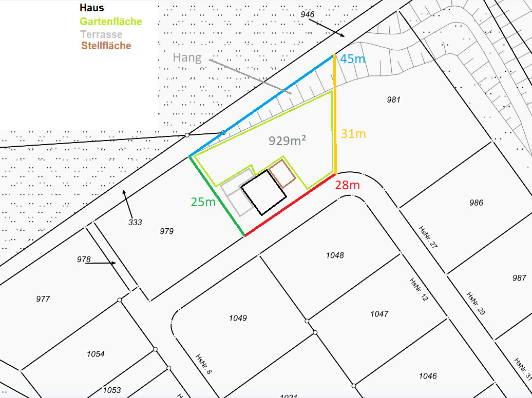

- Size of the plot - 929m² (in residential area WA2)
- Slope (see image)
- Slightly sloping down from the street toward north-northwest
- From the street toward north ending with a steep slope
- Slightly sloping down from the street toward northeast into the curve

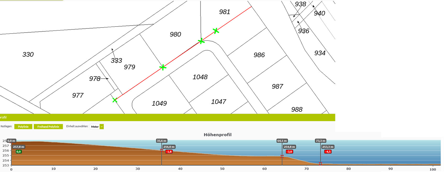

- We have already marked an area for a possible house location (~325m² according to the site coverage ratio). We tend to place the house as close as possible to the left neighboring plot. This is the highest point of the property. We would like to have sunlight for as long as possible after work. A terrace is planned on the west side (towards the left neighbor). On the right side of the house, a parking area for vehicles.

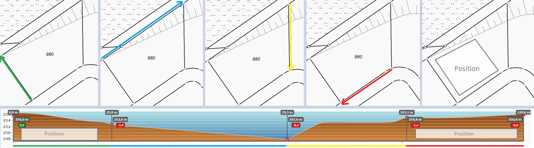

- Here again, a detailed view of the entire sloping street. The neighbor on the left (979) and neighbors below (1048 and 1049) are located higher. Could they possibly block sunlight?
- Site coverage ratio 0.35
- Floor area ratio ---
- Building envelope, building line and building boundary (see image above)

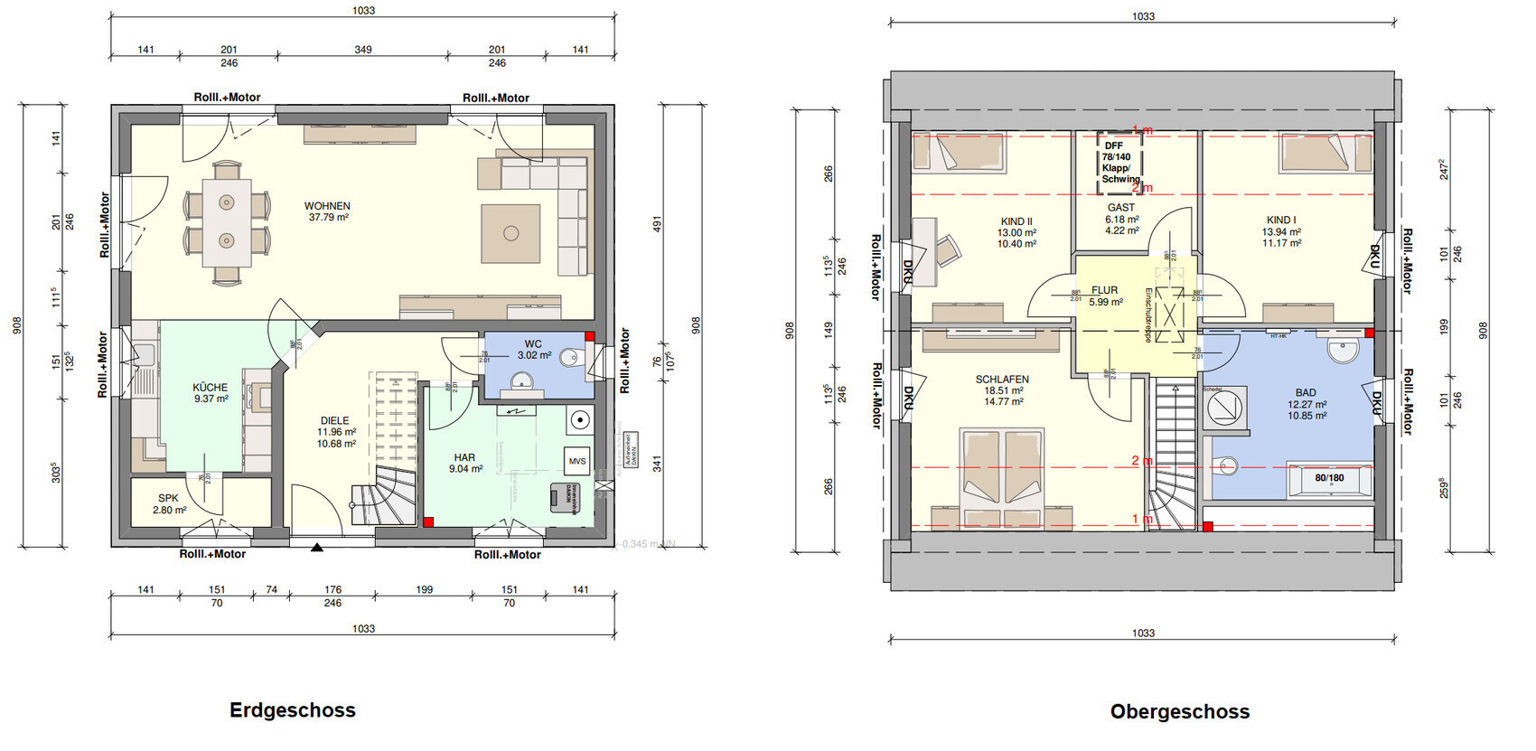

We already have offers from Heinz von Heiden and Kern-Haus. I have now attached the floor plans as well.

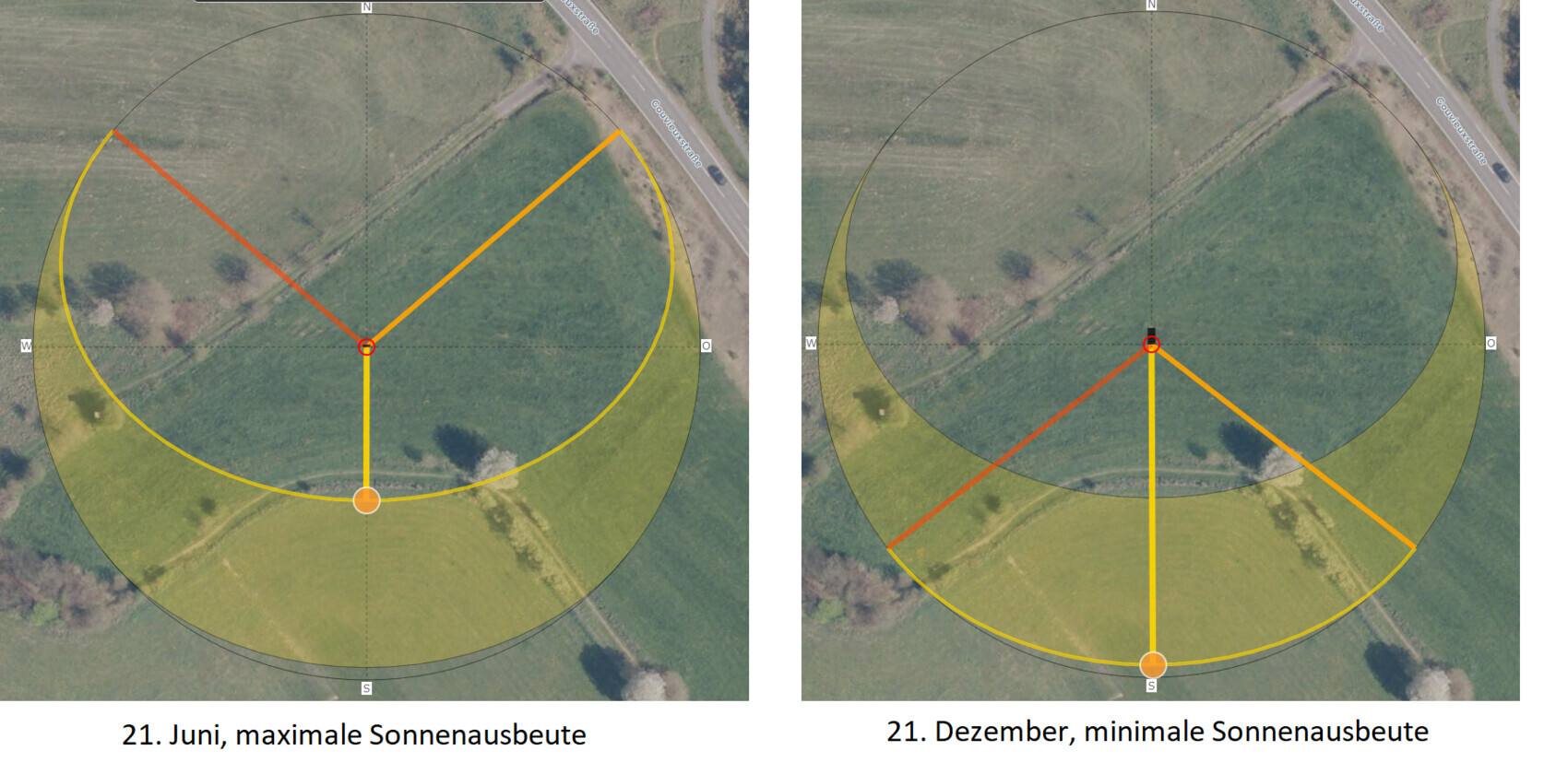

Where should the house and (which type of) parking spaces be “located”? Interpolating height profiles from the site boundaries is not only too much work for free but also only of limited value. I find it significantly more useful to know concrete elevation points in the terrain. It may be advisable to rotate the house axis aligned parallel to contour lines. Furthermore, it can generally be said that the more a slope is involved, a footprint close to a square shape is rather disadvantageous. Such a shape only ceases to be a problem as long as the “slope” is limited to the steepness feeling of @Pinkiponks’ husband 🙂

It is not unusual for development plans to be drawn up before the land consolidation is completed. If the plan has actually already been revised since then, it would be interesting to know the changes and their justification. Furthermore, I suspect you may have omitted the “textual provisions,” which are sometimes a separate document from the drawings. Please mention (without linking!) the name of the development plan.

Unfortunately, only the original development plan available online as of November 2019 is currently available. The boundaries do not correspond there. Also, I was only able to extract limited information from the document.

... and why are you planning your house in the southwest corner of the plot if you have already determined that the sun moves along that side?
Apparently, the yellow contour line indicates a leveled area suitable for building?
In my experience, even Heinz von Heiden would have to push close to the budget limit with a house of this size.
I personally think the floor plan is quite good. Unfortunately, the dimensions of the individual rooms are missing.
There are a few things I would change on the ground floor. I would leave out the pantry. It is so small that almost nothing fits in there. If you plan tall kitchen cabinets where the door is, you can probably store just as much in there as in the pantry.
I would possibly put the toilet where the pantry is. It would need to be slightly widened. The door to the toilet should then open from the hallway.
Where the toilet is now, you could either make a storage room or add the space to the utility room, which could also be used for storage. You don’t have much storage space otherwise.
I would move the door to the kitchen/living area to the straight wall opposite the front door and straighten the angled wall that currently has the door. This way, you can also extend the kitchen along the wall up to the corner.
Then rotate the dining table by 90 degrees.
