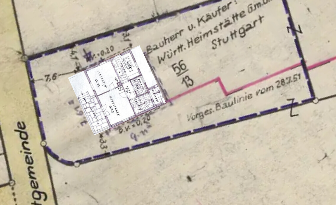

We have the opportunity to purchase a plot of land including a house. However, the existing house is in such a condition that it requires demolition. Our plan is to build a new, small single-family home with approximately 140 m² (1,507 sq ft) of living space. Since we would like to include a basement and the current house already has one, our options for positioning the new house are somewhat limited.
We have already received a first draft from a prefabricated house manufacturer. I have incorporated this floor plan into the site plan and made a rough layout of the outdoor areas. Now, I would like to gather your expert opinions on this design. In the near future, I also plan to contact a local construction company or architect to get another offer – possibly with a more concrete idea of the floor plan.

The floor plan largely meets our wishes on the ground floor: an entrance on the north side, an office overlooking the driveway, a kitchen with an adjoining pantry, and an open living and dining area. On the upper floor, there is the option to set up a second home office space if both of us need to work from home at the same time.
What do you dislike? Why?
The straight staircase looks appealing but unfortunately takes up a lot of space on the upper floor, making the children’s rooms quite small. Additionally, the office on the ground floor does not have room for a sofa bed. The arrangement of doors in the entrance area and the staircase access from the living and dining area to the upper floor are also not ideal with children.

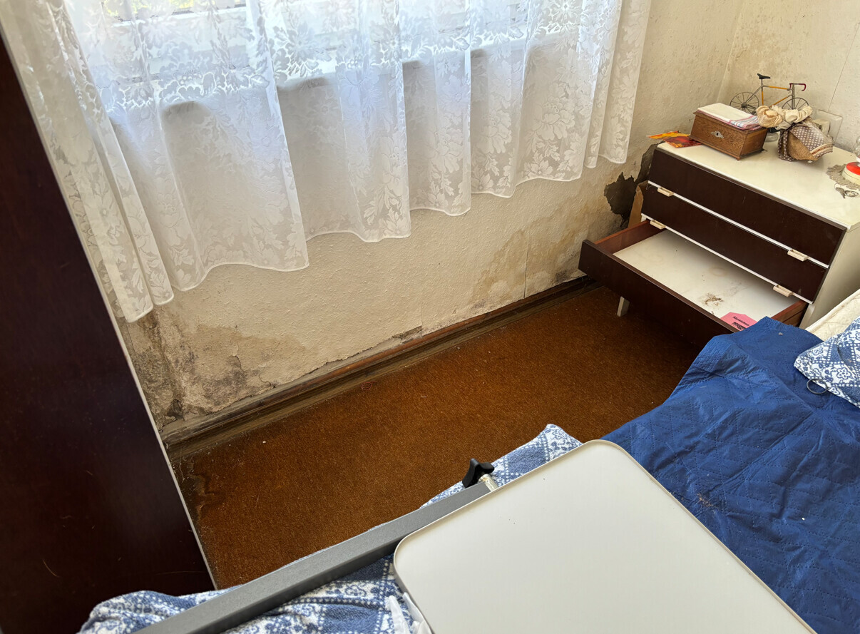

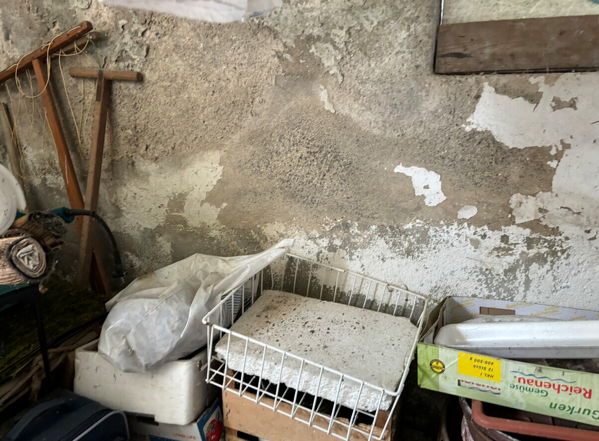

If the basement ceiling is that low and probably damp as well, you might as well just knock it down. If it's damp, then yes. Floor-to-ceiling height is 235cm (92 inches), so the room height is probably around 210cm (83 inches), which doesn’t really matter for the jam jars or anyone going down there. Apart from laughter, no one goes to the basement for any real enjoyment. The basement is a replacement for storage or utility space. You don’t put the trampoline in there, just store it.
Alright, I agree with the question, especially regarding the terrace and whether it actually exists. The vestibule would be removed, and the new entrance could be placed where the basement stairs currently come up.
There is no terrace. Later on, I will show all the views.
If it’s damp, then yes. Floor-to-ceiling height is 235cm (93 inches), so the room height is probably around 210cm (83 inches), which doesn’t matter to either the jam jars or whoever goes down there. Besides, nobody goes to the basement for anything enjoyable except to laugh. The basement is just a substitute for storage space. You don’t set up a trampoline there, just leave it stored.Unfortunately, the basement is damp, but I have some pictures of that shortly.

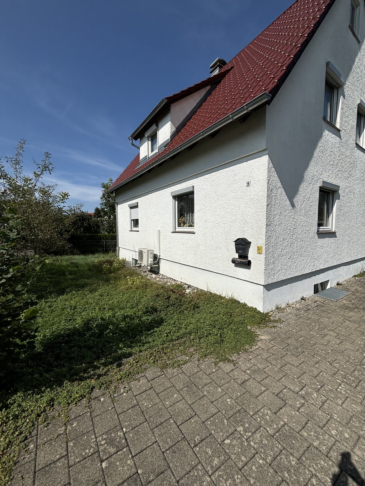

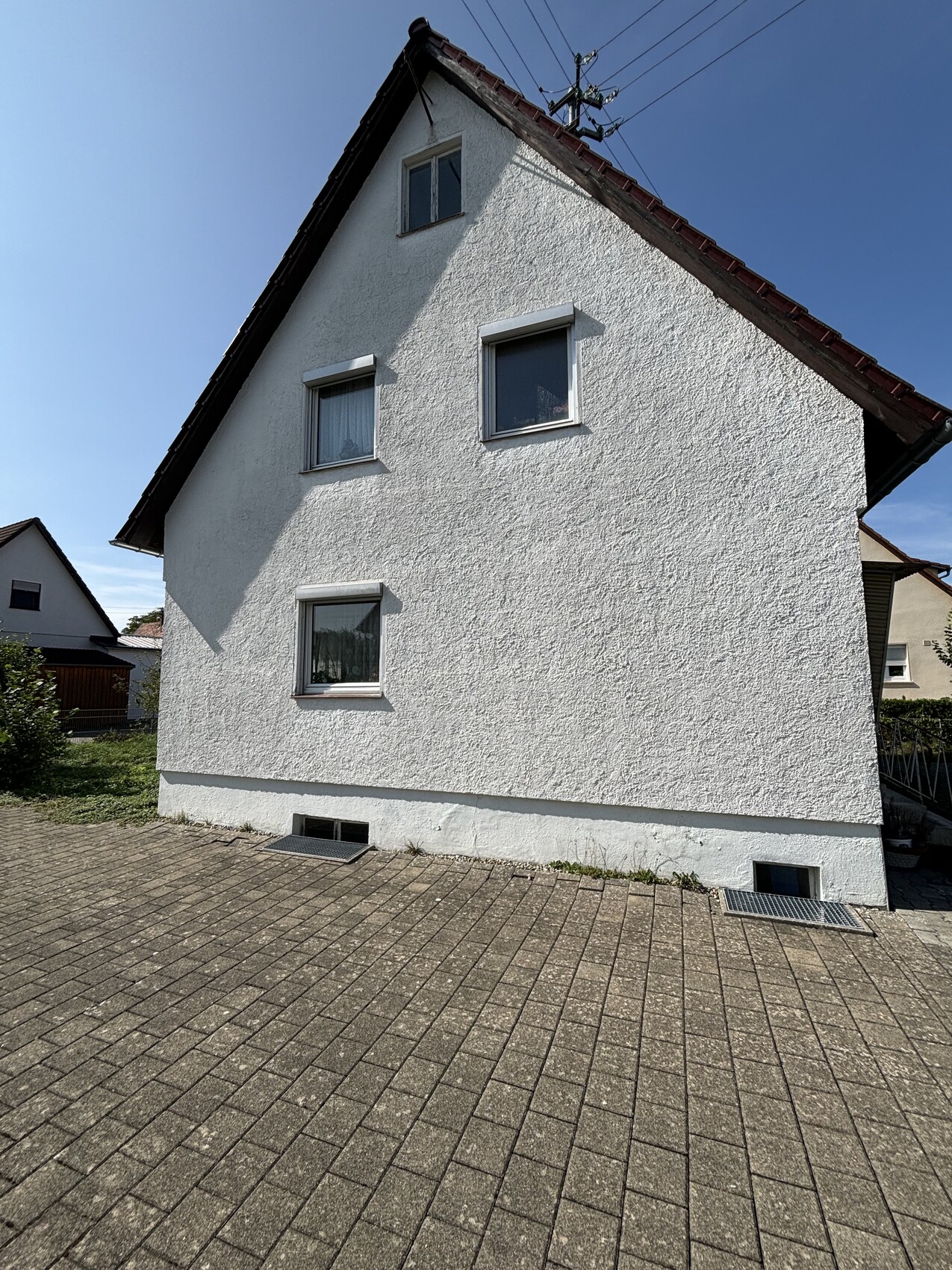

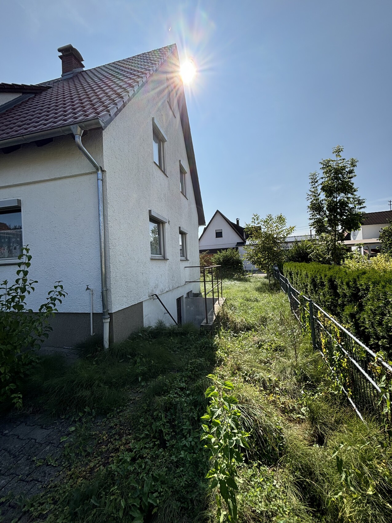

First, the exterior view (the facade is misleading)
Southwest side:
South side:
East side:
Northeast side:

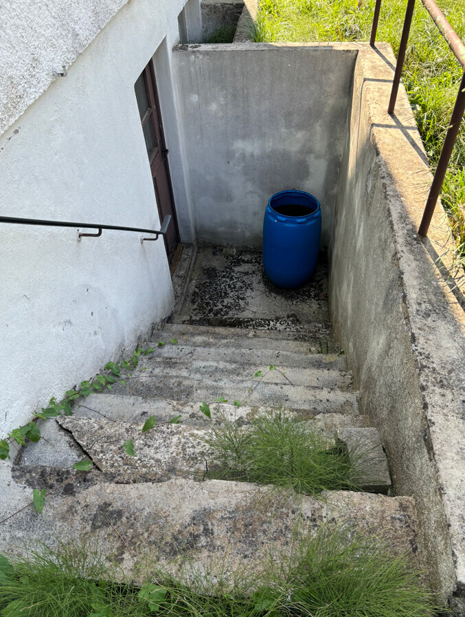

Basement stairs:
Basement floor:
Basement walls:
Interior walls:
Unfortunately, I won’t be able to finish my floor plan today, but given the current pace of the project, I’m already curious about the reactions to the pictures.
