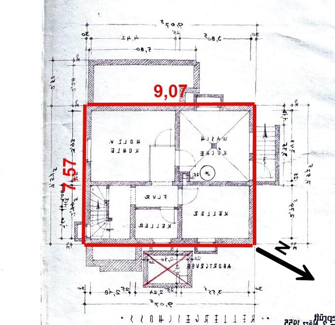

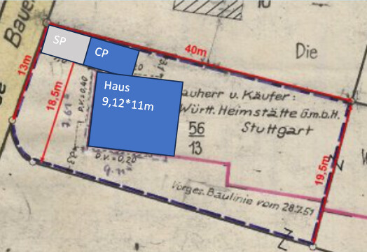

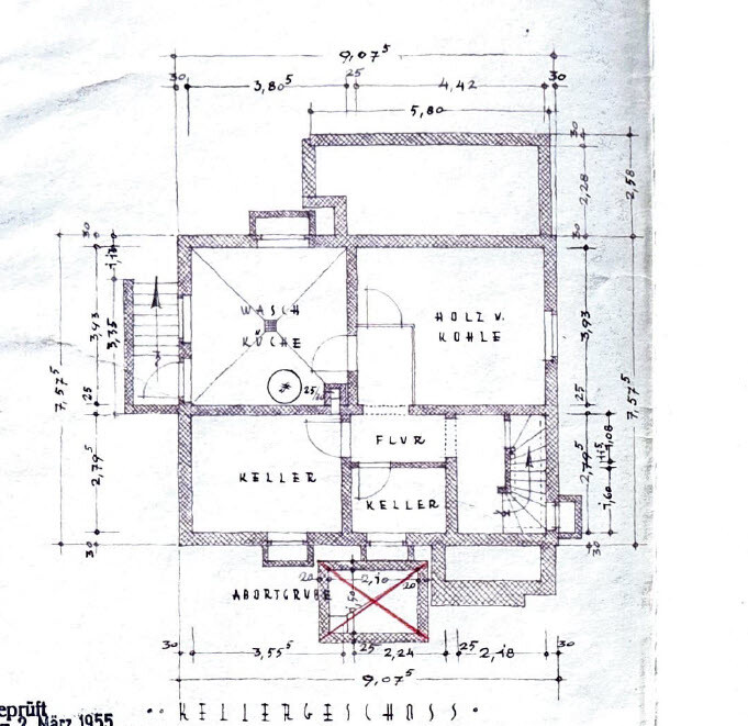

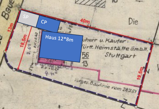

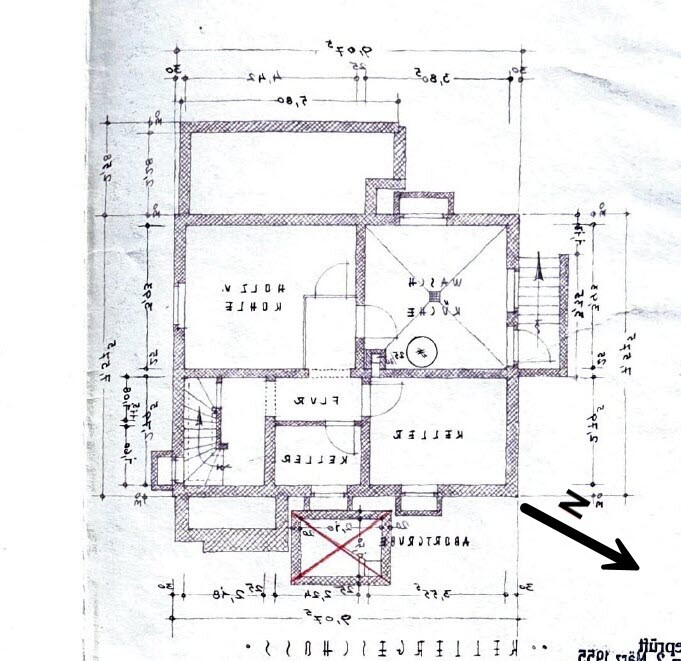

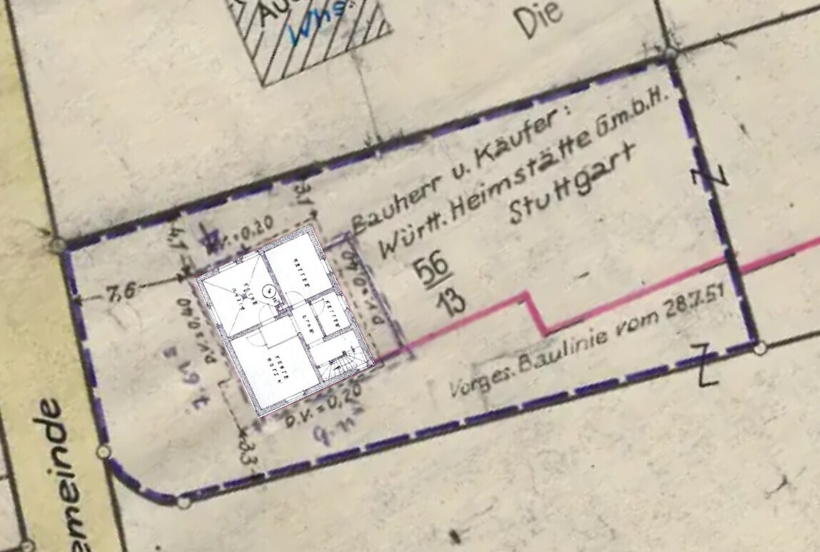

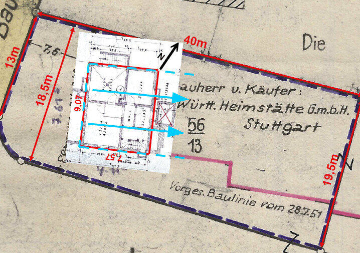

hanghaus2023 schrieb:
I hope I understood this correctly. Somehow the basement doesn’t really match the house. The plot is oriented roughly to the north.
From what I can tell, only the following was built.
Sorry, I could have mentioned this in the post above.
That’s clear. But if I want to keep the basement, the plans should be based on that. Demolishing and rebuilding the basement easily costs around 110,000 euros. That’s true, but we’ll probably have to accept the 100,000 euros. The basement is actually in poor condition.

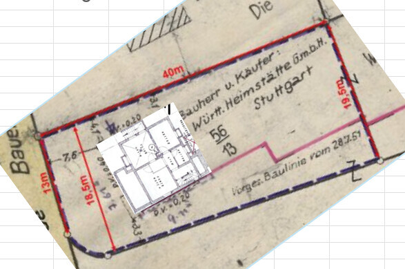

JP_2024 schrieb:
However, the house was strangely built as a mirror image. ... after the house was apparently rotated 90° compared to the site plan. I'm therefore unsure whether the pink marked area actually represents the house location.
Demolishing and rebuilding the basement easily costs 110k. So a lot of money saved by reusing it.
JP_2024 schrieb:
That’s true, but we’ll probably have to swallow the 100,000 €. The basement is basically in poor condition. A basement is a basement. It doesn’t need to look nice. And it’s large enough so it doesn’t have to be divided awkwardly.
Did @hanghaus2023 correctly estimate the placement on the lot?
Did @hanghaus2023 correctly estimate the positioning on the plot?This is how the basement/house is situated on the plot. So yes, the estimate was accurate.
The pink highlighted area is correct.
