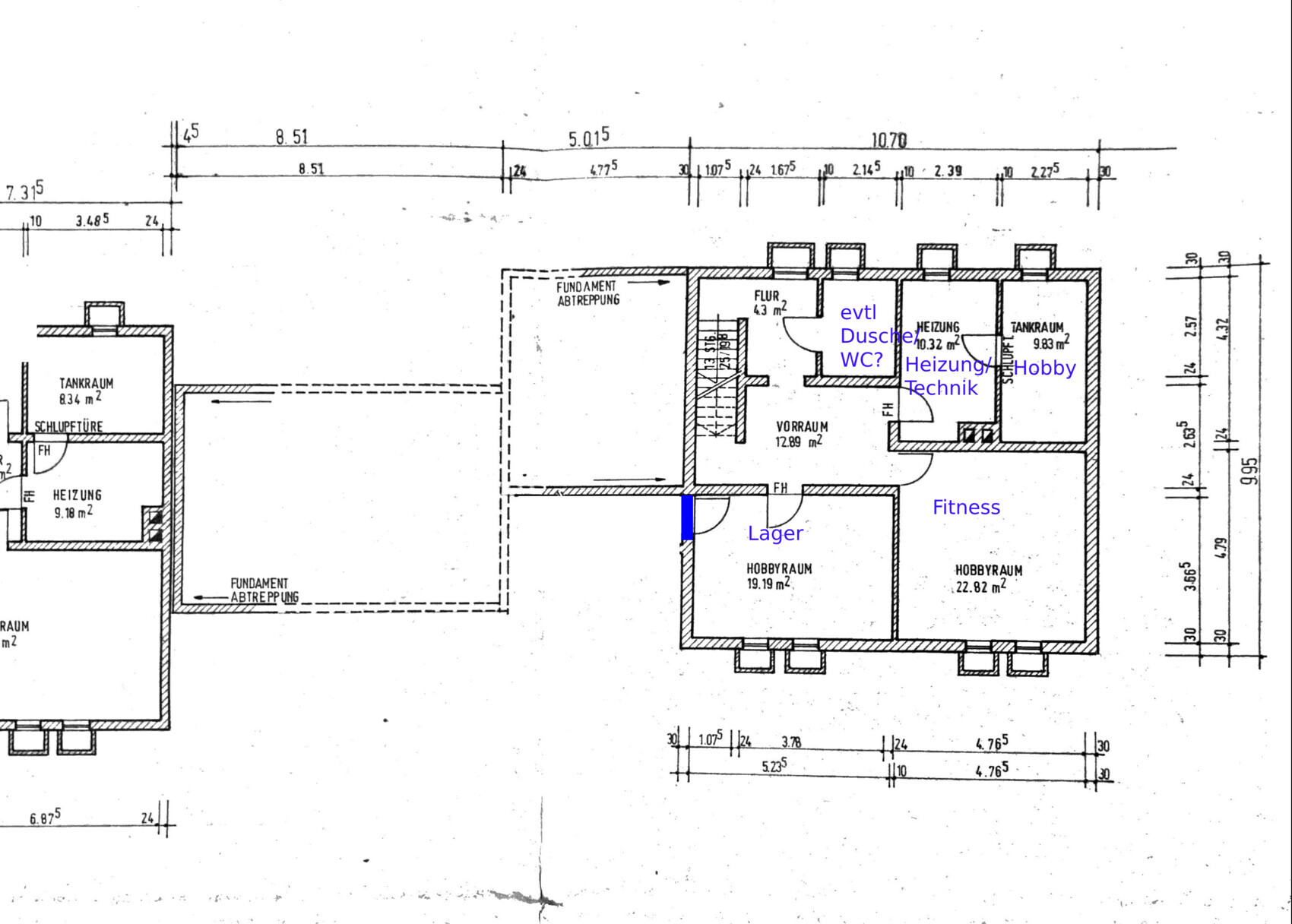

we are in the process of buying a single-family house with a large lot to gain more space than in our current home. The house was built in 1980 and is positioned exactly on the building boundary, currently including a garage. This garage is planned to be integrated into the living space, ideally also the terrace, to maximize the living area. There is another garage, but it is effectively too narrow for modern cars and will be converted into a workshop. Therefore, a carport must be planned as well. The building authority has already given indicative approval for this.
I will try to fill out the questionnaire as far as it is relevant for the renovation, to then present my current idea. I ask you for honest feedback—whether I can consider it is another matter. This is less about cost (unless something stands out that causes extreme additional expenses and could be done more economically), as we are aware that this will involve a substantial investment.

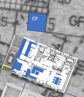

Number of parking spaces: 2, preferably 4 – carport possibly in the northeast corner? The driveway may not be used for this as it is not 5m (16 feet) from the street. Also, we like it as it is for riding Bobby cars, playing basketball, and guest parking.

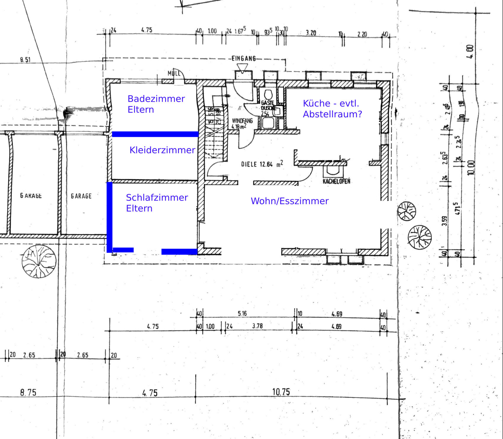

Currently I see one major problem: no wardrobe area is available, and I don’t yet see how or where it could be integrated...

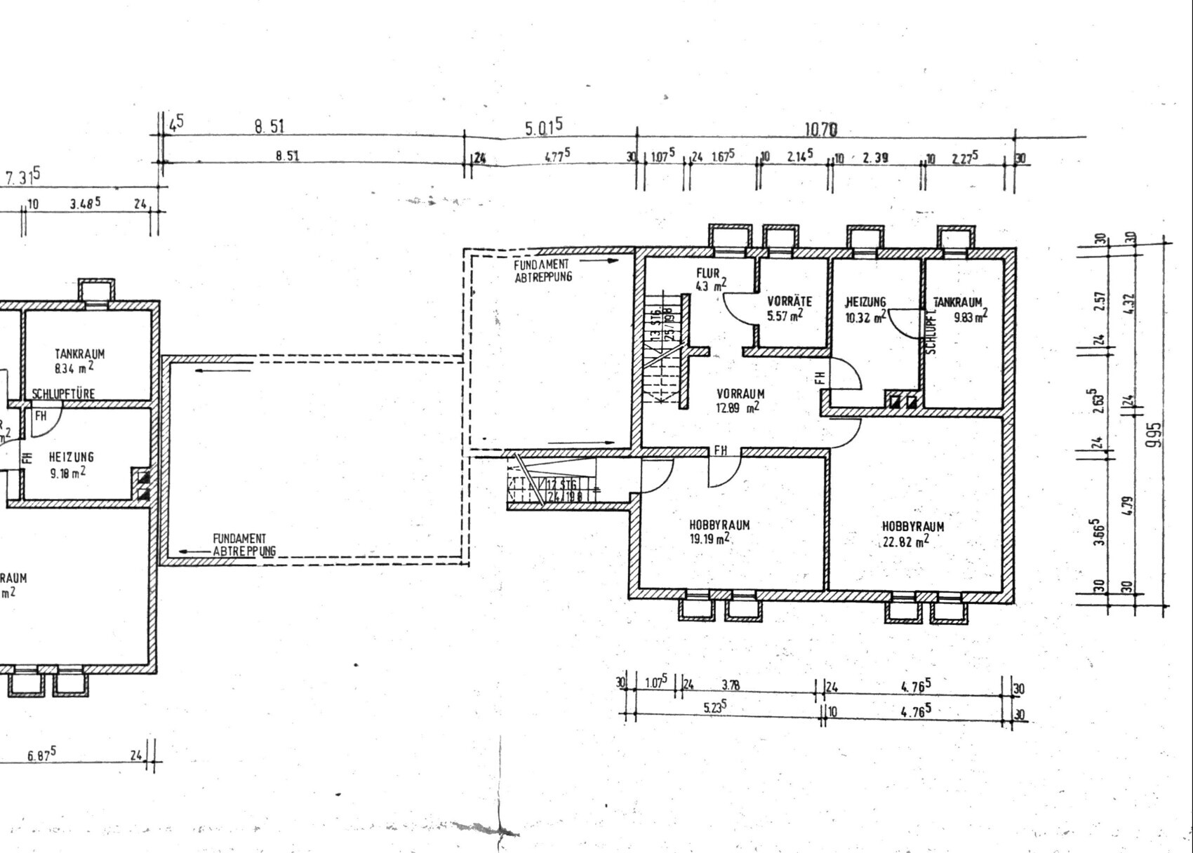

Note: In the basement, a hobby room is planned behind the utility room—where the oil tanks currently are, a gun room might be added if the cost makes sense. Otherwise, the two rooms will be swapped.

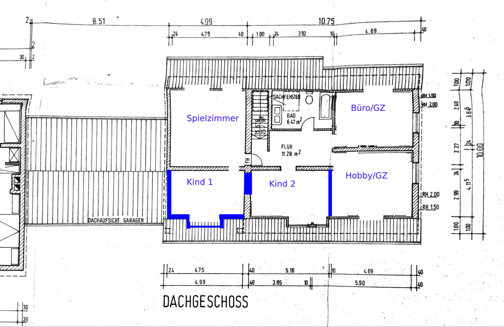

What do you like most? Why? Finding 2 small children’s rooms plus a playroom in the attic is great – then everything doesn’t always have to be tidied, and the Lego can stay set up.

A sensible room layout with minimal need to move walls. Does the layout make sense?
Attached are plans for the current condition of each floor, plus my designs and development plan.
Thank you very much for your input, and please don’t hold back on criticism – I have absolutely no idea what I’m doing here….

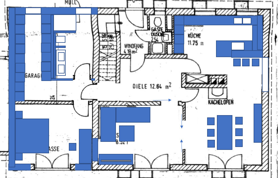

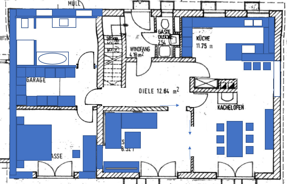

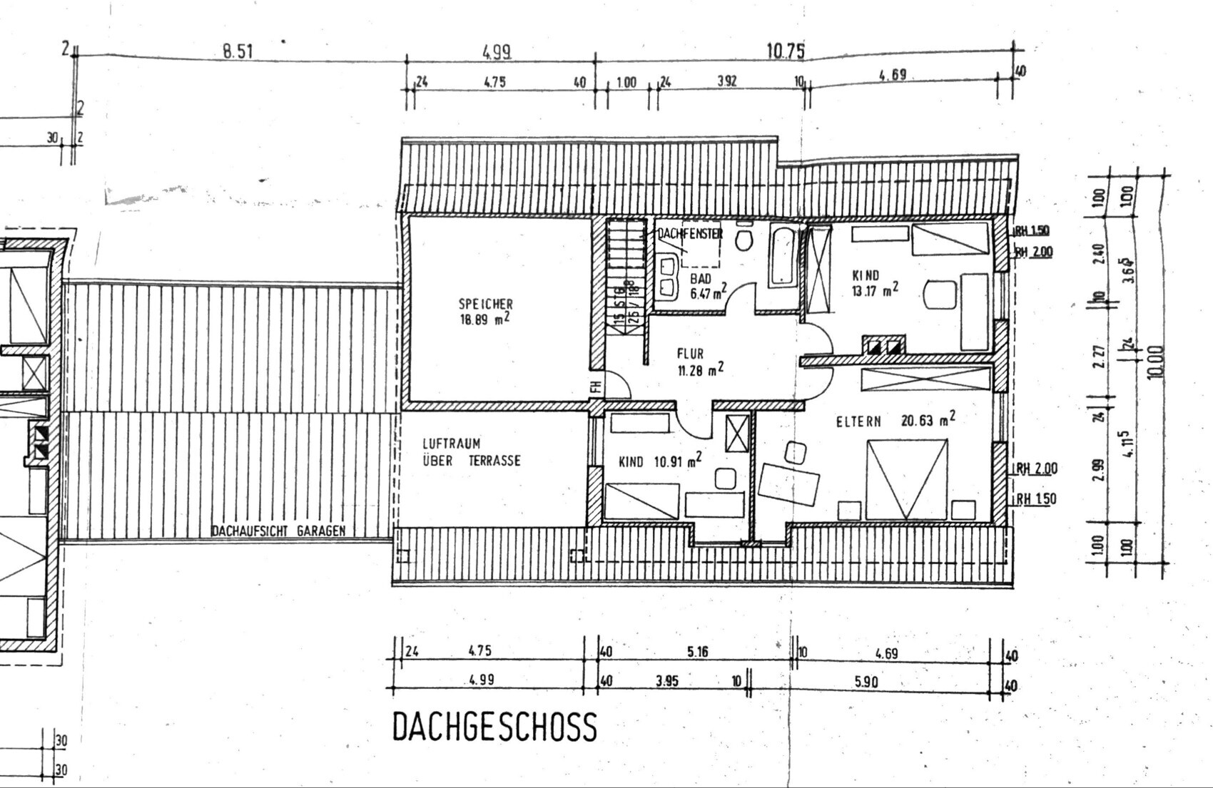

hanghaus202321 Jun 2023 19:24Somehow, I find myself here. Is the large dormer for Child 1 possible? What does the building authority say about it?
My original version (above) works of course, but I wouldn’t like it because there is no window in the walk-in closet.
With your design, the advantage of not disturbing the partner in the bedroom (if that matters) is lost.

hausbau_phobos21 Jun 2023 19:29Sure, you’re absolutely right—the door should be where you placed it, not from the living room into the bedroom! Somehow I forgot about that; on paper, I drew it that way.
In your version, I think the bathroom is too small. I’d prefer no natural light in the walk-in closet in exchange for a larger bathroom.
The building authority hasn’t said anything yet, or rather, I haven’t asked them yet. It’s also not drawn to scale 🙂 I just planned it to be as large as possible.
However, the issue with the wardrobe still bothers me a lot.
