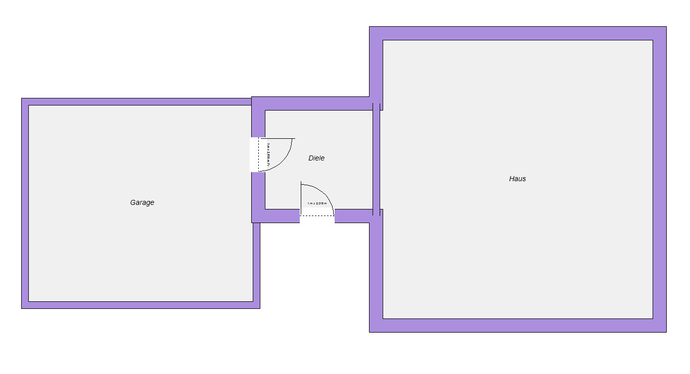

Let me emphasize this again. A small house means you have to use every centimeter. The utility room will already be too small.
Having two entrances is a luxury that even bigger houses often don’t have. Also, it doesn’t make sense. If you always enter through B, then A is unnecessary because it becomes pointless. Why carry shoes and jackets back and forth between A and B all the time?
If you really want to enter through the garage and stay dry, place the entrance there. Something like this would work, for example (regardless of the rest of the planning):
