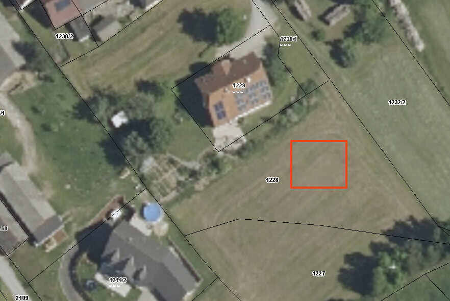

oadna471115 Oct 2024 15:32We are located in a rather rural area. The surrounding buildings all have pitched roofs.

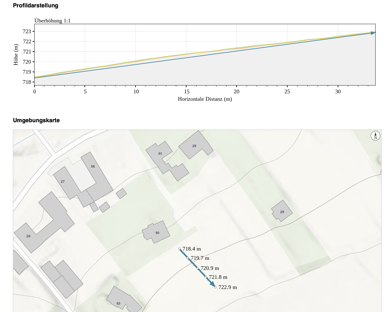

Our plot is 1228. I would like to build approximately where the red frame is shown. The plot still needs to be surveyed and will then be reduced in size. The driveway will be accessed via 1230/1.
North is at the top of the image. Unfortunately, I don't have a plan with elevation details, but I have attached an elevation profile. I hope this helps a bit with orientation.
This plateau does not exist yet. However, I would like to create one here to design a garden.
House 1229 belongs to my parents.

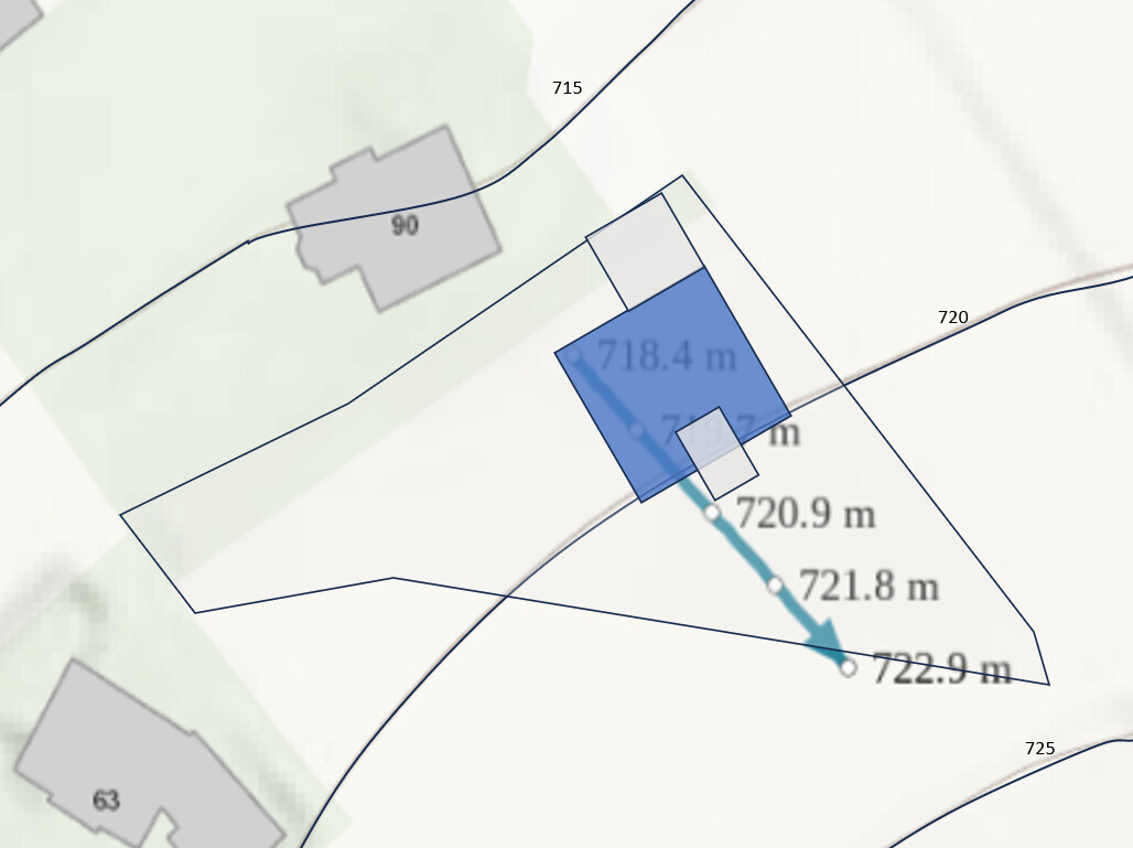

hanghaus202315 Oct 2024 18:19Thanks for the excerpts from the plans.
Does the terrain slope towards the northwest?
Is it mandatory in Austria to integrate the garage into the house?
We recently had someone from Austria who mentioned the same thing.
Here is a rough compilation.
Just saying, your parents somehow built better with the slope. In my opinion, you should do the same. @11ant North is at the top.
