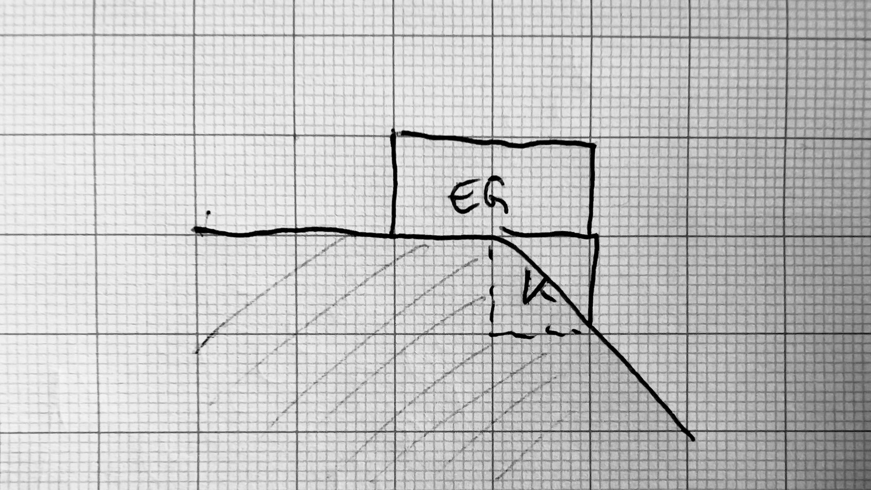

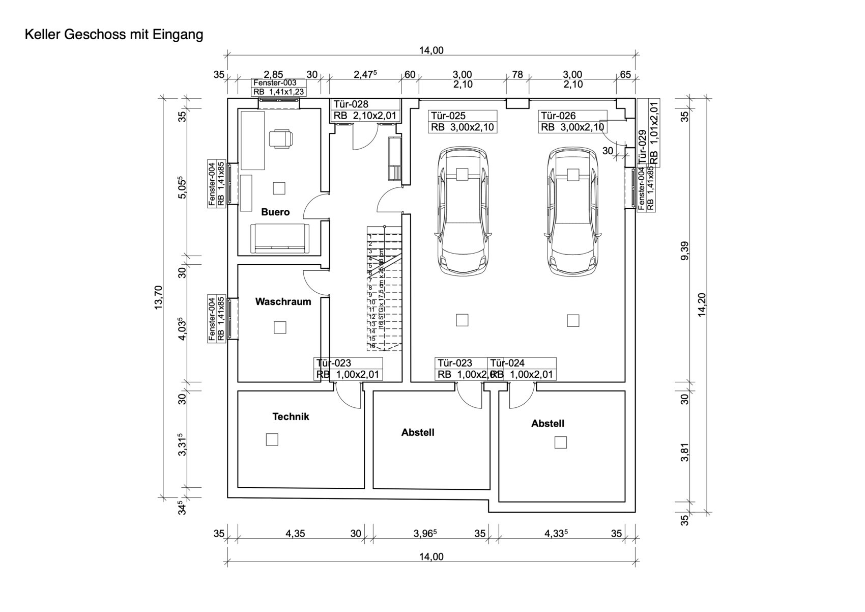

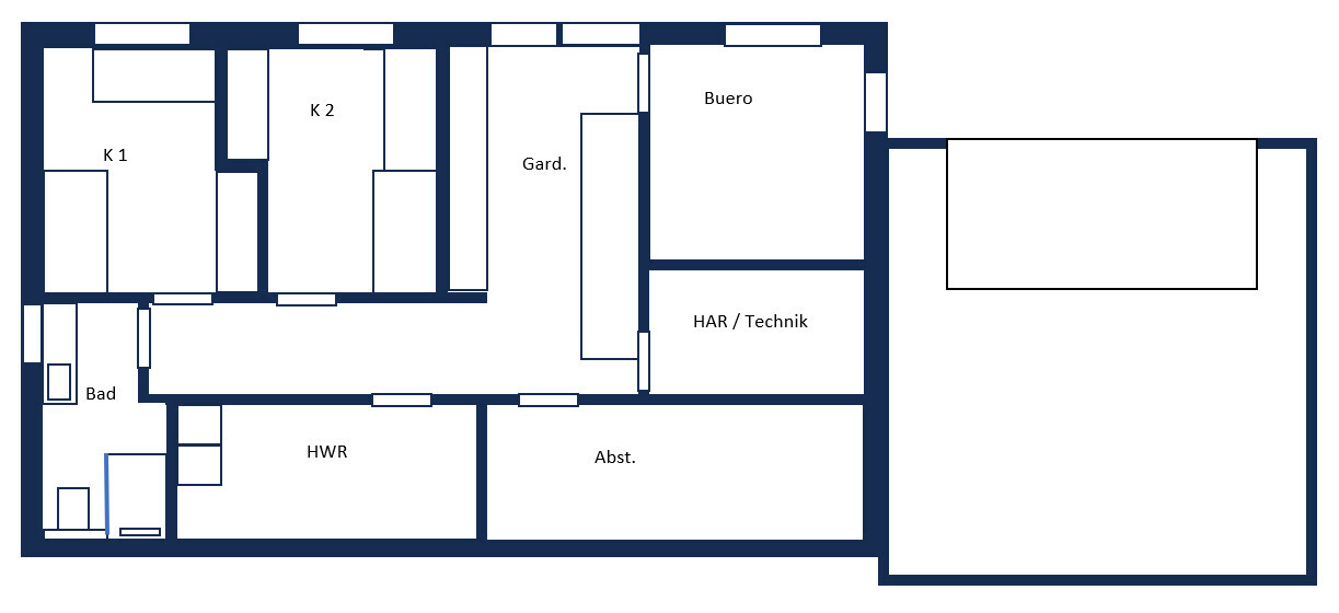

hanghaus202316 Oct 2024 13:20Is the site already connected to the necessary infrastructure?
hanghaus2023 schrieb:
@11ant but the plan shows north.I meant the house plan.oadna4711 schrieb:
Not that I know of. I integrated the garage into the house because I need the basement anyway to balance out the slope and to have direct, level access onto the terrace.
Theoretically, I could make a flat roof with a terrace on top of the garage. But I’m a bit hesitant about flat roofs.I can’t see what the garage would have against a flat roof. If I understand correctly, you mainly liked that in the Hartl show home, the TV seating area is separated “around the corner” from the kitchen area. However, a U-shaped semi-atrium bungalow is already not suitable for the budget-conscious among home savers even on a flat plot. Now you are indulging in two more luxuries by combining the elevation on a recessed basement to adapt the dream house to a sloped lot *and* increasing the living area by about forty percent instead of choosing one or the other. Therefore, I share the likely conclusion of your price inquiries and suggest that you kindly review how many of your dream house’s priority features can be achieved in an exterior shape that better fits the terrain. Maybe @ypg can come up with something nice, as the lot would suit a split-level house. The footprint of the show home is already a burden without scaling up the dimensions further, even though the width of the lot—if it weren’t for the slope—invites living extensively on one level.
oadna4711 schrieb:
I like the idea of having only two levels so that in old age I can drive behind the house and enter it at ground level.By omitting the uphill entrance?https://www.instagram.com/11antgmxde/
hanghaus202316 Oct 2024 13:40hanghaus2023 schrieb:
Unfortunately, the driveway won’t work then.What exactly wouldn’t be possible there? hanghaus2023 schrieb:
In which federal state is the building taking place?Are you familiar with several regional building codes in Austria? I don’t know a single one.https://www.instagram.com/11antgmxde/
oadna4711 schrieb:
Plot 1227 is family-owned but not designated as buildable land, meaning it is a meadow and is only accessed by agricultural vehicles. The first thing to check would be whether you are actually allowed to build on the meadow.
I would definitely remove the garage from the plan. On the one hand, it’s not financially feasible, and on the other, there are issues related to thermodynamics.
You can build a half-basement with an upper floor. For the cost calculation, you should include the basement/lower ground floor since it will be finished living space. I don’t see a full basement as financially viable.
hanghaus202316 Oct 2024 14:53ypg schrieb:
First, you would need to check whether building is even permitted on the meadow.
The inquiry referred to the neighboring plot to the south. The 1228 should be designated as building land. 11ant schrieb:
What exactly wouldn’t fit there?My proposal places the garage in the way.
Are you familiar with several state building codes in AT (Austria)? I don’t know a single one.Neither do I. I just wanted to know roughly where that is.Similar topics
