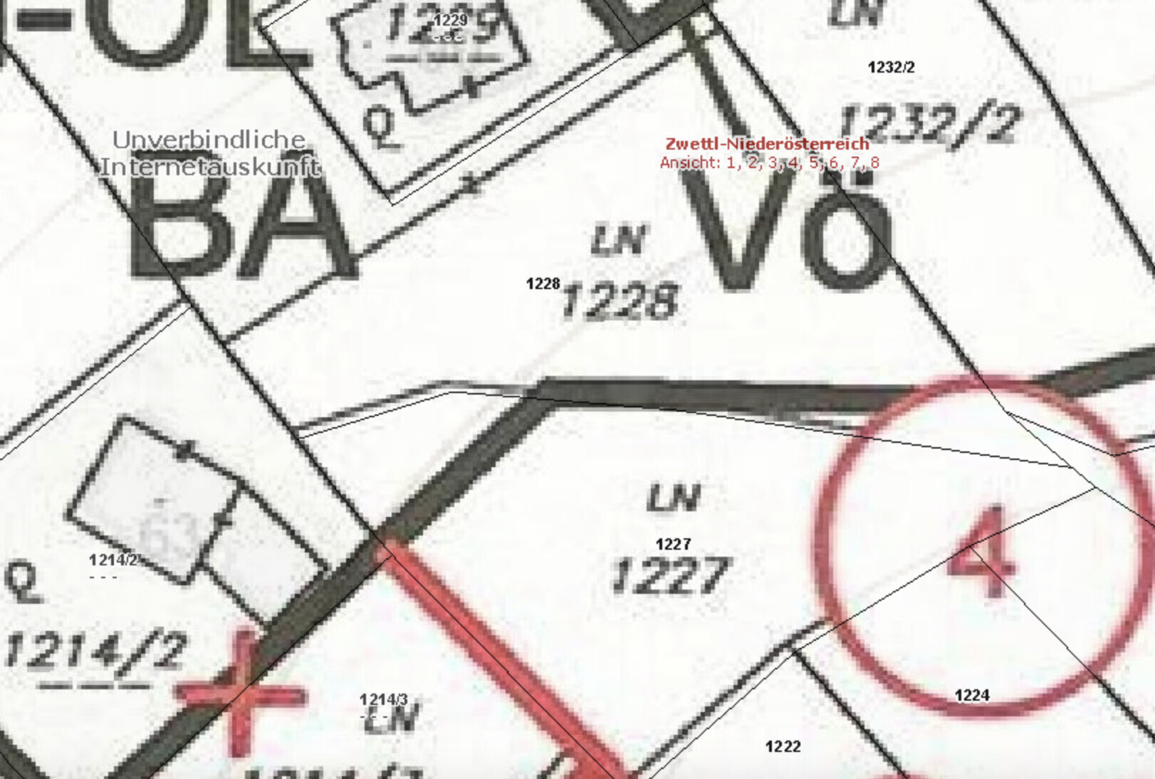

The inquiry concerned the neighboring plot to the south. Plot 1228 should be designated as building land.
Yes, exactly, 1228 is building land. The building line is clearly marked here.
Section of a cadastral map: Plot 4 marked in red, LN 1227/1228, Zwettl-Lower Austria.
11ant16 Oct 2024 15:32
hanghaus2023 schrieb:
My proposal places the garage in the way.
Oh, I meant the driveway to the garage itself. In my opinion, you don’t need to drive behind it.
oadna4711 schrieb:
1228 is within the building zone. The building line is marked prominently here.
What does "building line" mean in your area? (For us, it’s a building boundary up to which you must build.)
I see two thick lines, one black and one red. You’ve apparently selected several layers to display at once in the online cadastral map, which makes it hard to read here.
Oh, I guess it probably marks the border between the inner and outer development zones.
oadna4711 schrieb:
Lower Austria. To be honest, I’m not familiar with any regional building regulations in Austria either.
But you surely have some. Nothing makes states happier than their own separate sets of rules.
O
oadna4711
16 Oct 2024 15:40
Oh, I was referring to the garage driveway itself. In my opinion, you don’t need to drive beyond that point.
What does "building line" mean for you? (For us, it’s a building boundary that you have to build up to.)
I see two thick lines, one black and one red. You’ve apparently selected to display multiple layers at once in the online cadastre, which makes it hard to interpret here.
Oh, right—probably the boundary between the inner and outer development areas is meant.
But I’m sure you have your own rules too. Nothing gives federal states more pleasure than making their own plans.
The official from the municipality mentioned that no land is being developed beyond this line in my village.
I’ll have to look up these building regulations. They’re probably written in technical language that’s hard for laypeople to understand.
