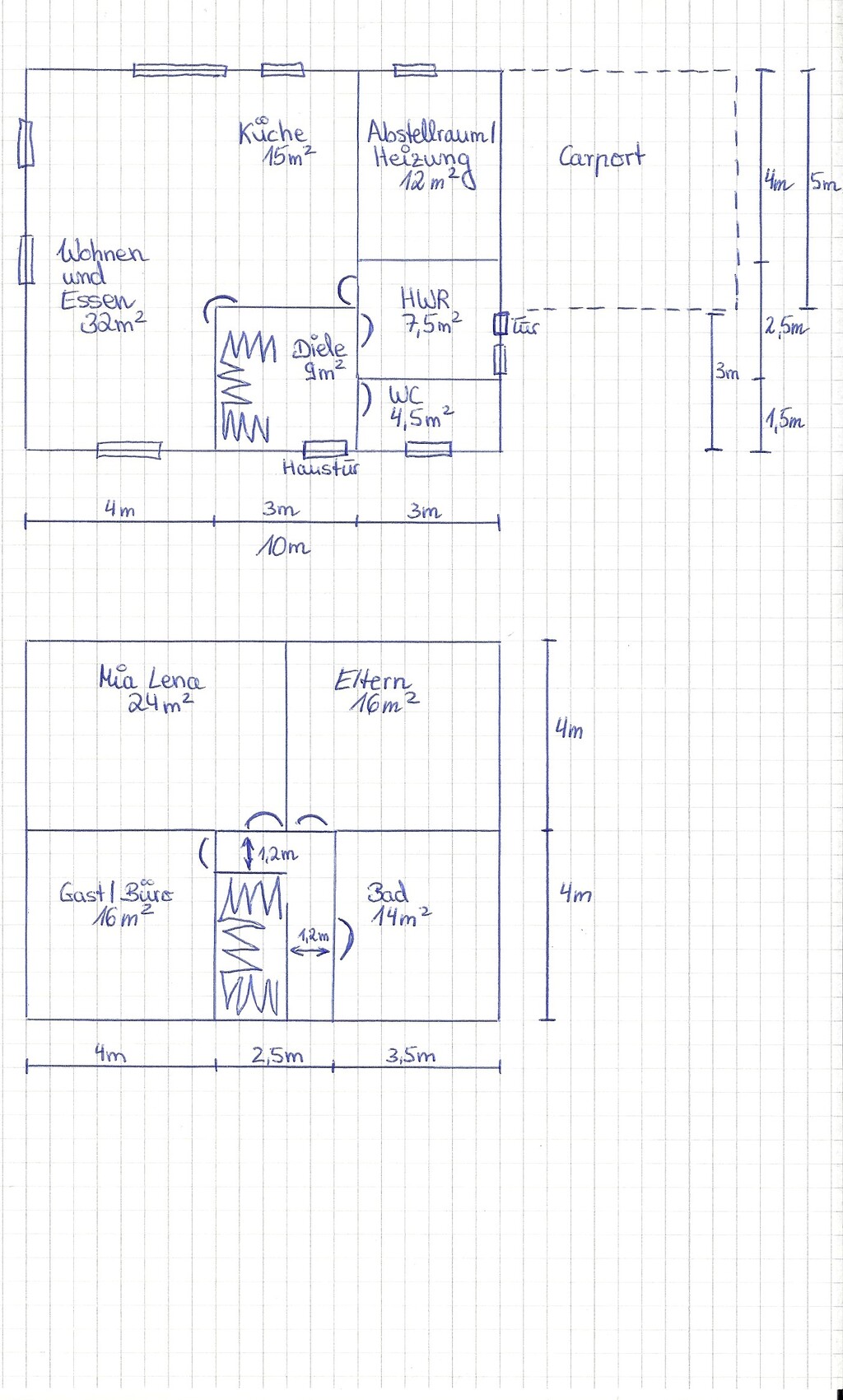

M.Dreising27 Mar 2015 21:25Line drawings are generally unsuitable for floor plans because they do not take wall thicknesses into account. Your floor plan will result in exterior dimensions of 11 x 9 m (36 x 30 ft).
Your staircase, measuring 280 x 120 cm (110 x 47 inches), will function very poorly.
Additionally, many details are missing, such as the orientation, number of storeys, possible knee wall height in the upper floor, and a site plan of the property.
I find line drawings ideal for the initial brainstorming phase.
Overall, it’s a standard floor plan.
I think there is a lack of a wardrobe and space in the entrance hall, and I would prefer to combine the storage room with the utility room.
Maybe move the staircase away from the front door, or where is the access?
I haven’t quite understood the doors yet, but with this floor plan, they are not very flexible anyway.
Is it still planned for just one child?

I find line drawings ideal for the initial idea development.For the initial idea development, a simple sketch is sufficient, which then becomes more detailed step by step.
However, following the process of @M.Dreising, there is already a standard house model or offer that this sketch is based on, so only fine adjustments need to be made.
For that, a line drawing is not enough!

M.Dreising28 Mar 2015 09:35Thanks to everyone,
this is just an approximate floor plan – I’m not sure if it’s actually feasible.
How much space should I allow for a half-turn staircase?
It should be suitable for one child.
ypg: of course, I have already read other reports!
Yes, we have already received a quote. There, we only provided this "line drawing" and have not received any other drawings yet – they would require an upfront payment of 500 euros, which would be refunded if a contract is signed, or else we would have to sign the contract first.
The offer is for a 154 sqm (1,658 sq ft) house with approximate external dimensions of 9 x 11 m (30 x 36 ft), which we can then design ourselves.
I can only sketch it roughly by hand and cannot create a graphic representation.
The question is whether the room layout is realistic and feasible, or if something could be improved.
The exact room sizes do not yet match the total square meters. We are currently exploring the layout.
For example, I didn’t know about the staircase space requirements and will now plan it differently.
