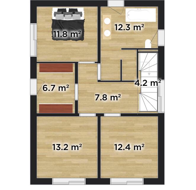

Who made the design: architect based on our initial PowerPoint sketches
What do you particularly like? Why? – We like the visual axes, from the staircase through the kitchen to the garden and from the hallway past the fireplace into the garden. A generous entrance area is important to avoid future frustration when entering the house and not knowing where to put groceries.
What don’t you like? Why? – The bedroom-walk-in closet situation is tight. We have thought and struggled with this a lot. Maybe we can expand the house by 50 cm (20 inches) to the south. Then a 1.5 m (59 inch) wide walk-in closet would fit.

Well, what a client doesn’t consider a problem isn’t necessarily something an architect should ignore.
You’re presenting him with ideas based on “not a big deal” or “little knowledge,” and his role is to explain why these might not work and then improve them.
The usage plan seems rather forced now, without wanting to suggest that you don’t know what you want or need.

Without knowing the exact dimensions of the plot and assuming the ridge direction is flexible: I would orient the narrow side of the house to the south or build a square plan. I’m not exactly sure because I rarely design houses with closed kitchens. In this case, orientation and plot size are a bit more challenging. I would pull the garage forward and place it in that corner. Behind the garage, I would put the workshop/storage room and create a connection to the utility room here. As I said: I would focus more on living, daytime activities, and staying areas than overemphasizing the basement and trying to make it better than it is. I would rather prepare an attic for nice-to-have items.
The kitchen could have a southeast corner window, the dining area enough space to move around it, and a cozier lounge corner. The landing staircase doesn’t fit the current house dimensions and is more a staircase type for larger homes. It dominates both floors because of its bulk. It takes up almost 3 meters (10 feet) in depth. With 8 meters (26 feet) of width, there isn’t much left for “room.”
The upper floor probably can be adapted to your needs, but not with these house dimensions.
Here’s an example of an upper floor with a less dominant staircase, a building footprint of 8 x 11 meters (26 x 36 feet): bedrooms (or offices) facing south, spacious dressing room and bathroom (originally with a sauna, but here I just sketched a walk-in shower).
Without children, I would plan more freely than within a family-home framework.
As I said, going to the architect with the plan was a learning experience. The completed questionnaire wasn’t intended to be completely comprehensive. We had already considered a room program early on, but I didn’t copy it here exactly.
Thanks for the quick draft. The dressing room between two rooms on the longer side of the house definitely makes sense. We will reconsider this idea!

Originally, the main request here was indeed to improve the walk-in closet and the T-layout. However, we appreciate any input provided. We recognize much of it.
