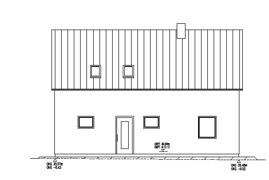

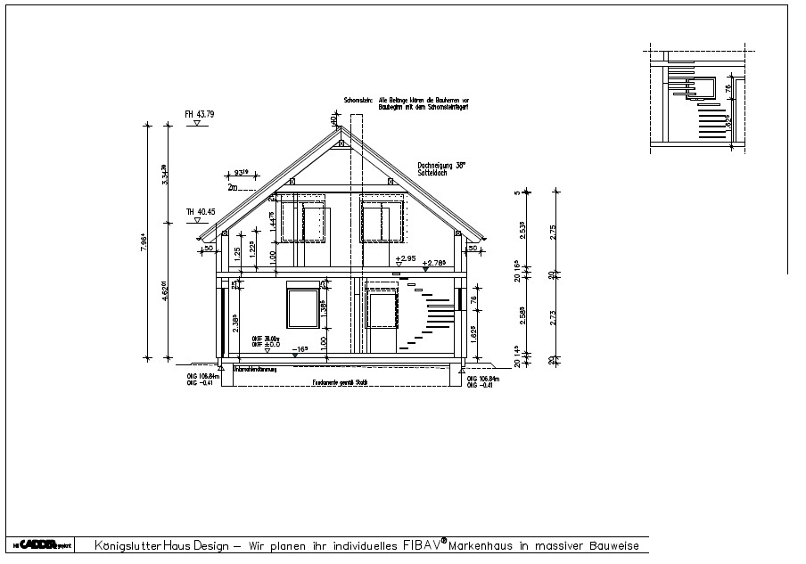

The architect’s drawings for our house are mostly finished, but the window in the entrance hall on the ground floor is still causing me some headaches. The architect sent us a cross-section and interior view, where it looks like at least one step will run directly in front of the window. This probably won’t look very good from inside or outside. The window is currently centered between the front door and the interior wall, with about 62 cm (25 inches) distance on each side.
I’d prefer not to make the window narrower, since the bathroom window is the same size, and it would mean introducing a new window size on that side of the house. Another option could be to shift it toward the front door by around 25-30 cm (10-12 inches), but then it would be quite close to the door—would that still look good from outside? Maybe you have a great idea.
Attached are the elevation of the house side and the cross-section with the interior view.

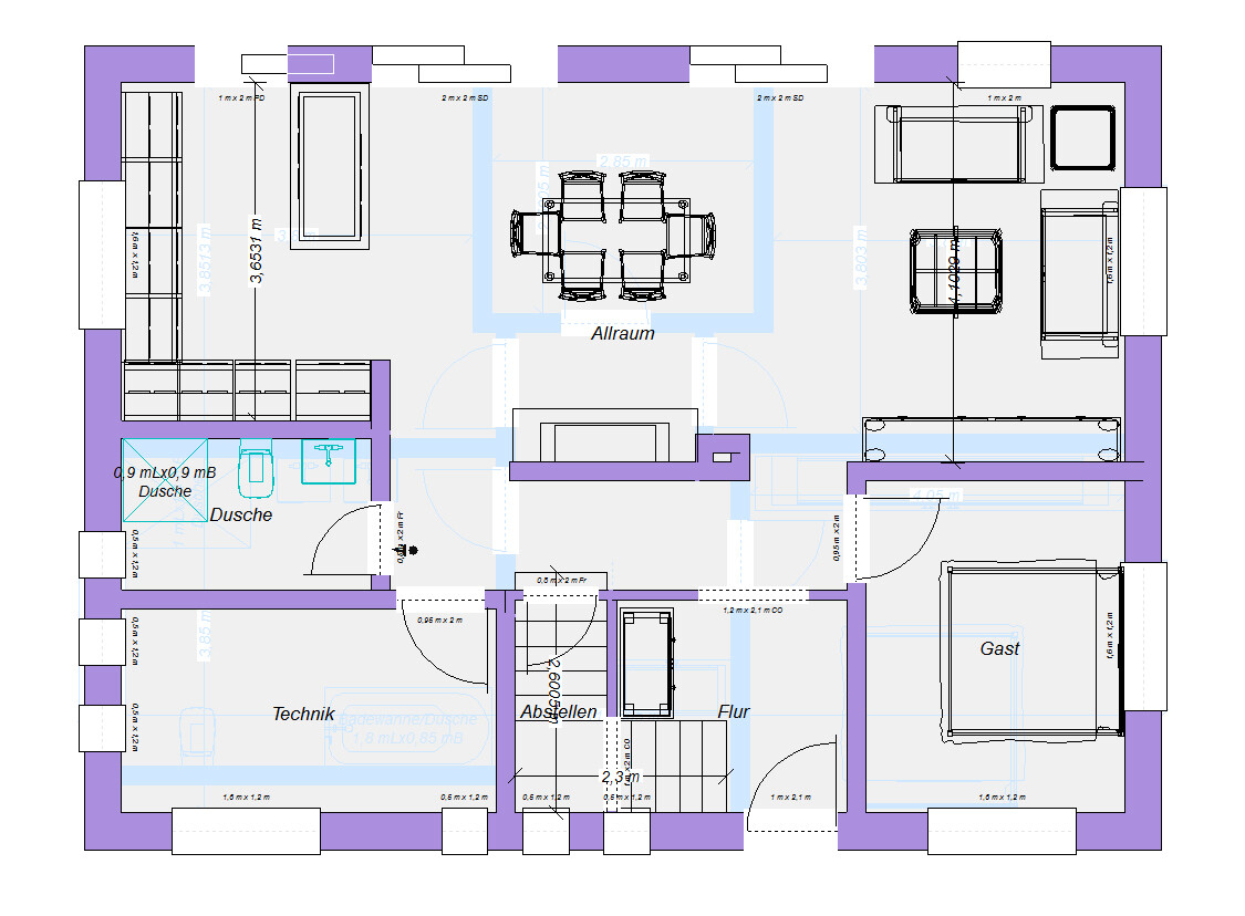

11ant6 Jun 2018 15:12
chrisw81 schrieb:
where it looks like at least one step runs directly in front of the window.
The floor plan from your post #273 indicates that the step marked with a dot in the attached image will be at the height of the window sill.
So: "all clear," I would say.

chrisw81
6 Jun 2018 16:00
The floor plan from your post #273 suggests that the step marked with a dot in the attached image will be at the same height as the windowsill.
If I count from the bottom up, the step marked with the red dot is the 9th. It is located both in the section view and in the interior view directly in front of the window and not at the height of the windowsill, or did I miss something?
11ant6 Jun 2018 16:16
9 x 18.44 = 165.96, parapet height 162.5 cm (raw construction dimension, = 146 cm (57 inches) finished dimension). Correct, there is then a step below aligned with the windowsill.
Therefore, a cleaning fitting is probably more suitable than a traditional tilt-and-turn window.
Maria16
6 Jun 2018 16:23
I would strongly recommend positioning the windowsill either entirely below all the steps or entirely above them. If it’s completely below, you can extend the threshold into the reveal, and it will hardly be noticeable that the sill is just underneath.
However, if the windowsill is partly level with one step and partly below the next higher one, it looks awkward.
chrisw81
6 Jun 2018 17:06
9 x 18.44 = 165.96, parapet height 162.5cm (64 inches) (rough opening, equals 146cm (57 inches) finished size). Correct, then there is a step below that is level with the windowsill.
It will not be a tilt-and-turn window, but a fixed one that cannot be opened.
