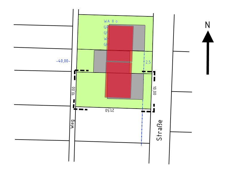

That much money just for parking spaces—seriously? The world is going downhill in style; what kind of public or private salaries are we talking about here? I don’t see it as only for parking spaces... I actually think that you could plan a genuine semi-detached house on 280m² (about 3,000 sq ft) of land. It wouldn’t even have to be larger than your current house, @goalkeeper, but it would definitely ease the whole situation around it. The plot would be far better usable than if you just added a strip of 3.5m (11.5 ft) width on one side—which, from today’s perspective, would have to be a wall next to the adjoining house with no windows, which wouldn’t even be necessary if there were no adjacent house at all...
I don’t understand either. How do you come to the conclusion that the house needs to be made bigger? Only the plot size is increasing.
Here it is – I hope it’s roughly clear (gray = previous, red = semi-detached house):
There are now enough parking spaces in front of the house. The house size remains exactly the same.
