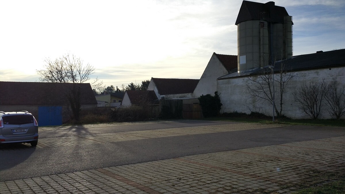

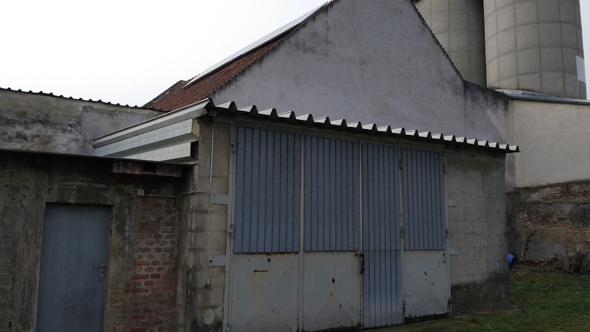

red: the plot of land, access via the pink driveway, the house is currently planned at the blue location. Existing building in yellow serves as garage and cellar replacement, with garden surrounding the plot.
On the western boundary of the plot is the neighbor’s existing building, consisting of tall agricultural storage halls.

In my opinion, having the terrace facing northwest is not suitable because of neighboring buildings.
The house should be placed here, with the gable shown on the overview plan as the house with the photovoltaic panels.
The rotated upper floor is partly due to the adjacent building, to achieve proper water drainage and aesthetics, while having as many windows as possible for light.
