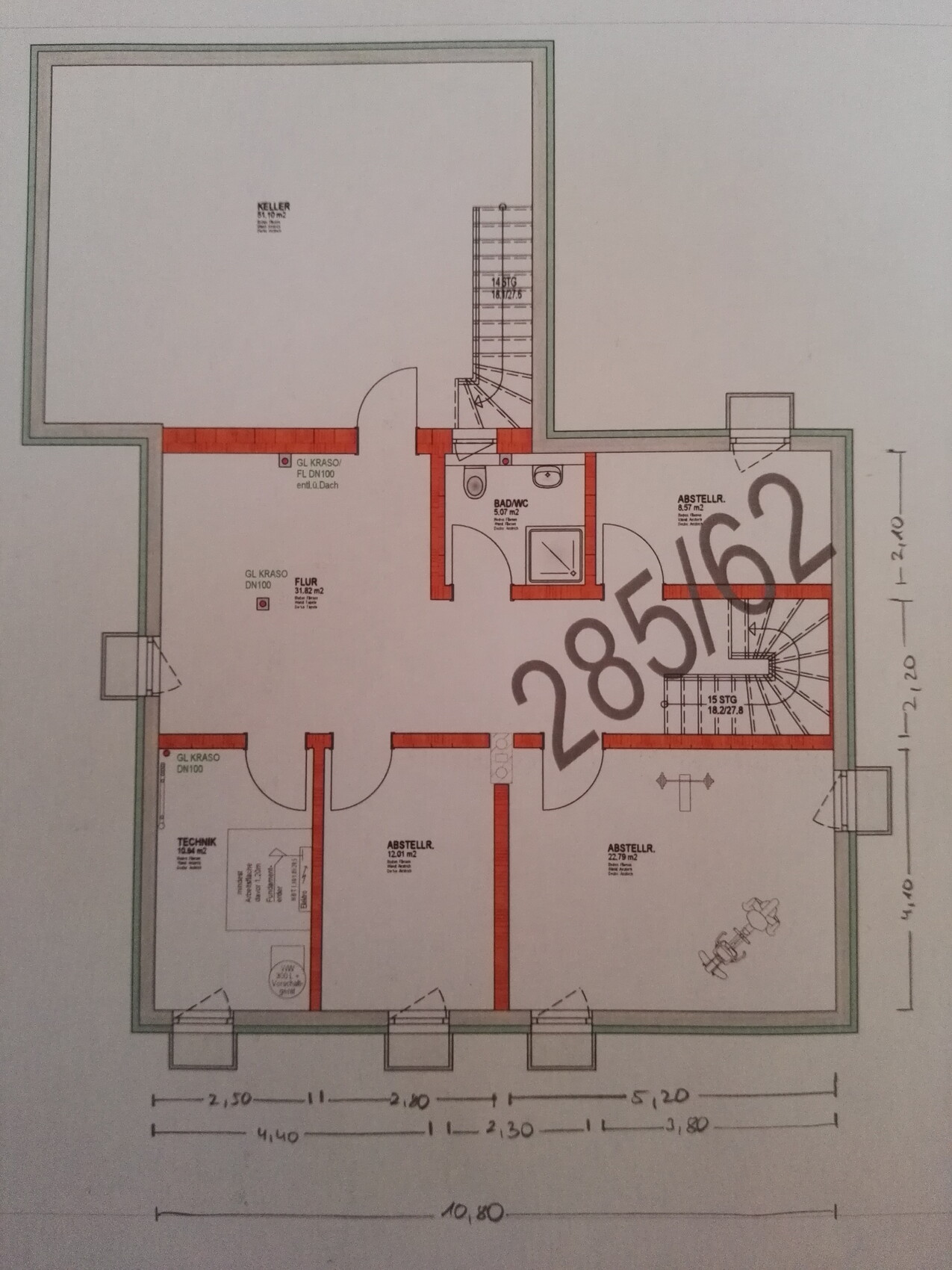

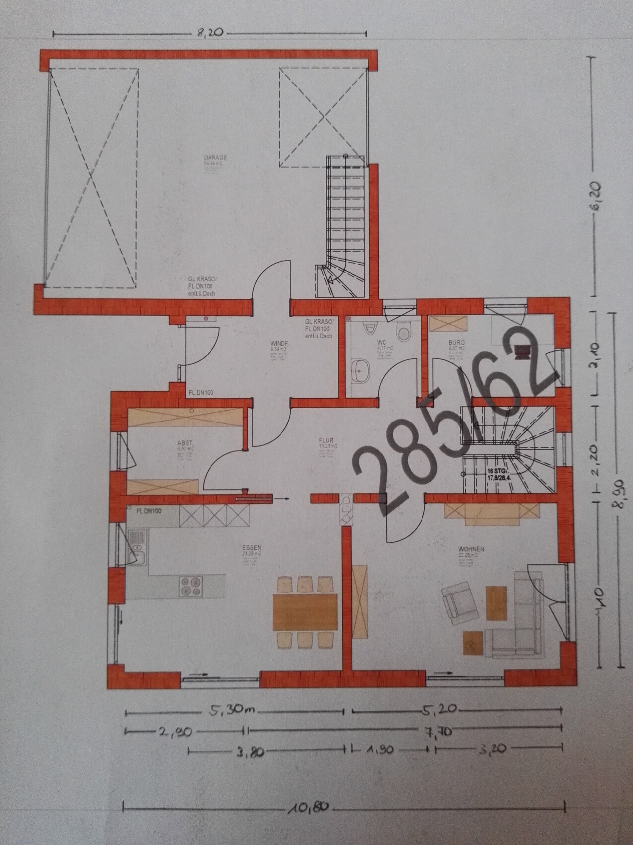

I have been a silent reader of this forum for some time now. Since we are currently planning our single-family home, I decided to register here. Attached is the first draft. We are quite satisfied with the initial room layout.
The only part I haven’t found a solution for yet is the staircase. I would like to have a staircase with a landing inside the house, but this is currently not possible due to the adjacent rooms.
What do you think in general about the room layout? Do you have any tips or ideas on how to design it differently or better?

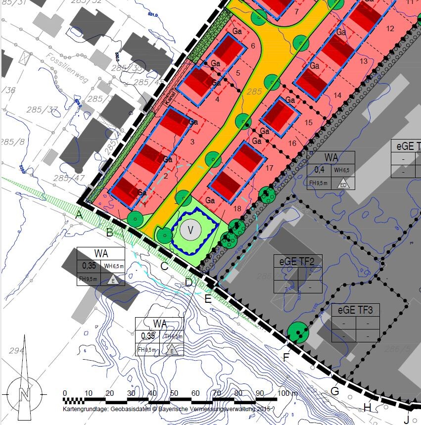

Here is the relevant information for you:
Plot size: 663 sqm (approx. 20 x 33 m (66 x 108 ft)) — Plot no. 13
Maximum building size: House: 12 x 10 m (39 x 33 ft), Garage: 7 x 9 m (23 x 30 ft)
Slope: no / flat
Site coverage ratio 0.35
Floor area ratio -
Building plot, building line and boundary: available (see attachment)
Edge development: yes (garage)
Roof type: gable roof
Architectural style: /
Orientation: specified in the development plan
Maximum height limits / restrictions: wall height 6.5 m (21 ft), ridge height 9.5 m (31 ft), garage ridge height 3 m (10 ft)
Distance from street to garage: 5 m (16 ft)

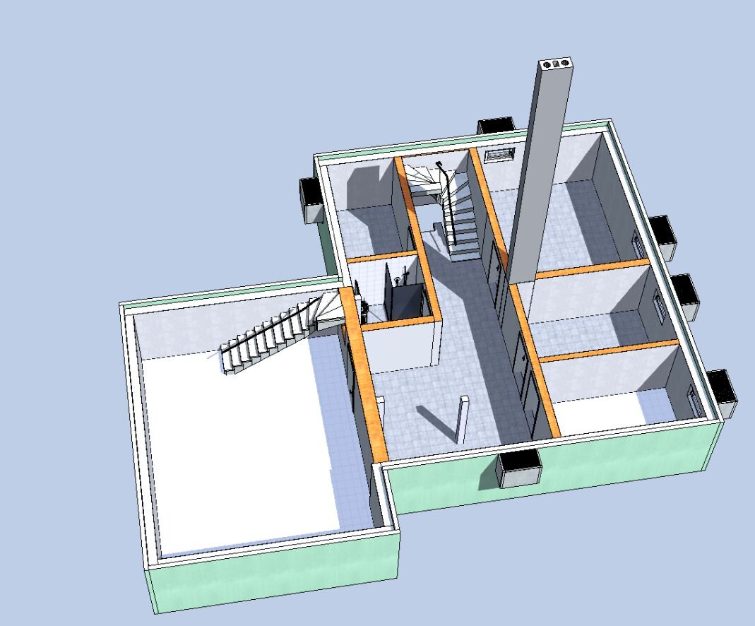

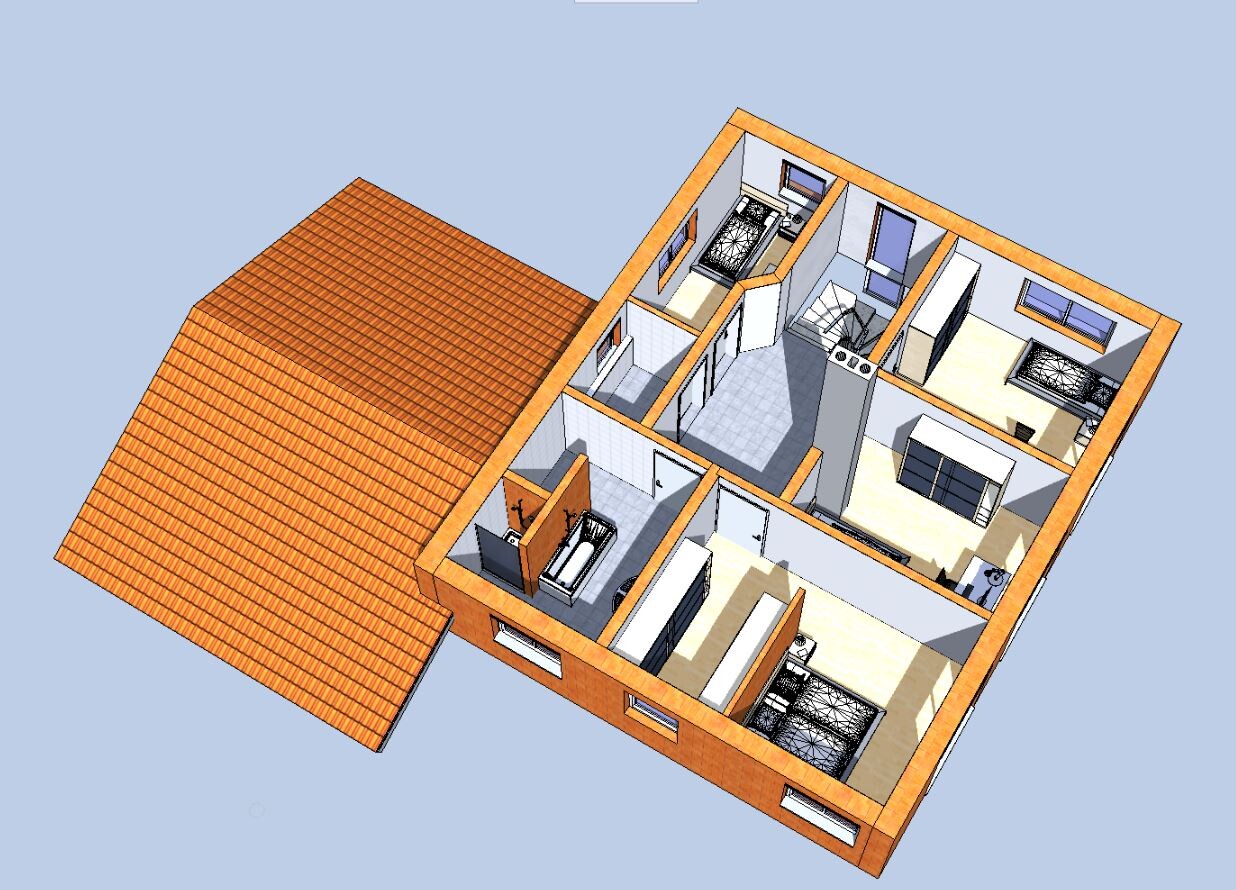

Yes, it’s hardly worth listing all the problems one by one. It simply needs to be started from scratch.
But for the skeptics here, just a few major issues:
- The huge basement resembles a nuclear bunker. What do you want to use it for? Are you moles?
- The staircase takes up the space where you would expect access to the terrace/garden.
- The kitchen/dining area is too small, while there are tons of storage rooms.
- The office and guest room are a joke – basically just additional storage rooms.
- The office isn’t needed at all – it was probably just a leftover corner.
- Two staircases to the basement – that’s one way to waste money.
- A toilet and small bathroom in the basement will almost certainly require a sewage lift – who wants that?
- The positioning of the house on the plot is still somewhat unclear. Where is the terrace supposed to be?
- And so on.

Shifty89 schrieb:
Now that's what I call a meaningful contribution... Where exactly is a constructive message hidden in your post?
Some basic ideas (which are included in the floor plans) can be useful. However, what is currently presented is not ideal.
The basement under the garage will cost you a lot of money: Why do you need such a huge basement? I also don’t see how you can manage all this with a budget of 450,000 euros. The layout and the content of the basement can only be discussed once you know exactly what you want on each floor.
Is there a "requirements list" for the rooms on each floor? If so, I would start there (including room sizes). Only when this list is available can you work on the floor plan. Otherwise, it remains a makeshift solution that may not be very effective. It is also not clear why there is no bathroom with a shower on the ground floor (instead of one in the basement). I assume we don’t have all the information that led to this floor plan.
The third children's bedroom on the upper floor is really too small to be considered a proper bedroom. A lot of space is lost to corridors on the ground floor.
The size of the kitchen/dining/living area is very tight considering the space taken up by hallways. Try marking out the same size in your current home: you will immediately see if it really meets your needs.
Is the driveway to the garage from the northwest? A north arrow on the floor plan would be helpful.
Conclusion: Set the floor plans aside for now and start fresh with your room requirements for each floor. Possibly incorporate one or two ideas from the existing floor plans when redesigning.
