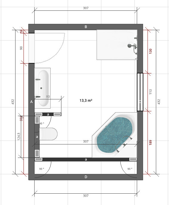

we need help with bathroom planning. We have already had three appointments but are still not satisfied with the layout. Do you have any ideas?
It is important to us to have enough space near the sink for additional cabinets.
We like the first version quite well, but the toilet is located right next to the door. We don’t find that very suitable.
Badezimmer-Grundriss: Dusche links, Badewanne rechts, Toilette und Waschbecken mittig
Grundriss eines Badezimmers: Badewanne rechts, Toilette unten links, Waschbecken oben rechts.

We actually have that exact layout as one of our options. However, we do not want a glass shower but rather built-up walls. The question then was whether the wall would be intrusive when you enter directly.

We actually have that option as well. However, we prefer a shower with brick walls instead of glass. So the question was whether the wall would be in the way if you walk in directly.
I don’t think that’s too much of an issue. For example, you could install nice wooden shelves on the wall, which would look quite inviting. I find the size more problematic. 1.20m (4 feet) like @hanghaus2023 is not enough to go without a door. But it would be an advantage for the room if the shower isn’t too dominant. Due to the sloping ceilings, the space can quickly feel quite crowded.

I wouldn’t find it that bad. For example, you can attach nice wooden shelves there, which makes it look quite inviting. I actually find the size more problematic. 1.20m (4 feet) like with @hanghaus2023 isn’t enough to do without a door. But it would be an advantage for the room if the shower isn’t too dominant. The sloped ceilings make the space feel quite crowded quickly.
Yes, the roof is already on. The shower would have to be at least 1.40m (4 feet 7 inches) to do without a screen. That would already be quite a bulky structure. Somehow, we just can’t find an optimal solution.

We actually have that exact option as well. However, we don’t want a glass shower, but rather masonry walls. The question was whether the wall would be obstructive when entering directly.
Why didn’t you mention from the beginning that a glass shower was not an option?
The wall is just as much in the way as the glass panel. The difference is that the wall doesn’t let any light through and looks more like an intrusive element.
