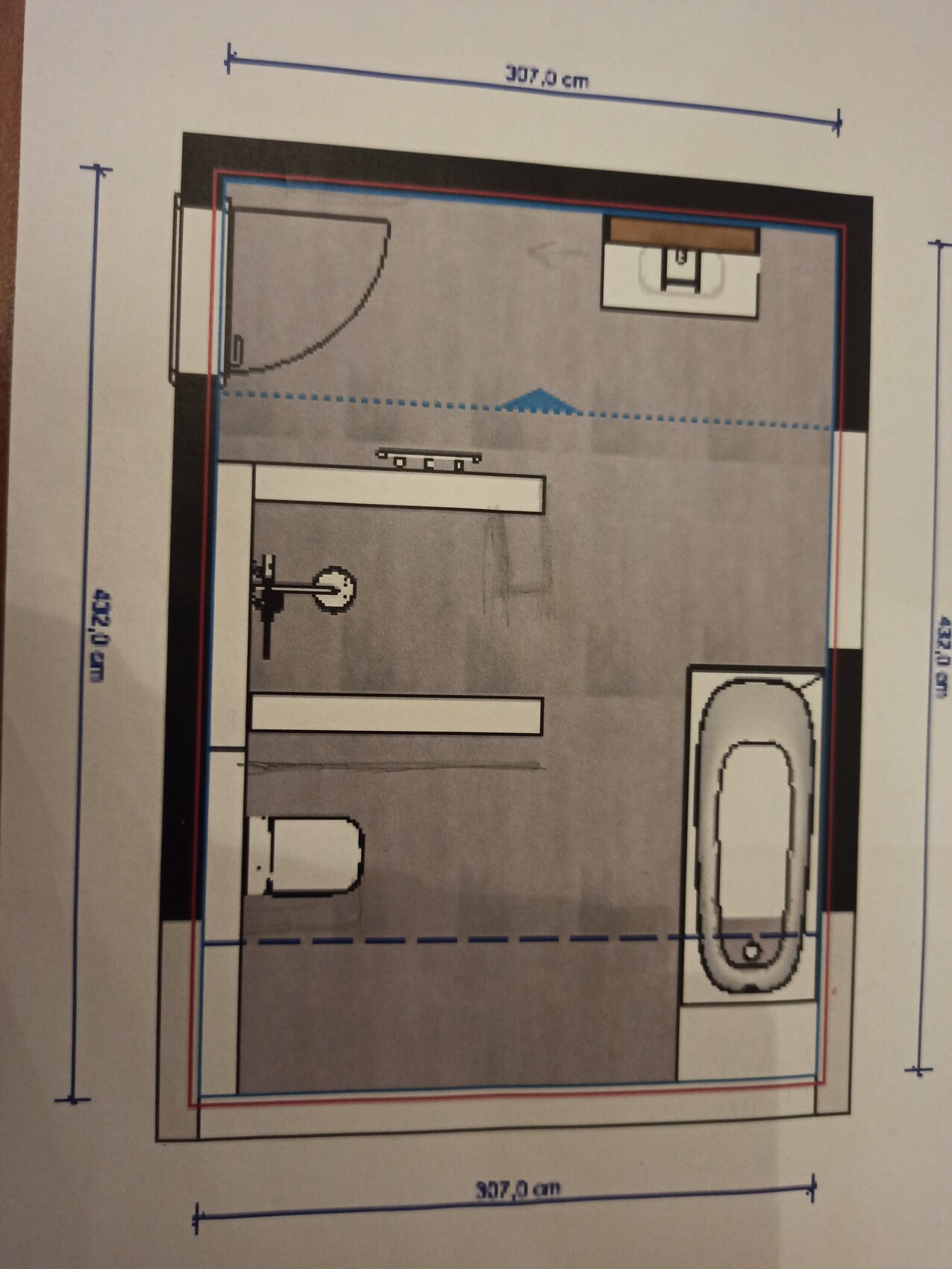

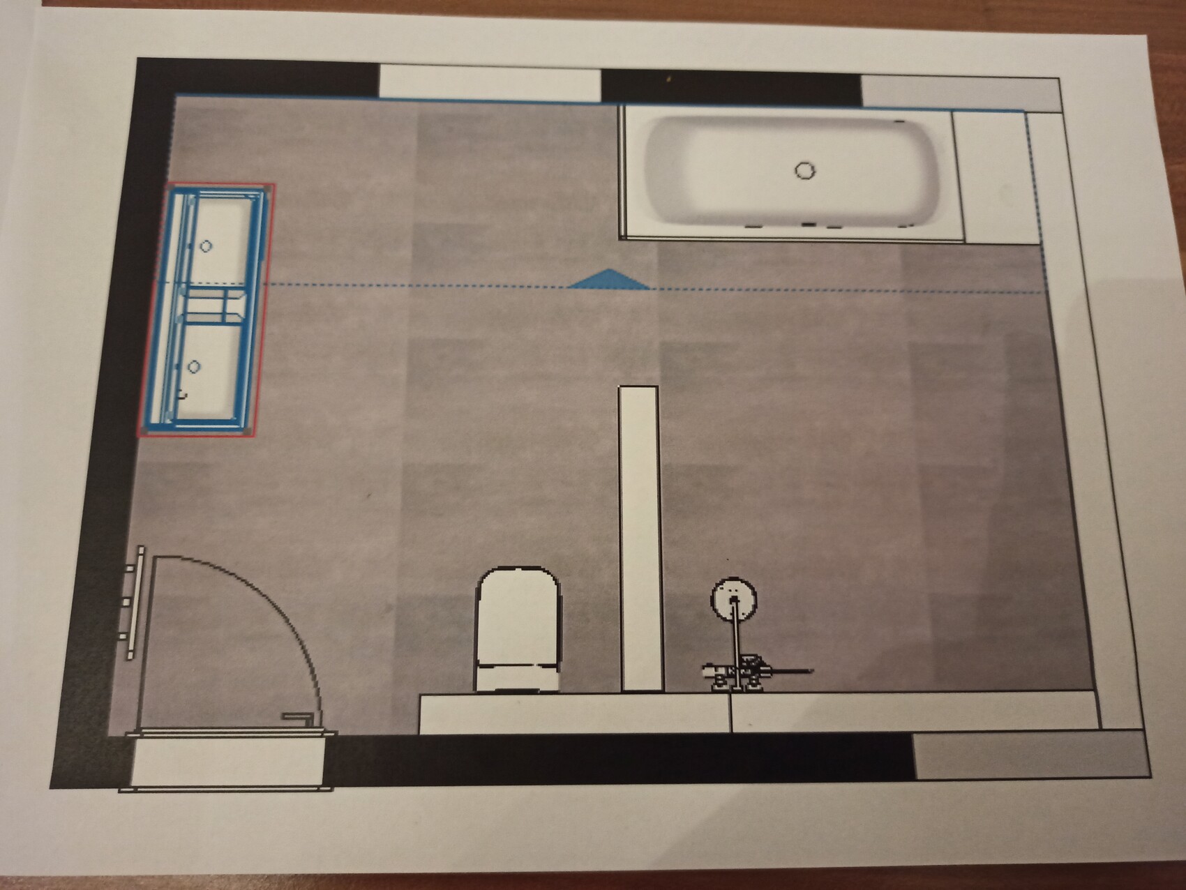

we need help with bathroom planning. We have already had three appointments but are still not satisfied with the layout. Do you have any ideas?
It is important to us to have enough space near the sink for additional cabinets.
We like the first version quite well, but the toilet is located right next to the door. We don’t find that very suitable.

Jurassic1352 Mar 2023 19:58Is it still possible to move the door further to the right? Then I would place the shower where the door is now, the toilet under the window above (where the washbasin currently is). The washbasin would then be positioned to the right of the door.

Jurassic1352 Mar 2023 20:10Ah, okay. There are some very talented people here, so maybe others will have some ideas as well. 🙂
Otherwise, I would prefer the second option, since the toilet is not directly next to the door (which feels a bit stressful to me) and there is more space for the towel radiator.

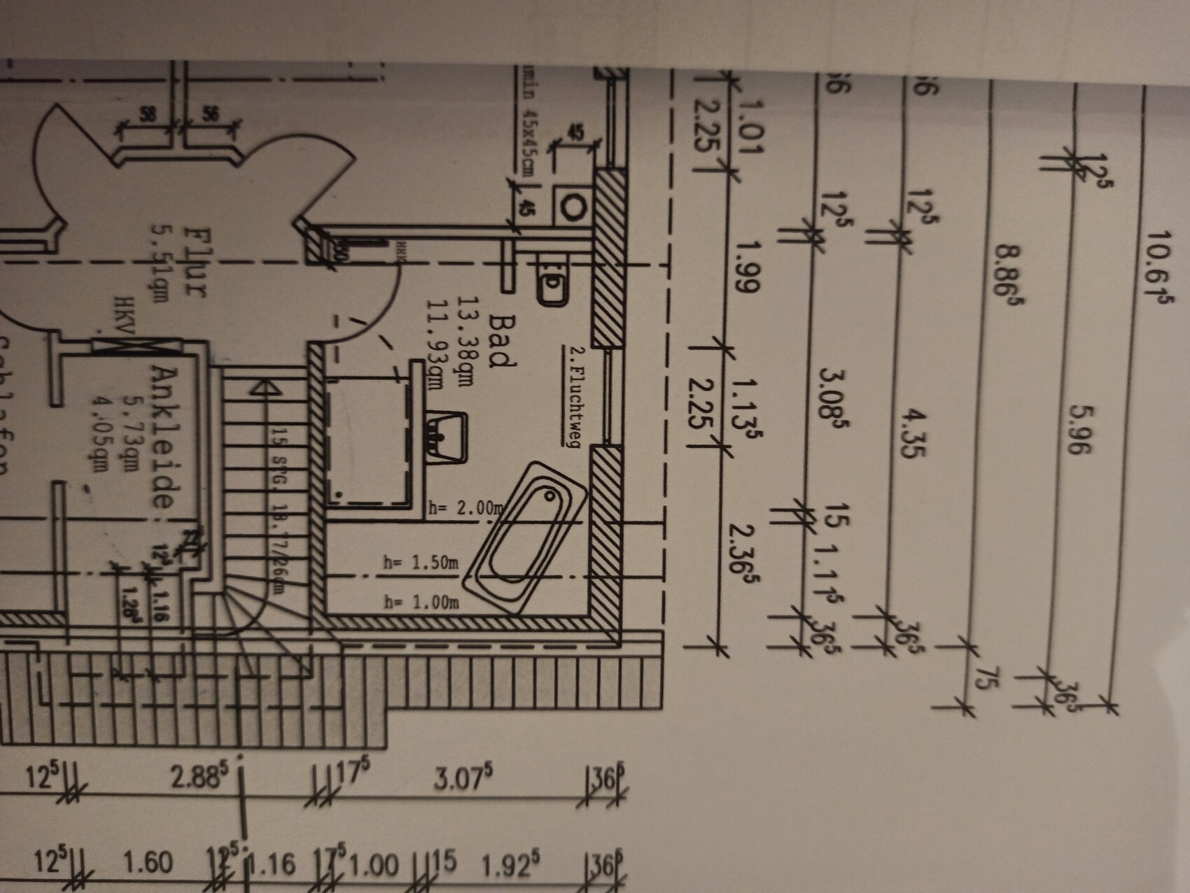

hanghaus20232 Mar 2023 20:52I don’t like either of them.
Are there more measurements available? Is there a sloped roof? Roof pitch? Knee wall? Windows: dimensions, position, sill height?
Are there more measurements available? Is there a roof slope? Roof pitch? Knee wall height? Windows: dimensions, position, sill height?Attached is a floor plan. There is a roof slope on the right side. Knee wall height is 1m (3.3 ft).
