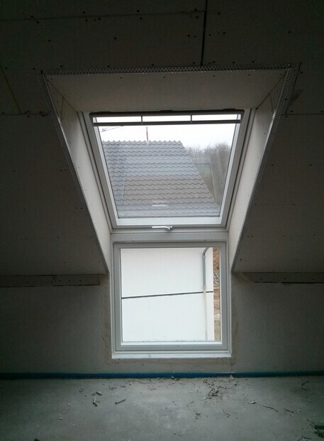

According to the building plan, our house will have the eaves side facing the large, hopefully beautiful garden eventually. The bedroom and one child’s room will be located under this roof side. To be able to look outside and enjoy the neighboring lands, I would like to install floor-to-ceiling roof windows. The eaves side is oriented roughly 30° northeast.
Something like this, with casement windows beneath that would allow a slight balcony-like feeling when standing (but it should not be a “real” balcony window):
[IMG width="407px"]https://velcdn.azureedge.net/-/media/marketing/de/produkte/dachfenster/lichtlosesungen-fensterkombinationen/Velux-lichtband-wohnzimmer-750x563.jpg?as=true&h=563&w=750&la=de-DE&hash=10C498D052079AAAAA17BD5304DFD515[/IMG]
Velux calls this a “light strip” and apparently has invested heavily in search engine optimization, so you would think it only exists from Velux. Alternatively, I found something similar from Fakro.
Are there other reliable manufacturers that offer something like this? Essentially, isn’t this “just” a standard roof window with a fixed glazing section below?
From a construction point of view, can it be considered like a normal roof window, or are there potential problem areas or structural pitfalls to watch out for? Of course, this will also need a roller shutter, as my wife wakes up immediately at the first ray of sunlight.

Araknis schrieb:
Is this basically constructed like a standard roof window, or does it come with any potential issues or structural challenges? You can do it as shown. Bending it, that is, recessing it into a knee wall, is better avoided (this is coming from a former window manufacturer). There are reasons for that; back in my youth, it was just a fashionable one-off trend.
KarstenausNRW28 Sep 2023 14:26KarstenausNRW schrieb:
