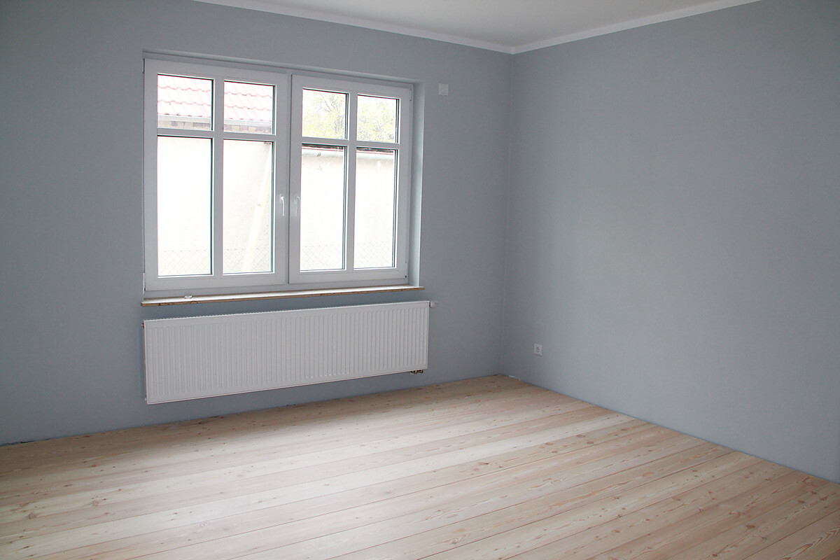

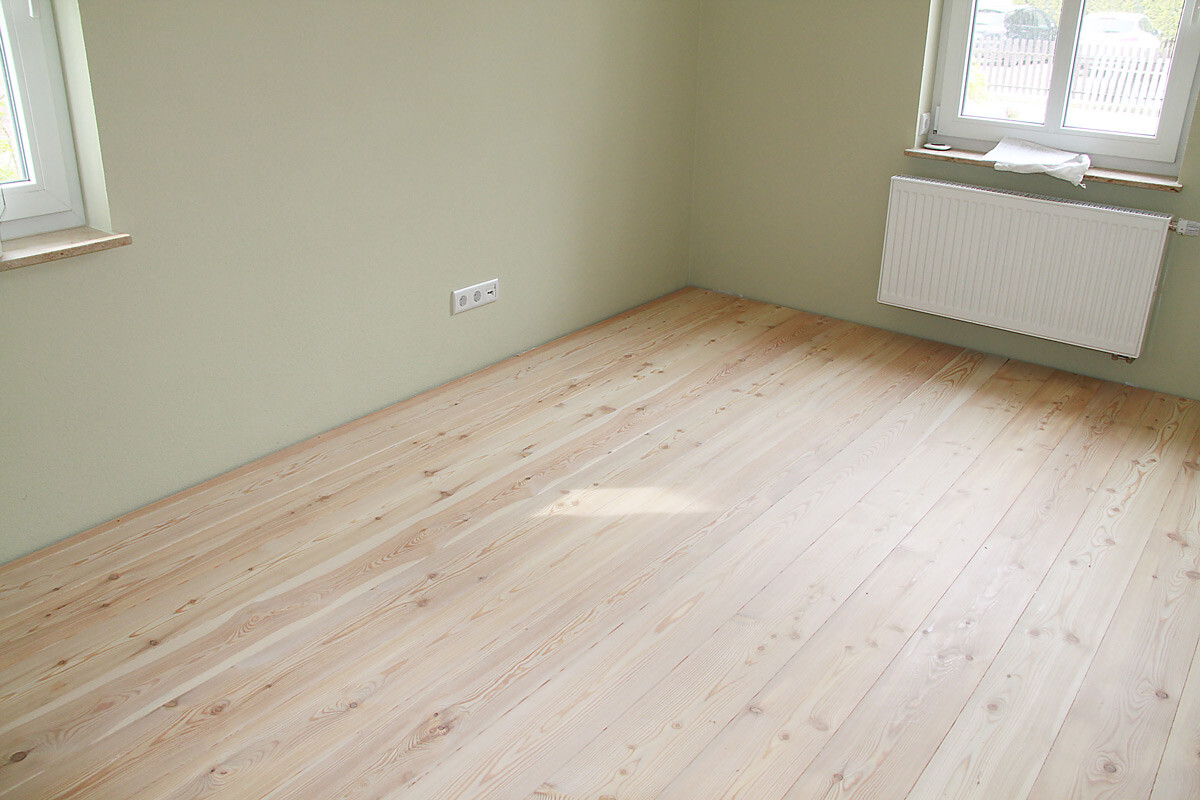

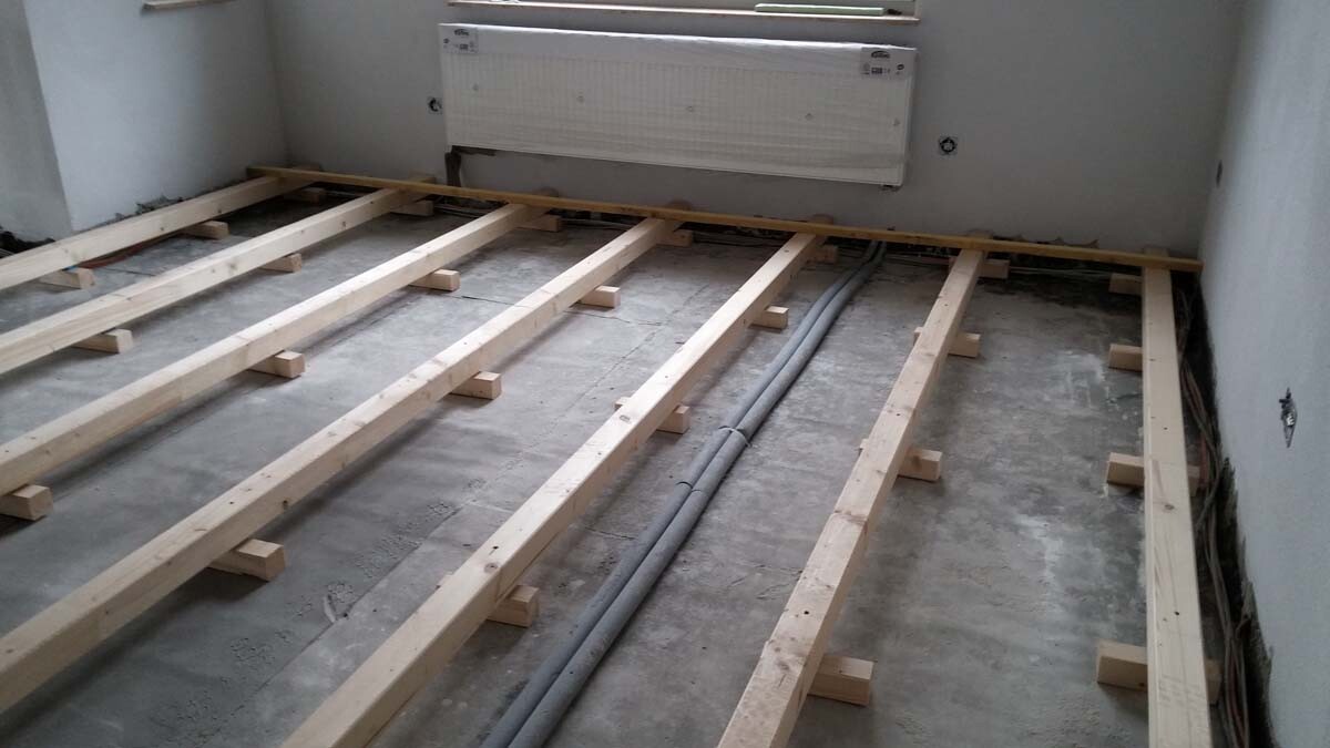

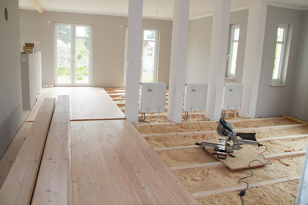

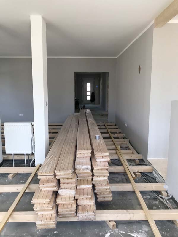

this time with underfloor heating and therefore installed directly on the screed.We have solid wood floorboards in the living areas. Since we didn’t want to glue them down, we ultimately decided against underfloor heating and chose radiators instead... The screed was omitted... Instead, joists were installed, onto which the floorboards were screwed. Regards.
F
fach1werk20 Sep 2020 21:05That looks really great!
pagoni202020 Sep 2020 21:12Ah yes... that’s exactly how we had it in our old house, but we had a cork underlayment in between. Even after 30 years, we still have the same flooring with no issues and great comfort.
