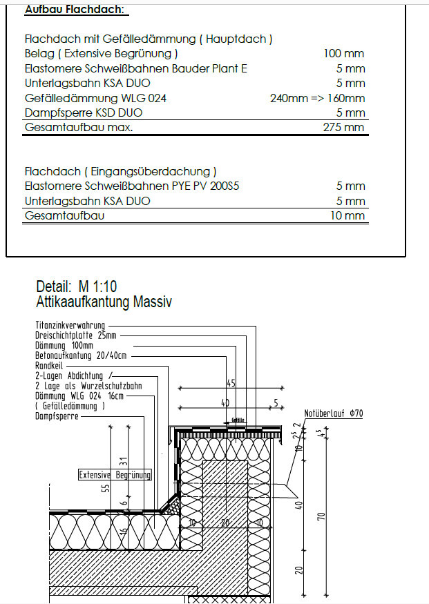

my flat roof is designed as follows. Is this setup reasonable and up to current technical standards?
I never really wanted a flat roof, but technically it’s hardly avoidable, so at least it should last as long as possible.
Technical drawing of a flat roof construction with insulation and vapor barrier.
Alex85
19 Oct 2018 06:36
Yes, that’s how you do it.
