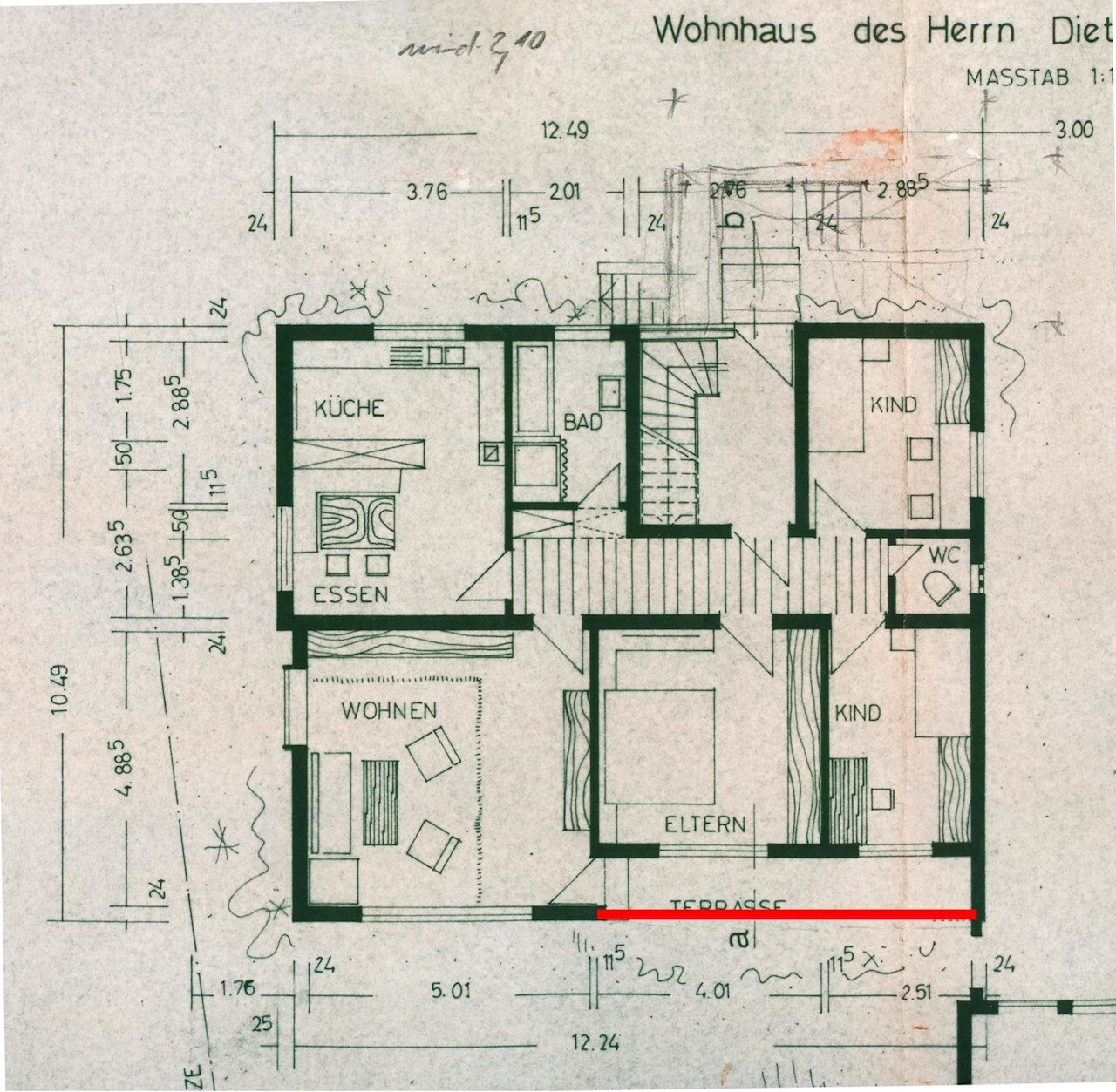

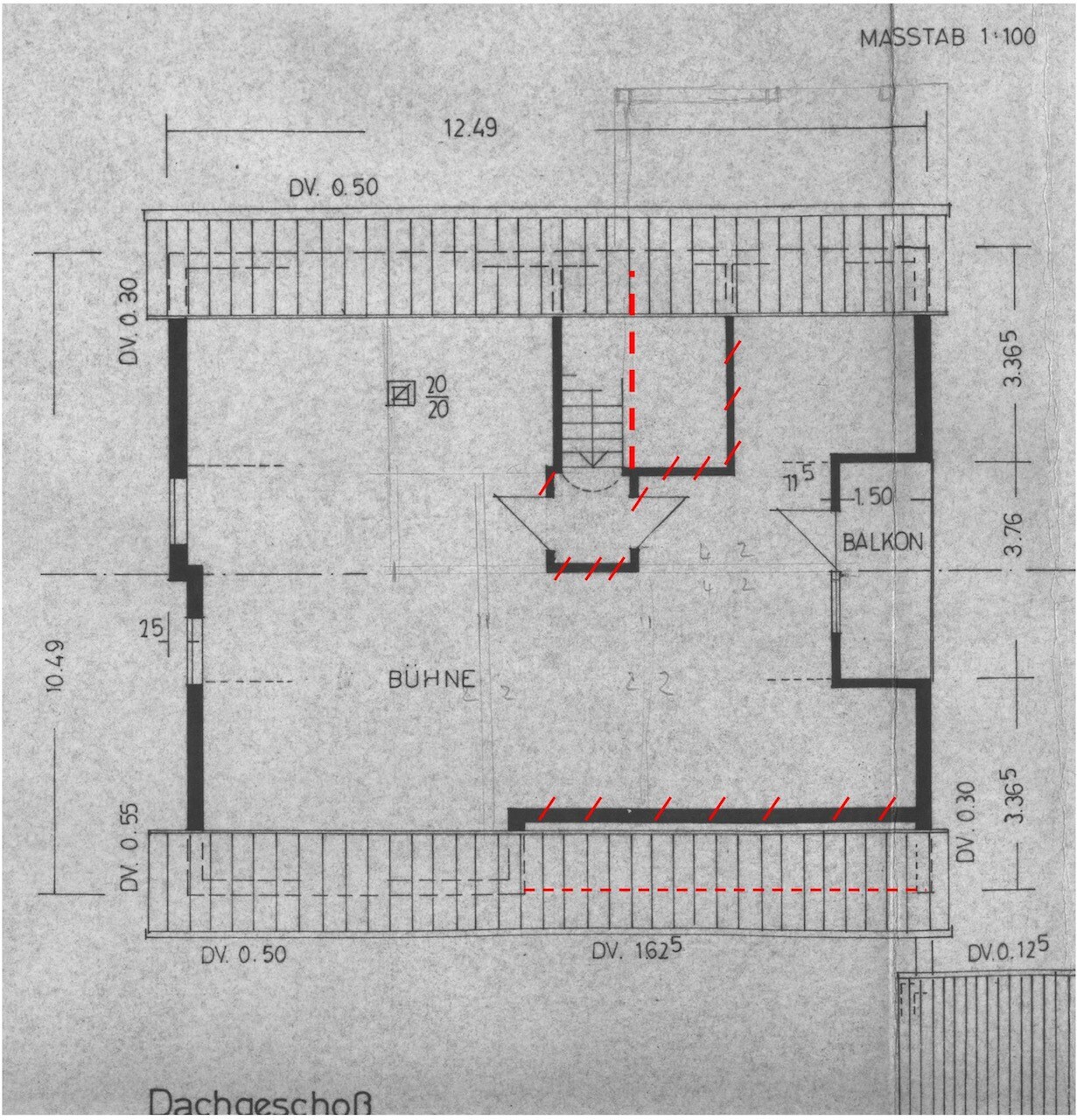

Currently, we live on the first floor of my parents’ house, with our own bathroom, kitchen, etc. However, the sloped ceilings waste a lot of space. As shown in the drawings, there is also a partition wall about 1 meter (3 feet) from the knee wall, creating a storage room that is used for "stuff," but it could be used better if the sloped ceiling wasn’t there. Because of this, the kitchen is very small—just a narrow worktop—but it works, though it’s not ideal. Above the apartment there is an attic where you can only walk in a bent-over position.
All previous options we considered, such as buying an apartment, did not work out, so we are now thinking about adding an additional floor on the parents’ house. The goal is to have a full first floor without sloped ceilings by raising the knee wall accordingly, and to create two small additional rooms in the remaining attic space of the new roof. Access to the upper level could be via a gallery.

I am new here and would like to briefly introduce myself. My name is Bastian, 32 years old, from Baden-Württemberg. Skilled with hands-on work, with lots of experience in the automotive field (self-praise aside). I have also done a lot of renovation work myself so far—screwing, hammering, sawing—except for electrical (high voltage) and gas/water installations, where it’s better to call in a professional. However, the new project exceeds my skills, which is why I found this forum online and am asking for help 🙂
Now, a bit about the situation and the plan:
