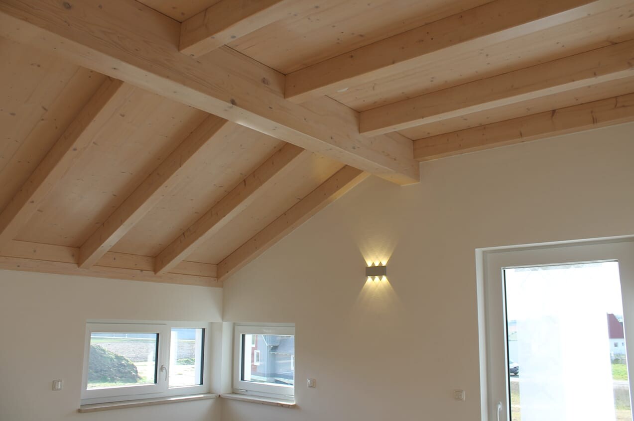

That's a lie anyway, if a roof looks undamped from below after more than forty years. What exactly do you mean by that? 3-layer panels are not OSB boards and, on the contrary, look really beautiful ... 1000 times nicer than the usual boards you typically see in exposed roof structures
Snowy36 schrieb:
Here is an example Exactly – this ignores the fact that roof slopes nowadays are insulated just like the vertical exterior walls: it looks like back when insulation wasn’t used yet.
