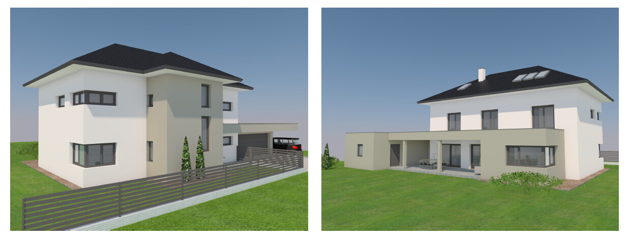

To the matter at hand: Of course, we are laypeople in this field, but the plan did not come from us. The attic idea arose because we don’t necessarily “need” a basement, but would still like storage space and an additional room. And yes, it was probably naive to expect cost savings with the attic variant.
Here is an exterior visualization; please feel free to share your professional assessment:

Here is an exterior visualization; feel free to add your expert opinion: Good, at least the factual approach has now helped reduce the withheld 90% of the planning to 87%. So I’ll gladly check back the day after tomorrow to see if the groundwork is already complete by then. After all, we should at least make use of the fact that this is not a comedy forum ;-)
By the way, the naivety is not in choosing an attic instead of a basement, but in first selecting the most expensive roof shape (and then refining it to the absolute most expensive of all—top-level comedy, certainly not part-time). My mother also always prefers the ladies’ menu ;-)
I have mentioned this a few times already and am happy to repeat it for newcomers here.
I have a hip roof and I regret it. Visually, I actually prefer it over a supposedly old-fashioned gable roof, but it’s expensive (for me about 3,000 EUR, possibly even more nowadays), impractical (storage space), offers less area for photovoltaic panels (the small trapezoids or triangles on the hip sections are really inconvenient for solar modules), and the nice look is usually not even visible from the inside.
By the way, gable roofs can also look modern and stylish by playing with roofing materials, roof overhang, and pitch.
When I started planning, I was still tempted by catalog images and the relatively small direct price advantage made me dismiss the gable roof in my mind.
At the time, I simply couldn’t foresee the indirect costs of less storage space, fewer solar panels, and poorer attic ventilation options (no gable end for windows).
Well, I’ll be wiser for the next house.

… The roof casts a lot of shadow. In my opinion, the eaves are too large.That is true, but it is intentional to allow for more height in the attic conversion while reducing the bulkiness. The design without the attic conversion has less overhang and is flatter.
